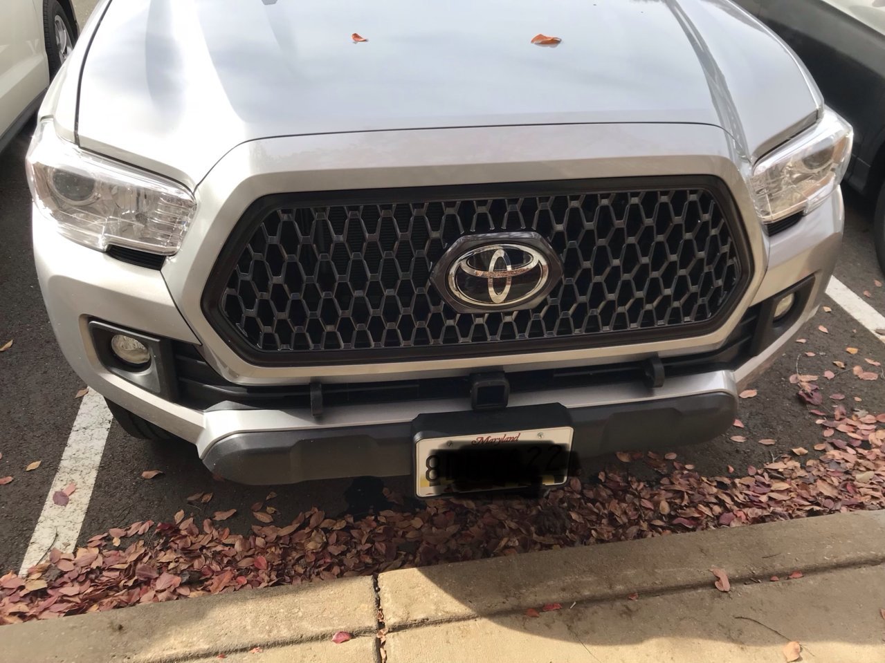

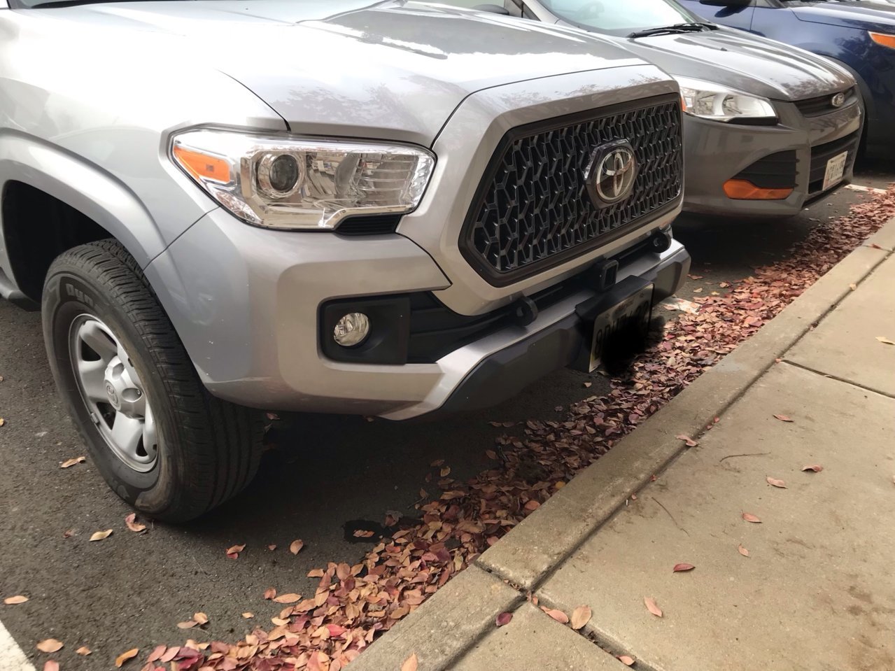

    Installed my mobtown front recovery bar last weekend. Exactly what I wanted.

    I just used what was on the site. They were pretty good. One thing to note you’ll have to trim/notch the bottom of the grill for best fitment.

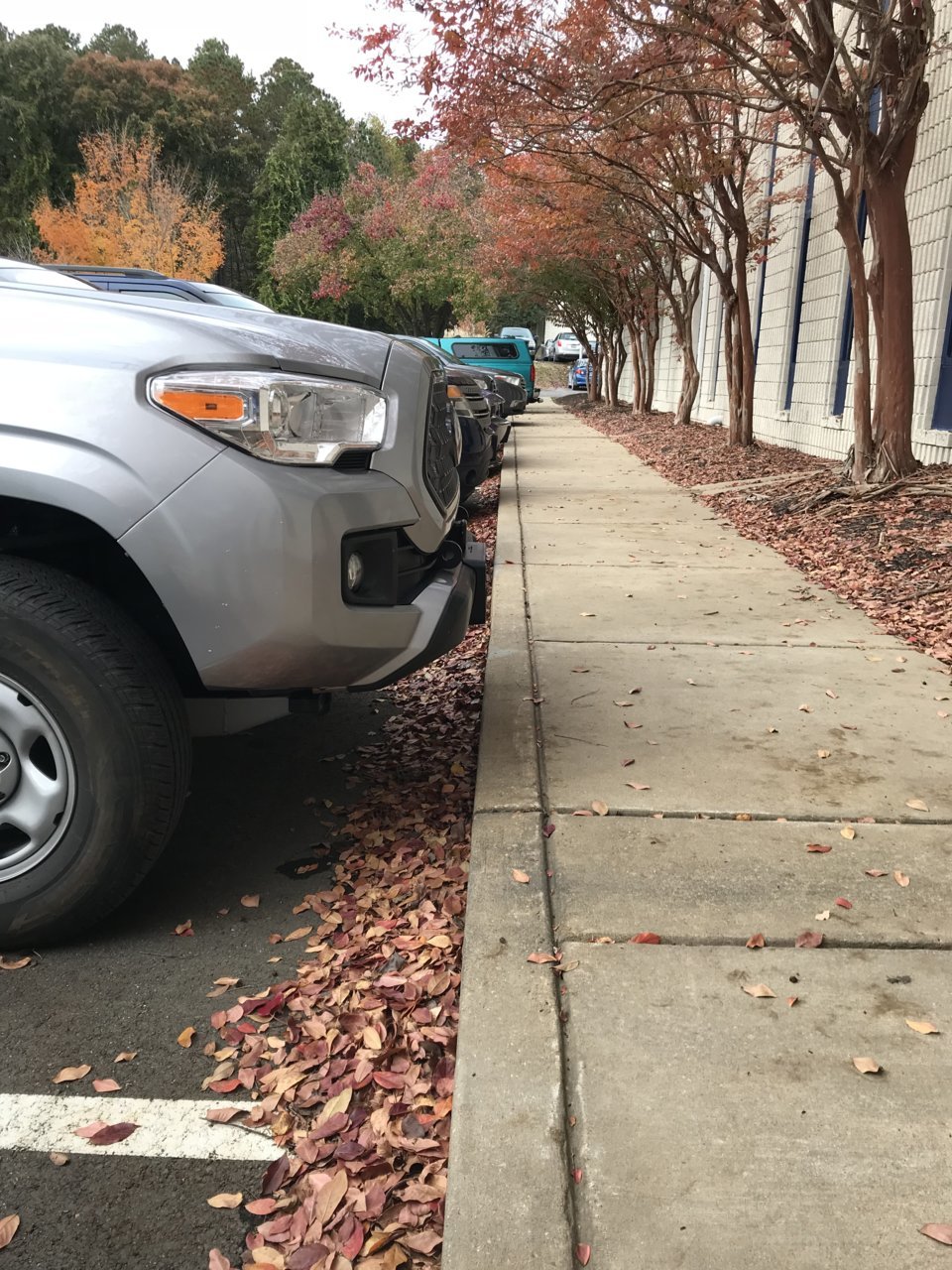

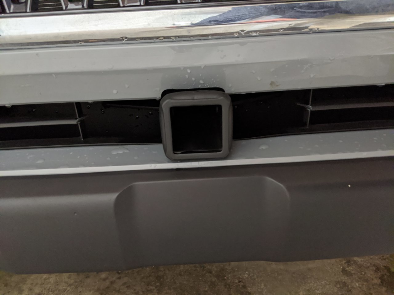

    Just adding some pics to an old post. Added the hitch yesterday. Came out great. Hardest part was getting the fender flares off before removing the bumper as I ended up breaking one of the clips. Do yourself a favor and reach behind the inner fender and release the clips while pushing them through. It would have saved me 30 minutes of superglue and trying to re-form the plastic pieces on the fender flare. Other than that, slowly sanding the bumper plastic and grill take time, but isn't that hard with a Dremmel and small sanding drum. Good luck.
