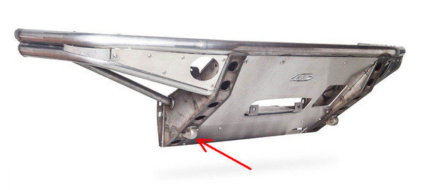

    All-Pro gets away with it because the Baja bumper's shackle mounts are very low:
    In fact, I don't recall any other vendor putting shackle mounts as high as the MobTown hitch bar, probably because there's nothing beefy on the frame that high.

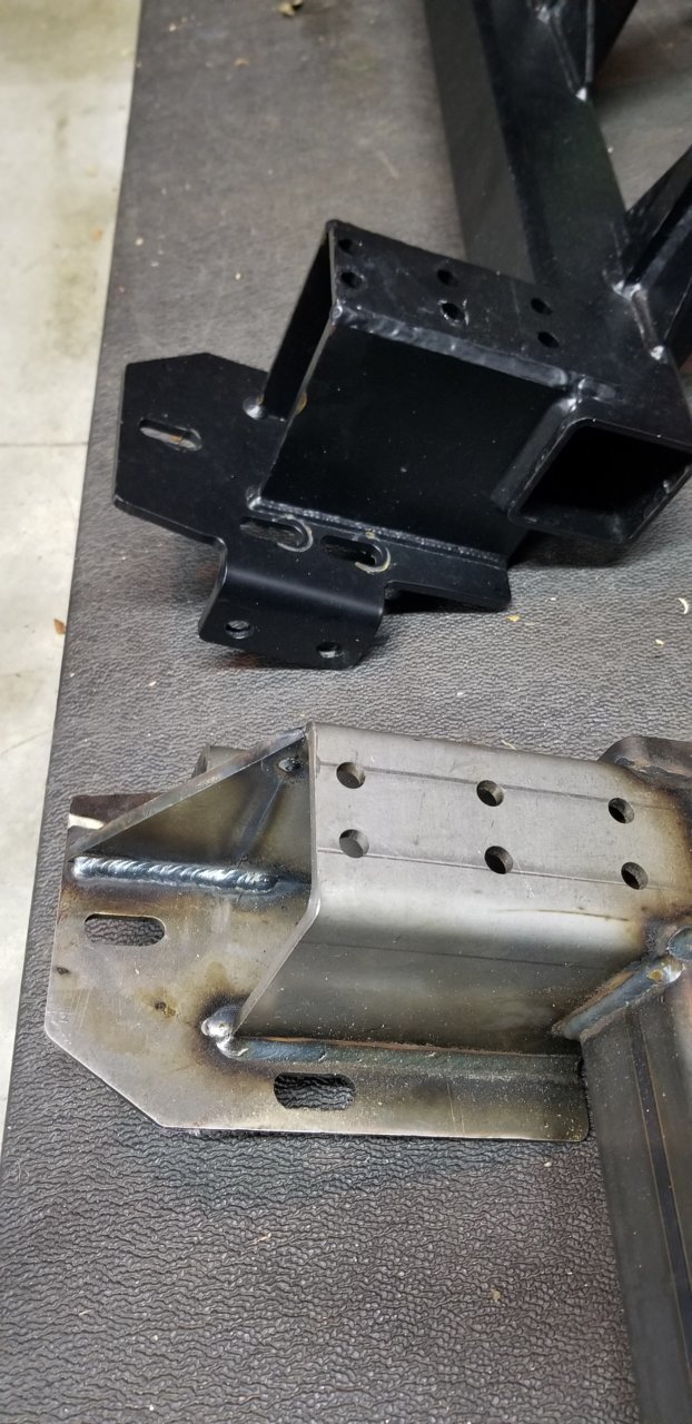

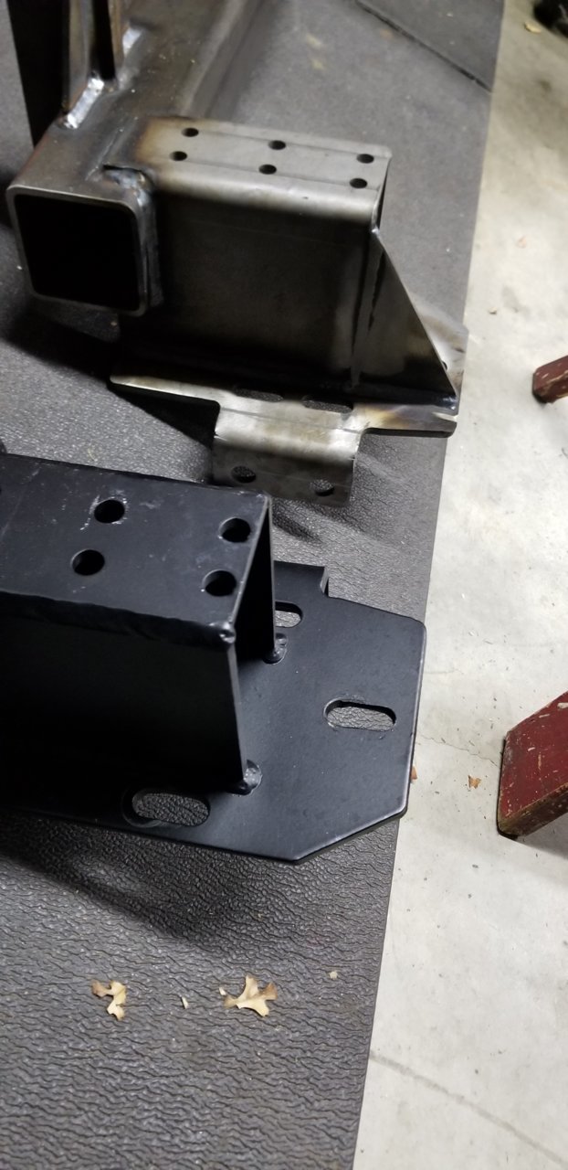

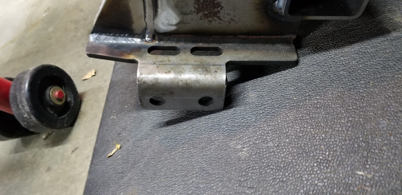

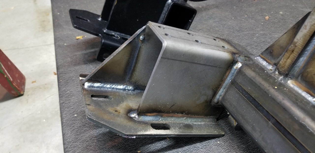

    Ok guys. Here is the new updated item. There are 2 major changes. Both for the better and help address the geometry challenges in this design.
    As you can see below the most obvious change is the addition of the gusset reinforcement at the bumper mounting location where mine bent. This is good.
    The second change is that they now use a single channel piece for the 2 standoffs vs the 3 welded plates on the old design.
    Before powdercoating I'm going to internally gusset the side 90 degree bends (for the frame ties) as this was another failure point that wasn't addressed here. I'll also likely copy the added gusset and add 1 more on each side for added strength.
    I would've liked to have seen them simply extend the channel peice all the way down the the bottom of the bracket but it is what it is.
    These changes in addition to the weld on SOS bumper mounting plates should be sufficiently stronger. I truly commend Mobtown for both listening and speedily addressing a design issue and I'll continue to use thier products on my various vehicles.
