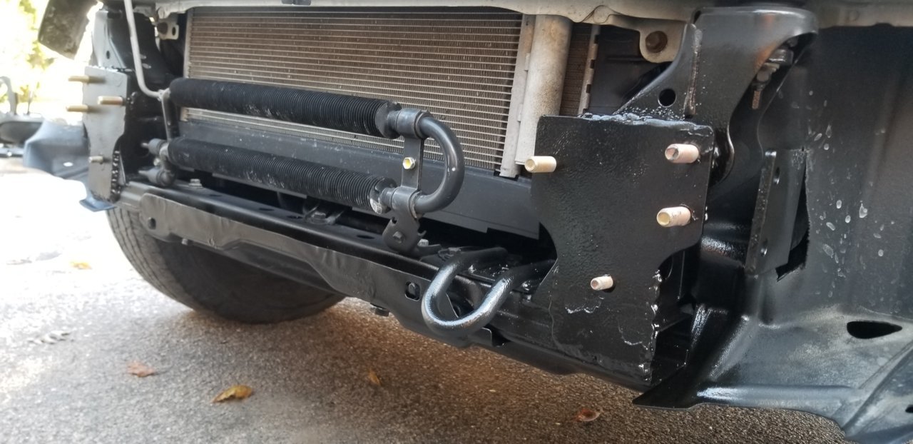

    Mine arrived dead on perfect for alignment and nice hardware. Thankfully given the nature of this setup being behind the bumper the only thing the plate thickness will affect is that the hitch and d ring points will poke just a bit more through the grill (which is fine with me). Welding them in and painting tomorrow and the new modded bar comes back from powder tomorrow as well.

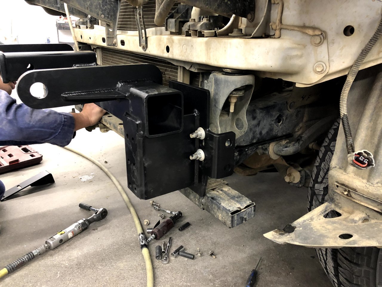

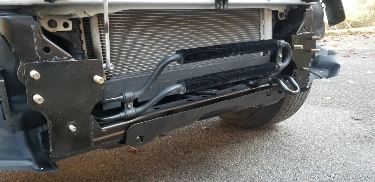

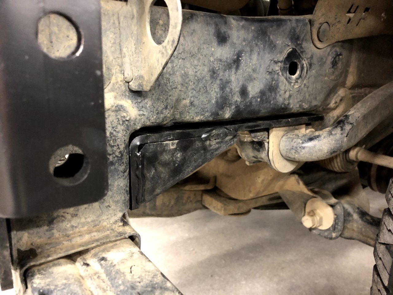

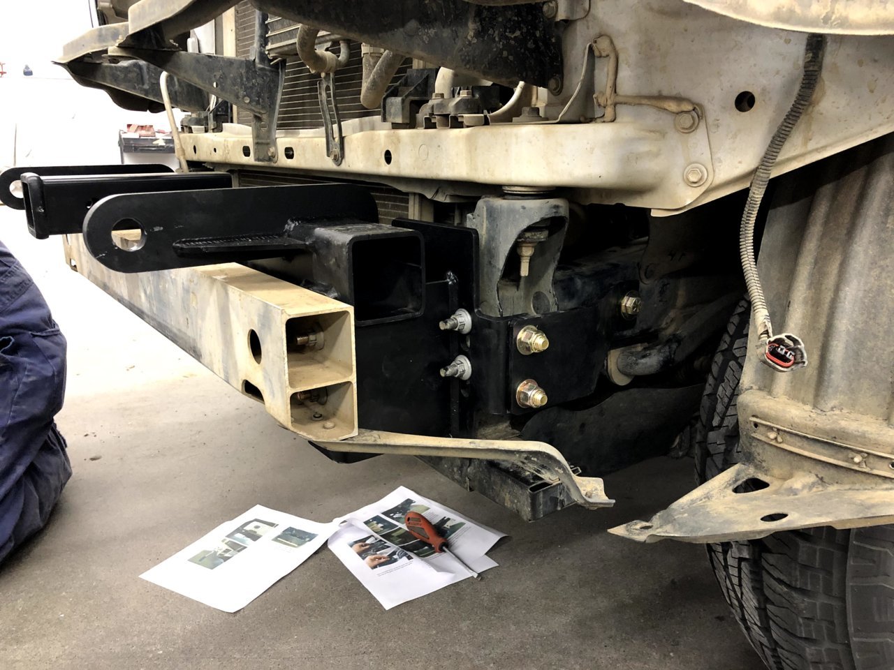

    Just wanted to chime in as I just installed mine yesterday. I ordered Mobtown's front recovery bar on 9/2 (Labor Day Sale) and it shipped on 10/13. A second unidentified box that turned out to be additional parts and hardware shipped exactly a week after. If you ordered in this timeframe, it looks as if Mobtown has updated the design a bit to accommodate the issues OP originally had. See pictures below:
    Here you can see that they extended the steel channel all the way down to the bottom of the plate now. That channel only went down to about the level of the lower front bolt on OPs. This extension replaces the gusset piece you see in OPs replacement recovery bar. This seems like the more production version of what OPs posted fix from Mobtown was.
    Anyways, the installation was a breeze and the new modifications to the design seem sturdy enough to me but I'm no engineer.
    This is one additional support bracket that ties into the bushing mount location.
    Then on top of that another metal strap tying it back to the frame. This strap and bracket are not mentioned in the 2nd gen installation directions but are included. Refer to the 3rd gen directions to install those parts.
    Finished install.

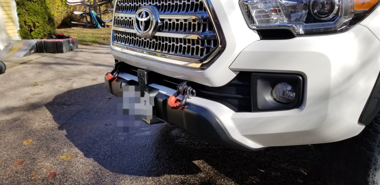

    Yours is for the second Gen truck. There never was a problem with those. The issue is with the 3rd Gen as the whole bar is simply moved 2" higher. This is/was the problem. All of those support parts you got have been part of both 2nd and 3rd gen kits for over a year and were on mine when it bent.
    Regardless I finally welded and painted my new SOS bumper mount plates this weekend along with the updated bar. Those plates are so solid. They went on easily, lined up perfectly, welded in well and only needed the lower frame bolt drilled out to accommodate it. I slathered the whole area with primer and a rubberized undercoat. In my opinion these plates are cheap insurance for this design and should be used on all installs (even traditional bumpers) . 20201107_132012.jpg

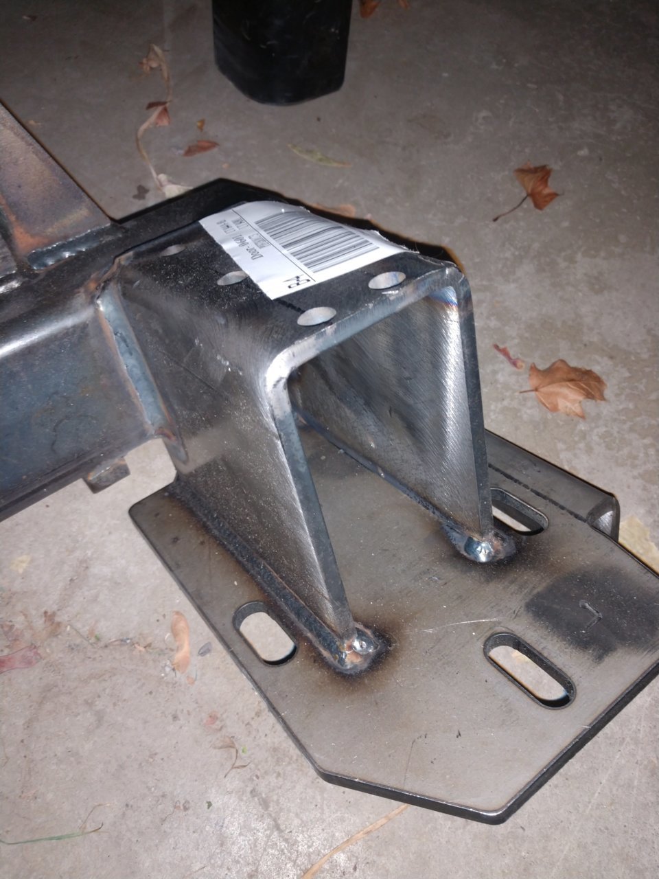

    So I just received my hitch 12/22/20, ordered 9/7/20. It came without the gusset that OP had received in the update. Extremely unsatisfied in Mobtown. 4 month wait and it's not even updated when they know there is an issue. IMG_20201222_184900358.jpg IMG_20201222_184919215.jpg

    Sure looks like the old design (no lower gussets and the use of plate steel instead of channel for the stand offs). Here is a pic of the updated one shipped to me back on Oct 19th. I initially inquired about the issue to Mobtown on Sept. 12th. They acknowledged a design change was needed around the 16th, agreed to replaced it with an updated design around the 22nd and shipped it on Oct. 19th.
    Luckily yours is not painted or powdered yet so you can strengthen it up a lot by welding in 4 gussets under the channel yourself. A fab shop shouldn't charge too much for that if you dont have the ability to do it yourself.
