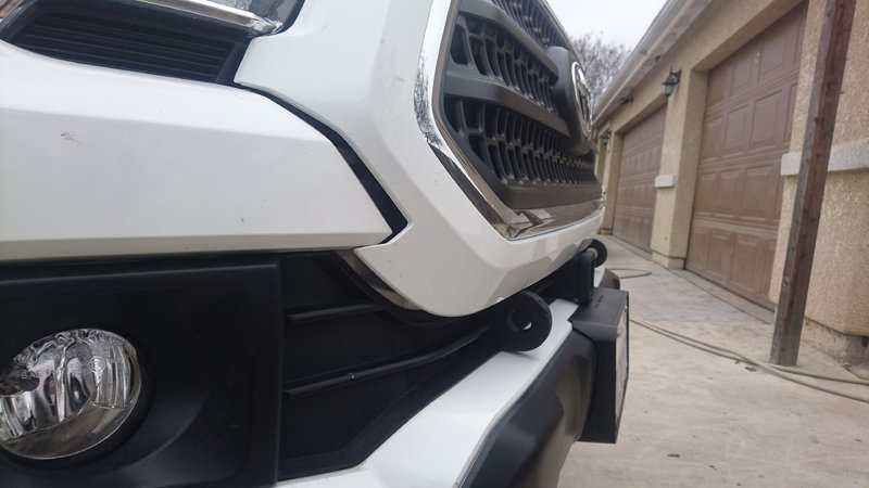

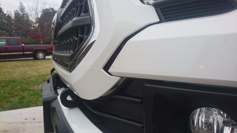

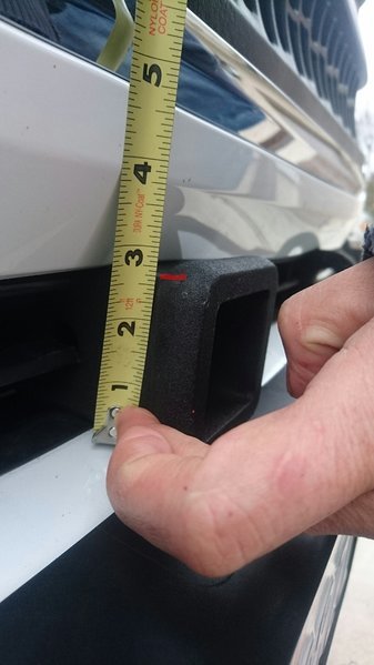

    I install the bar a few days ago and decided to hold off posting anything still i forgotten the regret i felt after doing it. tmp_6942-_20170108_123800390677410.jpg tmp_6942-_20170108_123854607026290.jpg

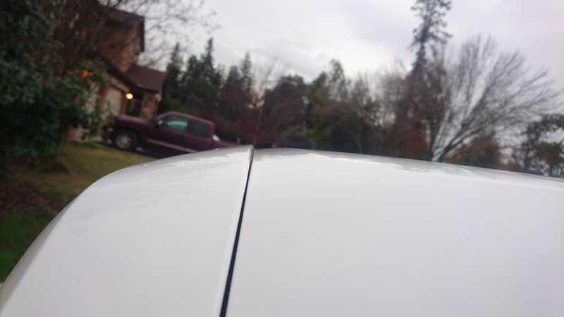

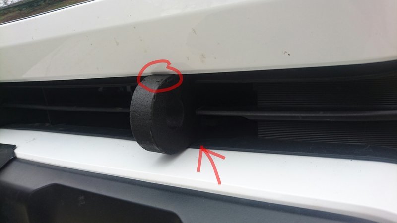

    The bar is too big for the black gap. It took alot of force to get the bar to fix in it that i was afraid of breaking the bumber apart. tmp_6942-_20170108_123509-765919834.jpg tmp_6942-DSC_00272142370662.jpg

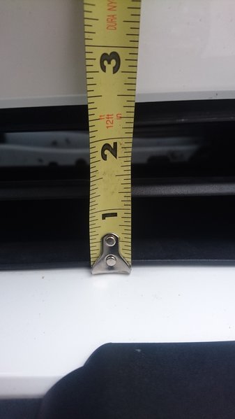

    From the picture, the smallest part of the bar and the biggest part of the black gab in the bumber are not the same. Partly mine fault as i didn't measure before hand, i figure since it was made by a good fab group and was designed for the 2016 tacoma it would be fine. tmp_6942-DSC_0023831997322.jpg tmp_6942-DSC_0021-458758110.jpg
    Because the bar is too big and forcing the plastic apart, its also causing the lower part of my front grill from closing correctly. I'm just glad their two screw that hold it at the top of else it might pop out of i but a bumb. tmp_6942-DSC_0020267852561.jpg
    Since it is pushing the front grill up the hood take good deal of force to close.
    The moment I put it all back together i instantly regretted it. my brothers that help me was joking about me wasting money and time with the stuff i bought and telling me i might regret it. didnt day a word to me cause they saw the look on my face. i just went in the house and started to read a book to help me calm down.
    I still have the skid plate i need to put on, but after reading a post about it hitting the exhaust pipe and this issue with the bar. I'm afraid of messing up more stuff on my truck.
    I'm hoping that it was a mistake on my part during the installation and can be fix. only thing i can see is cut into the front grill to relieve the pressure that causing my grill and hood from closing properly, but in doing so defeat the point buying this bar. I like the stock look, but wanted a way to put a winch on with as little cutting as possible.
    If anyone have an idea that help my please post your opinion.

    Trim the piece around the receiver so it stops putting everything in a bind.

    @Tommyvue
    As you can imagine these trucks have minor variations considering they built in mass production. As much as we try to design and fabricate to this we can only be so perfect.
    I'm sorry you're unhappy with the fitment. The solution if you've already trimmed the black, plastic is to trim the grill ever so slightly to relieve the pressure.
    As for the skid plates, we've shipped A LOT of them and only one contacted the exhaust. Again, minor variations in the trucks. As you can imagine the exhaust hangs on rubber hangers and I'm sure they don't put much effort in making sure it's in the exact same spot over and over since it's not touching or even close to anything under the truck.
    If you have an issue, let me know. Either way, contact me on how we can make this right.

    I can understand you frustration and reservations about cutting the plastic. In my honest opinion I recommend just cutting the plastic. It will still look great, make everything fit better, and make you feel better.
    ChadsPride likes this.

    I cut as much as possible from the top, anymore and i hit the white part of my bumper. the bottom still have the thin black plastic bottom piece(red arrow). even if i take everything apart again to cut that thin piece, i don't think it'll solve the issue. it's the front grill that hitting it(red circle). the white paint that is in contact to the hitch and two shackles point is already scrap off due to the lower part of the grill moving when I'm driving. if i cut off a little bit in the red circle, the grill and hood might close properly. but doing so will make it look so bad. I might as well just cut it all off and get a full bumper.

    There are pretty big holes in the flange. Please make sure the recovery bar is pushed all the way down and held down during tightening. It tends to ride up a little. Looks like you only need a little bit to make it all work. The tight fit is on purpose to make it all look stock. It can be a pain but it usually works out for the best.

    I feel your pain about fitment but it looks like Mobtown is willing to help you out! Like SoFlaTacoTRD said "test fit"! If it hurts too much to cut into the white plastic, break out the grinder and take down the shackle a bit.
