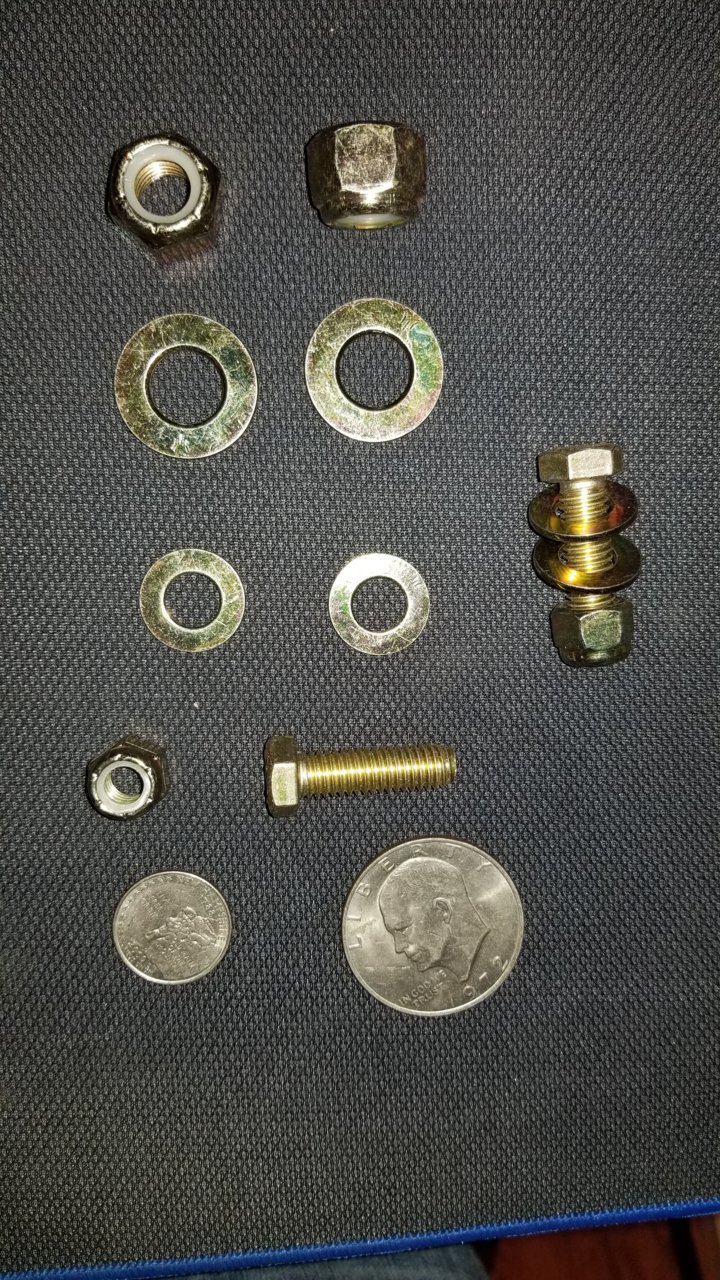

    Here is what I got for fasteners with each sliders. The 1/2" bolt length is based on memory but I am pretty sure they were the same length as the 3/8". All fasteners seem to be yellow zinc chromate plated. The fender washers that I drilled out were 1.25" OD. The extra 1/2" nuts and washers really through me for a loop at first. I would have loved to see the thick square washers that are used on the heavy duty sliders.
    I just uploaded all the pictures I took to an album on my page. (https://www.tacomaworld.com/media/albums/mobtown-overland-rock-sliders.58626/)
    3x - 1/2"-13UNC, 1.25", Grade 8 Hex Head Capscrews
    5x - 1/2"-13UNC Nylon Insert Nuts
    10x - 1/2" Washers, 1-1/16" OD
    6x - 3/8"-16UNC, 1.25" Grade 8 Hex Head Capscrews
    6x - 3/8"-16UNC, Nylon Insert Nuts
    12x - 3/8" Washers, 13/16" OD
    12x - 3/8" fender washers drilled out to 1/2"
