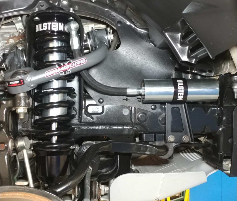

    That reservoir would certainly be in the way of the side straps.
    It would be better if you could move the reservoir, is that possible?

    It might be possible to move the reservoir. The reservoir hose for these shocks are fairly short and also thicker than most shocks. This limits me on where I can move it to. I have seen another bumper that has a strap with an integrated reservoir mount but it is the wrong direction. It looks like I would have to fab something up either way. Below is a picture (from Bilstein) that shows the entire shock. Thanks for the reply.

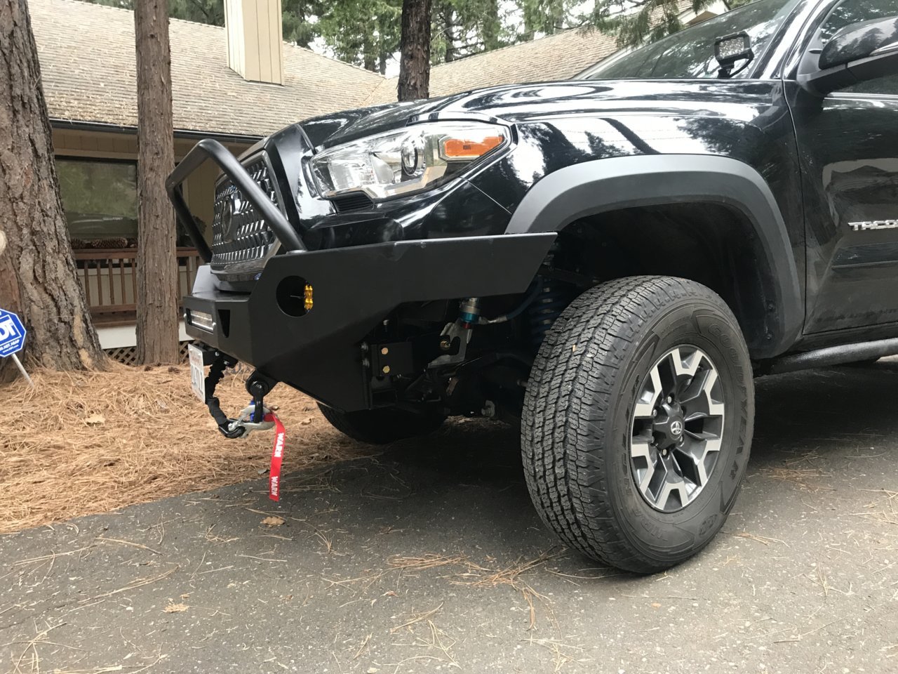

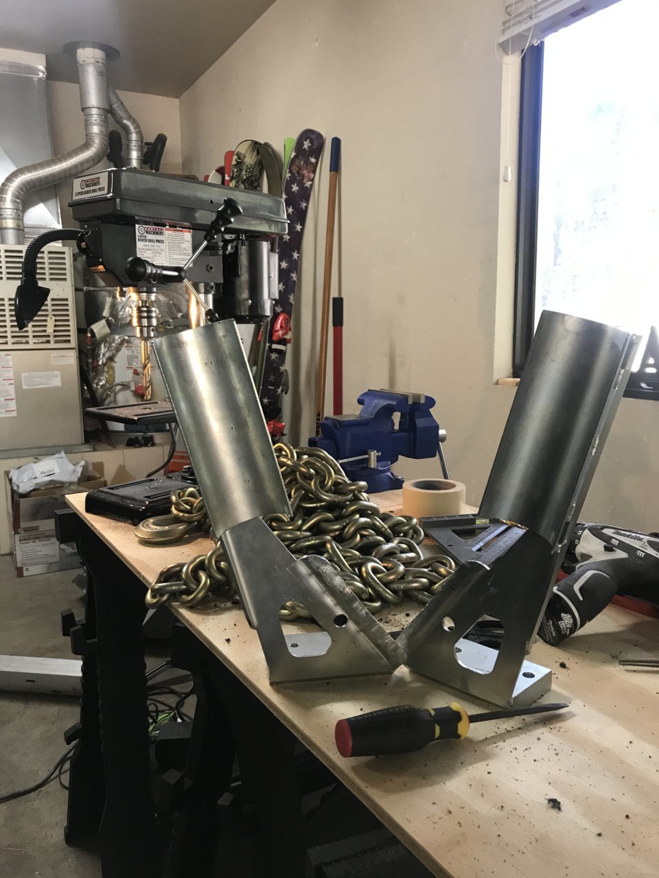

    Good news everyone. Just got my bumper on and I’m happy to say it went very smooth. I was a little hesitant about notching my reservoir brackets for my Kings, so I hammered the front notch flat and then drilled through them for the strap bolt. This went pretty well and left a lot of material behind which made me warm on the inside. Also the tall front hoop doesn’t seem to interfere with the Toyota safety sense radar in the front grill so that’s nice as well. Attached some pictures that you guys might find helpful if you have the same suspension setup. 10/10 will be back when it comes time for skid plates.

    @Joe-pro-pistachio Nice work on making the side straps work with the resi brackets. I was wondering if that was gonna be an issue. Did the lower frame brace brackets not work out? Asking since I didn’t see them in the first pic.

    ... lower frame brackets? Missed that step I guess but didn’t have any big spare parts left over so maybe. I didn’t have the factory skid on so maybe that’s why it looks funky?
