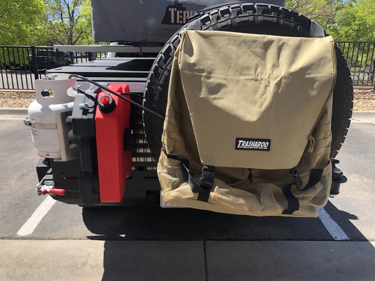

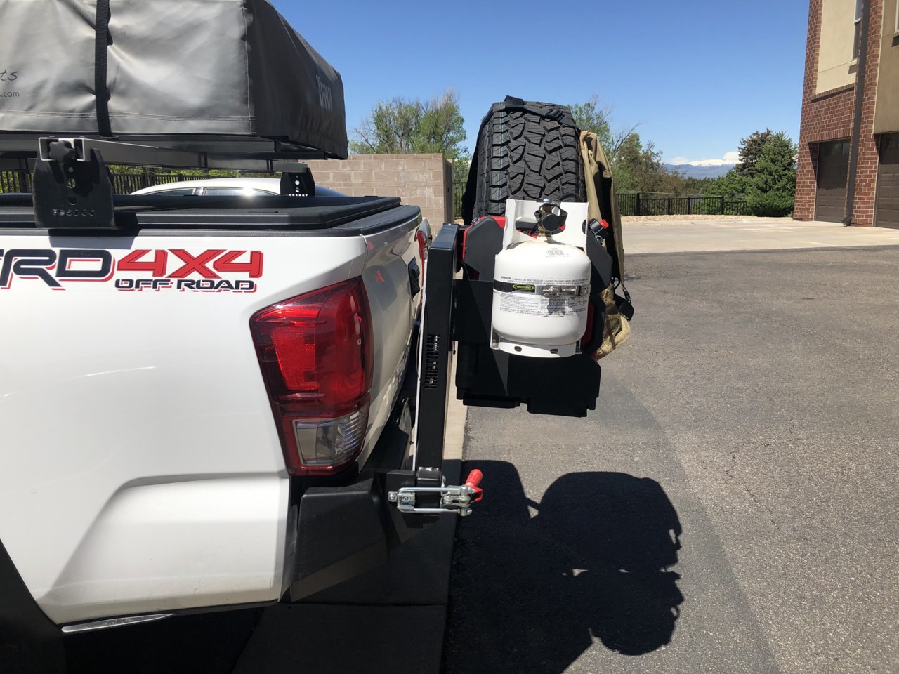

    Here’s a couple of pics in case you guys were interested. I never got my camera relocate bracket from mobtown so I might be doing a license plate camera. I also passed on the hi lift mount...the swing seemed like it was sagging already so I didn’t feel comfortable putting more weight on there. I’ll probably write a review once I get more mileage with it so feel free to reach out if you guys have any questions you want me to address.

    Electrical tape works really well for the slack on your trasharoo straps. Just fold them up and wrap it in tape. Really cleans it up and still fits a full 33 gallon trash bag in there.

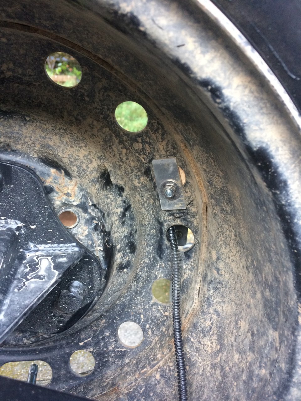

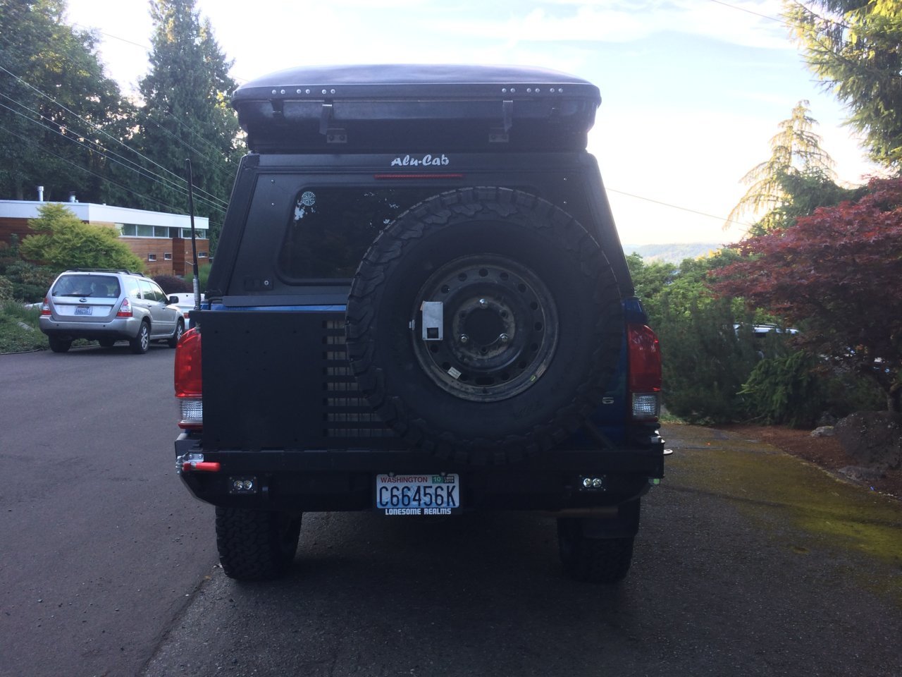

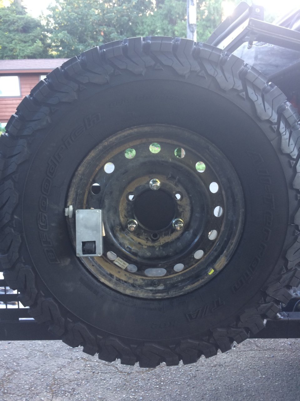

    Got my MT bumper and swing-out installed - very pleased with it. For the rear-camera relocate, I fabricated a mount using an all-metal guitar effects pedal housing (AMZN) and placed the back-up camera within it. I made a camera wire loom extension using water proof connectors, so I can relocate the back-up camera elsewhere on the swing-out when I use a Trasharoo (which I sometimes do on longer trips) or have to remove the spare tire. It is now painted black, and sort of disappears in the spare tire.
