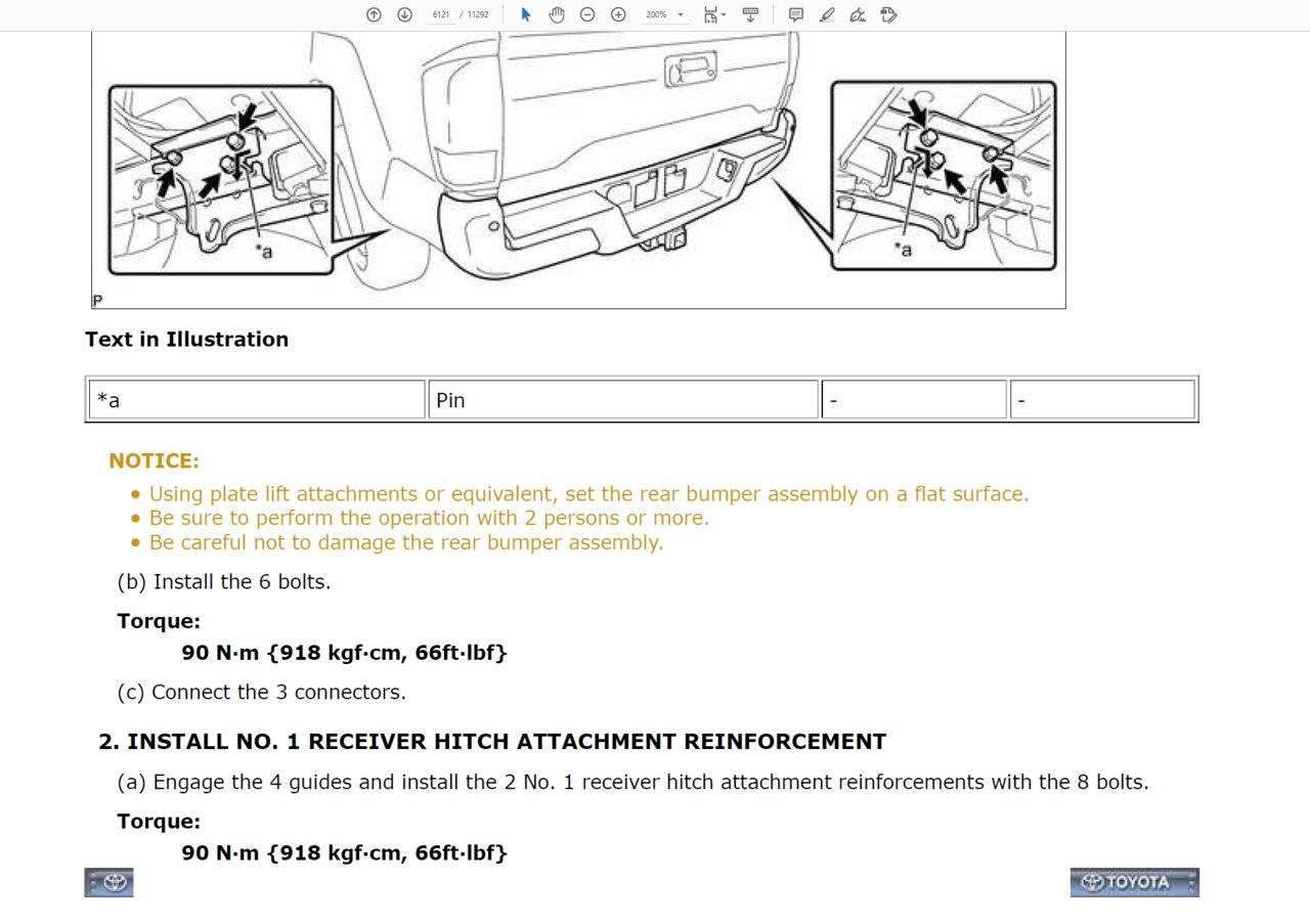

    It took me a while to find the torque spec for rear bumper and hitch receiver install. 66 ft*lbf From the Toyota factory service manual:
