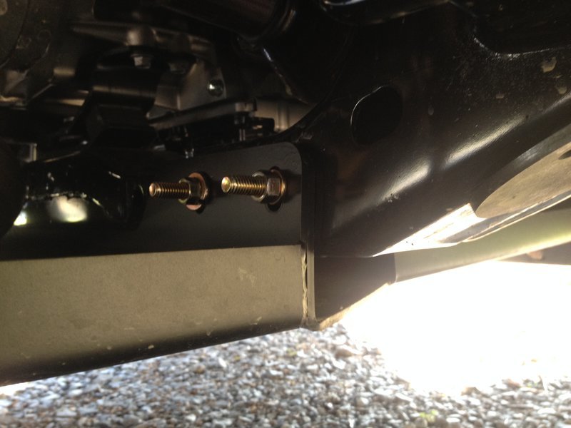

    Sorry for the delay fellas, we are at the Toyota Takeover in Rausch Creek in Pennsylvania wheeling.
    I've attached a couple photos to hopefully help an Ill get install instructions made this week.
    Pic 1 shows the formed piece bolted to the transfer case skid plate. It thru bolts using 3 3/8-16 bolts, 6 flat washers and 3 nylon lock nuts.image.jpg

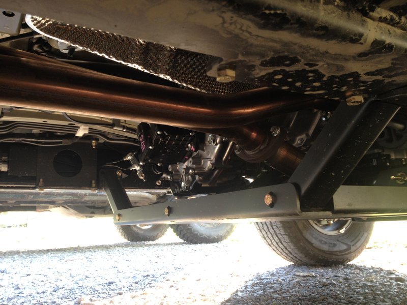

    Pic 2 shows the transmission and transfer case skid plate bolted thru the transmission cross member. Remove the factory bolts and replace with 4 3/8-16 bolts, 8 washers and 4 nylon lock nuts.

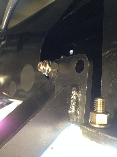

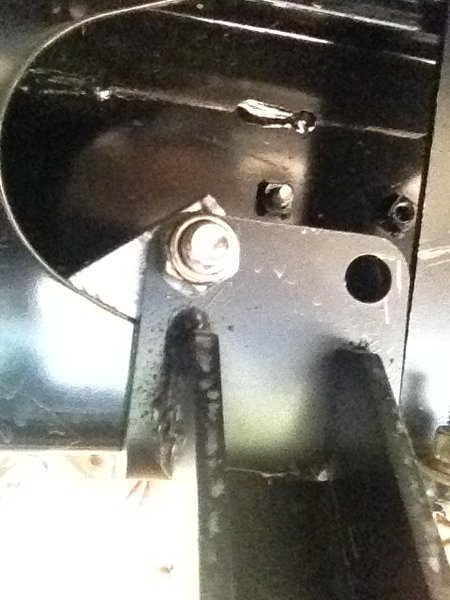

    Pic 3 and 4 shows how the beam clamps are installed. They thru bolt in the formed piece we supply that is bolted to the transfer case. Orient the clamp on the inside of the chassis where it begins to box at the front. Pass the bolt from the back side of the clamp thru the bracket facing you and then fasten with 1/2-13 bolt and nylon lock but.

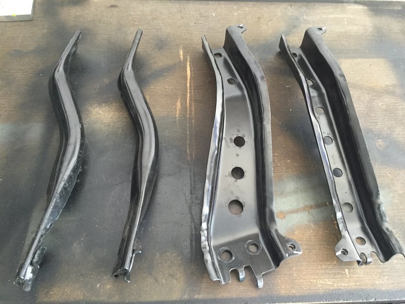

    Thank you, with the proper instruction I was able to complete the install in about 10 minutes.
    One more question, did I need to remove these or not?

    No sir. Those are not reused.

    Sorry, so, they need to stay on the truck correct?

    No, throw them away. Or save them if you ever want to put the stock stuff back on

    Awesome, I was about to soil my pants thinking that I needed to put them back. Thanks for the help. Enjoy the Toyota takeover.
