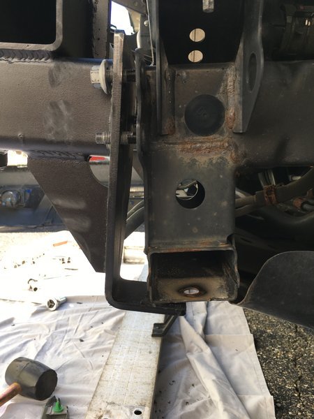

    Having a real hard time with fitting this up. Unless the studs that it bolts to are maneuvered to point down very far the bottom won't clear. Any advice?

    The main flange that attaches to the truck, that slips over the studs I believe is wrong. We ran a batch and that part was made wrong on the press brake. But that was months ago and we took care of the people that it happened to.
    A fix would be to slot the holes vertically where the studs on the mount plates stick through. A handy tool for this is a rotary file.
    Has this been sitting around a while?

    Thanks way off. Mine wasn't even close to that. Bolts lined right up. I'd request new one to be sent or let them fix the issue. I wouldn't be happy - after spending the time removing all the front parts and attempting to fit, only to find out they sent ya a part that doesn't fit. Just saying.....

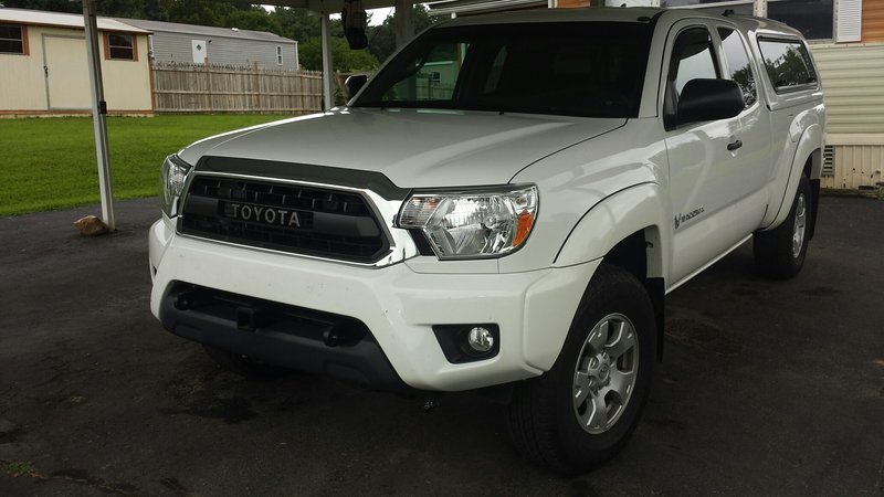

    I'm very happy with my recovery bar and my installation went very smoothly. It blends in with my truck so well you have to do a second look to really see it.
