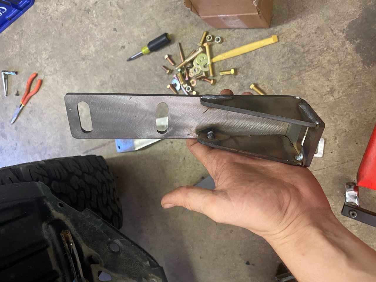

    I ordered one of these about 2 years ago and am just getting around to installing it, I did not get instructions with it and cant find any online. Seems I have extra brackets too like the post above. 2012 Tacoma. Any help?

    Once you get the bumper and grill off, it’s pretty self explanatory. Remove the plastic from the aluminum crash bar and the aluminum crash bar itself. The hitch takes place of the two aluminum spacers that the bar is bolted to and then the bar bolts to the hitch. The bumper grill will have to be trimmed accordingly to fit back over the hitch. At least on my 2011. 2012 may be a different in how it lines up. I put mine on my 2011 Taco and then modified it to go on my 2017.

    Those brackets may have been added to the kits after I got mine. I never had them and never had a problem.

    awesome that would be a big help, thank you. And that link does indicate the other brackets were added to the orders later after that failure. this has been a big help.

    wow this is such a big help thanks, however, these instructions don't say anything about either of the two different style brackets that came with the recovery bar or any of the additional hardware that came with it. That being said I think I can get it all together with the pictures from this thread.
