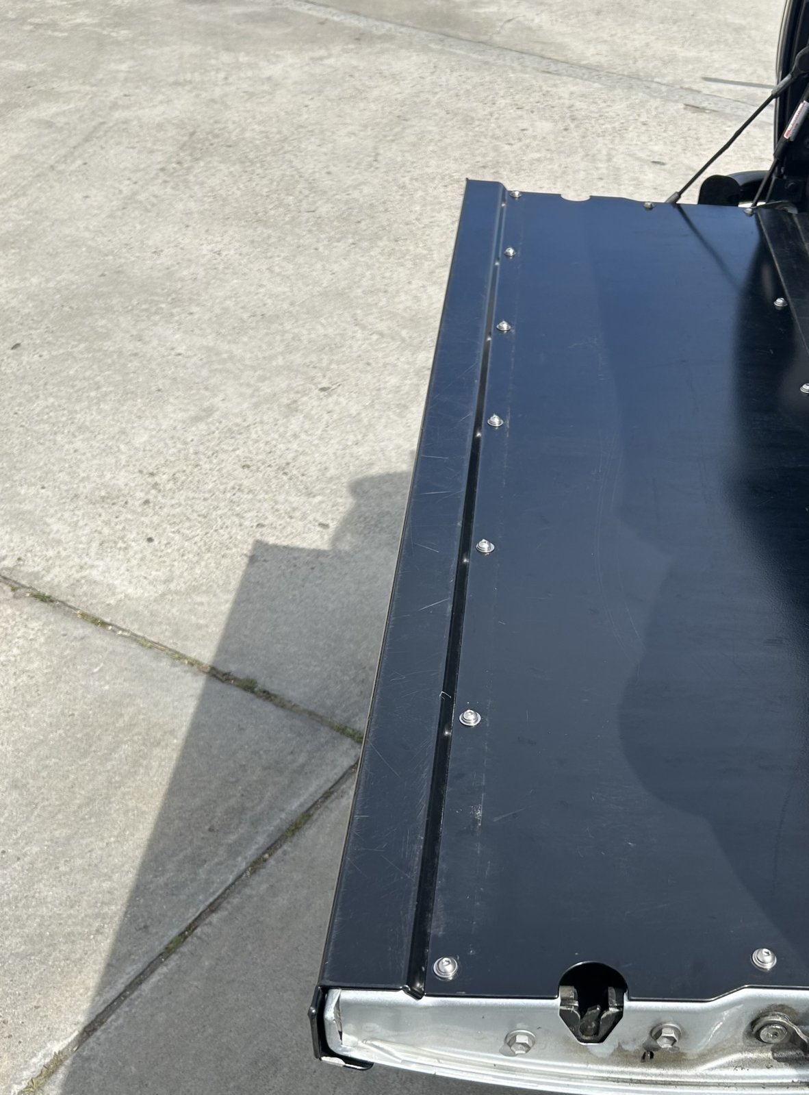

    does anyone know hardware upgrade kit dimensions
    the kit that used to be available from Mobtown?
    it replaces the stock weak hardware with nutserts and bolts
    I'm guessing rounded allen bolts, flat washer, spring washer
    I already have a bag of 1/4 nutserts that I believe is the right one. Just not the bolts and stuff
    if nobody knows, I'll put the nutserts in and go to a hardware store to see what fits in the parking lot before getting total quantity
    and/or poke a digital caliper in to measure depth as an alternate method
    torx might actually be more strip resistant than regular allen
    also, does anyone know how the old inserts get removed? White/yellow plastic, the fragile ones
    I have a full wraparound Relentless flat skin (not pictured) but the stock mounting is definitely an issue.
    -some are stripped
    -it doesn't hold tight. There's a limit to how much torque the plastic thread can take
    -it ends up loosening over time on it's own, shaking and preventing close of tailgate requiring re tightening
    Hopefully with nutserts, bolts would line up and not need boring/reaming/widening of the Relentless skin holes to allow for line-up. Ran into that with aftermarket engine skid plate before.
    like so:
    r34p3r666 likes this.
  13. Mar 28, 2024 at 12:59 PM
    #273
    TacoTuesday1
    TacoTuesday1 Well-Known Member
    Jun 19, 2019
    #296781
    7,776
    SD CA
    figured it out kind of.
    Hardware store got all stainless
    1/4-20 Allen cap bolts 1” long
    Split lock washers
    Flat washers
    couple bolts didn’t want to line up but oh well.
    Pulled out the old plastic inserts by hand. Put in a kit of 1/4-20 rivet nuts from Amazon.
    I think the next size up was 1 1/4” which looked too long. Next size down 3/4” looked too short.
    Stuck a sample 1” bolt with washers underneath from the backside to visually confirm it went fully through everything without protruding too much.
    Seems held on much better now.
    other option would’ve been Torx Plus that allows tighter and less strip prone. But it doesn’t need to be that tight with that many bolts. Torx plus would require buying and storing an additional bit instead of basic L wrenches that everyone already keeps.
    so if I had to guess what the Mobtown hardware kit would’ve used, probably 1” length bolts.
    any extra work could have potentially:
    -countersunk the relentless panel holes to use more flush bolts
    -bore out all the holes just a little bit wider to make line up easier
    but the panel has been powder coated and I didn’t want to mess around with disturbing it and touch up painting.
    black oxide might have looked better but I don’t know if it’s as corrosion-proof and don’t want it turning into ugly rust.
    took off the aluminum flat bar I had on top for securing a full bed rug I no longer have. It was nice having that piece of silver to see in the rearview into the bed and know for sure my tailgate was closed as added measure.
    But there’s probably other ways to do that like putting a colored piece of tape.
    maybe the difficulty lining up some bolts was due to powder coat thickness. Or the fact the tailgate wasn’t designed to use rivnuts with less forgiving tolerance than a weak piece of plastic.
    Tiny bit of boring out every hole would likely not cause any issue securing as the flat washers still have enough width to clamp.
