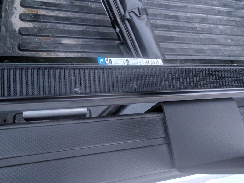

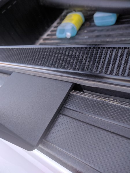

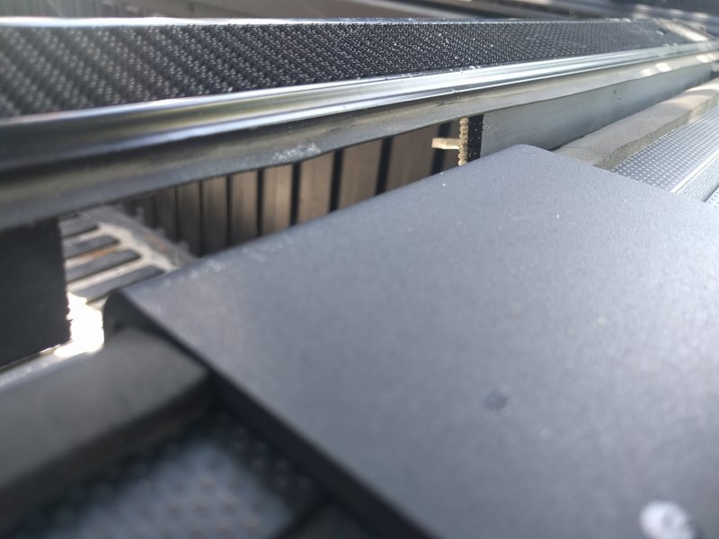

    Hi Guys,
    I've received my bars today and stated the installation.
    Quickly realized that the Truxedo would need to be hacked to fit. Can anyone confirm this and show me what they did ?
    My best guess would be to cut the vertical plate that is part of the Truxedo rail at the Bars location so it will sit on the bed properly.

    This is a new one. I haven't seen this style rail for the covers yet. Can you take a pic from the sides of our upright brackets where the rail of your cover is against?

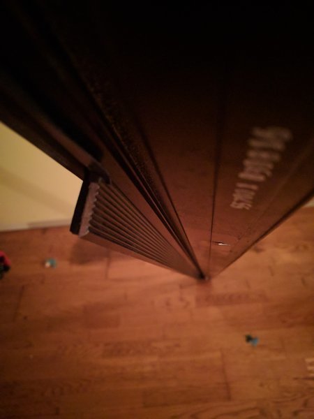

    Here are a few pictures, hard towels show it properly.

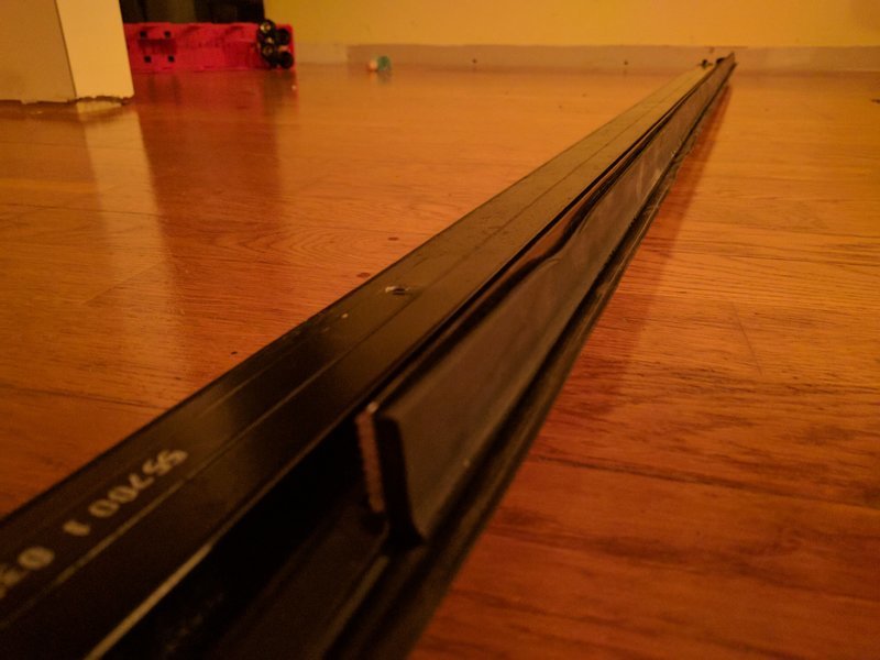

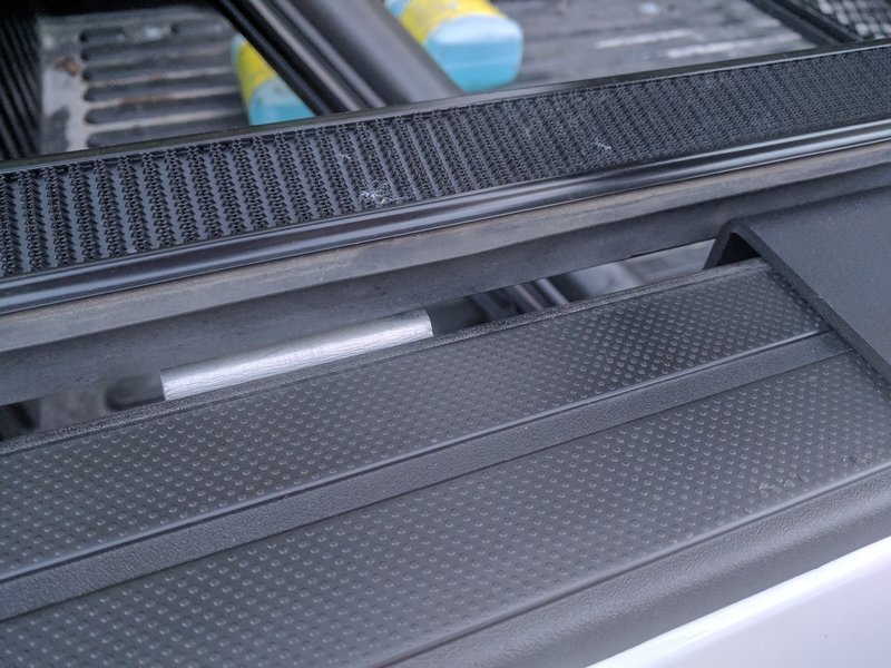

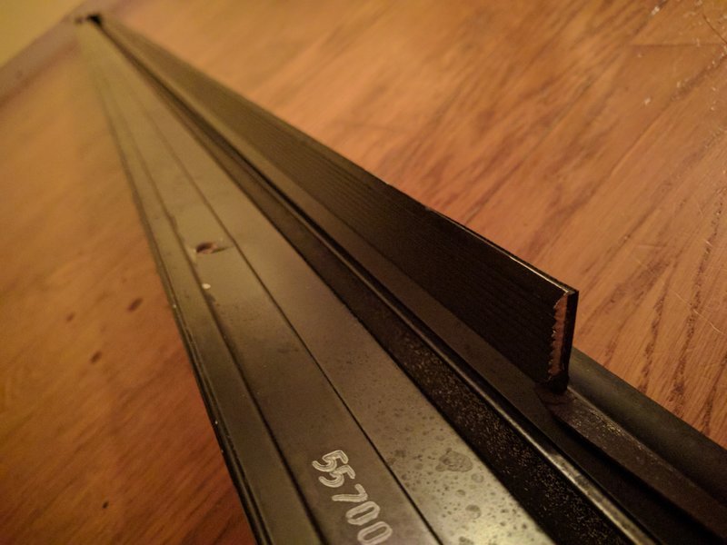

    Hi Guys,
    I ain't got a fix for that so i had to figure it out.
    The rails for my Truxedo feature a "L" shape protruding aluminum part which align the cover and seal it's side. This portion had to be cut where the bars brackets are located. (yes, no longer allowed to change their location after that)
    After that, to retain some sealing i applied strips of the foam tape provided by Mobtown offroad in the kit directly to the side of the bed and assembled the truxedo rails pushing onto that foam. I think it should seal deceltly...
    IMG_20170610_123042.jpg IMG_20170610_123027.jpg IMG_20170610_123342.jpg IMG_20170610_123313.jpg
    All the pictures i took are on Google Drive: Mobtown Offroad - 2005-2017 Toyota Tacoma Bed Bars

    You couldn't have just pushed it up tight against the brackets and let the seal form around them? Then you could just fill in any little remaining gap with weather stripping?
  13. Jun 10, 2017 at 10:14 AM
    #273
    dialfonzo
    dialfonzo Well-Known Member
    Jun 9, 2017
    #221102
    60
    Eric
    Tacoma 2016 TRD Sport Long Cab & Bed
    The seal was not working that way, pushing it down, the brackets raised the rails too much which leaved a gap of around 1/8"

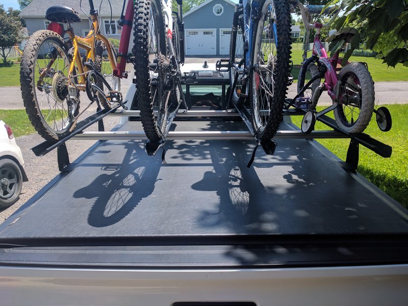

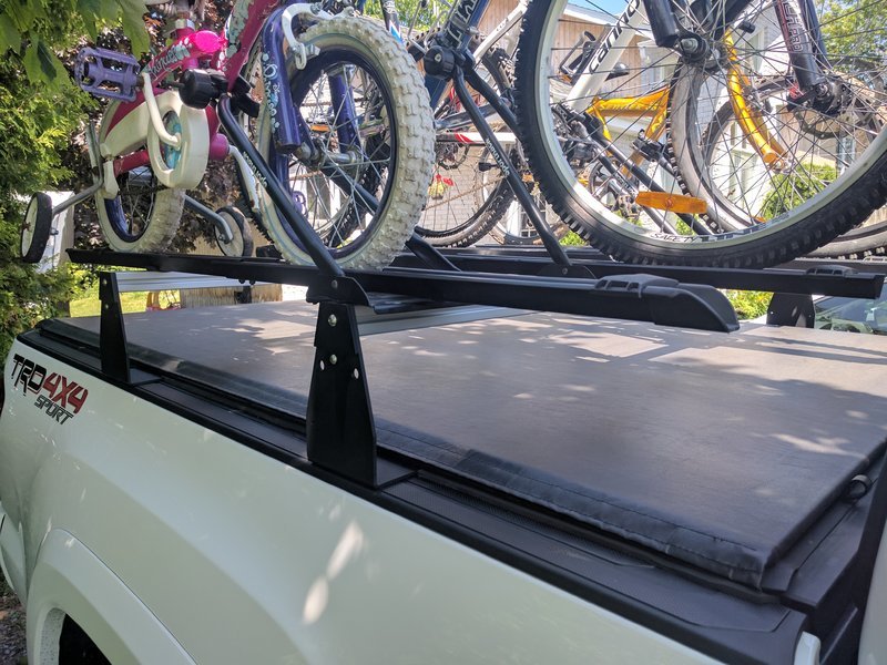

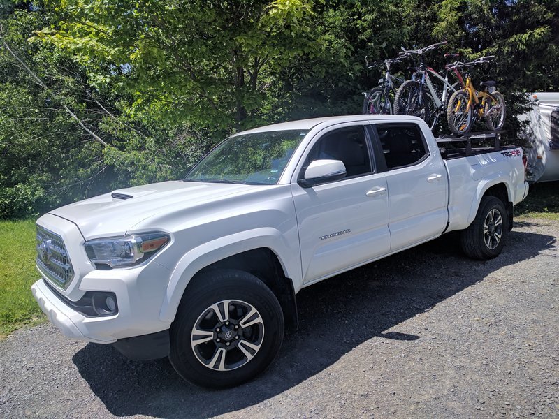

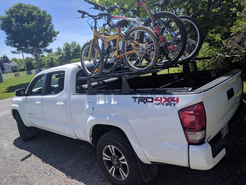

    @dialfonzo How do those bikes ride up there? Ive been looking at doing something similar. What bike mounts are those? Thanks
  15. Jul 7, 2017 at 2:29 PM
    #275
    dialfonzo
    Jun 9, 2017
    #221102
    60
    Eric
    The overall assembly is very strong, almost no movement.
    My racks are from SportRack, I got them used but here is the model :
    http://www.sportrack.com/p/upshift?pp=24

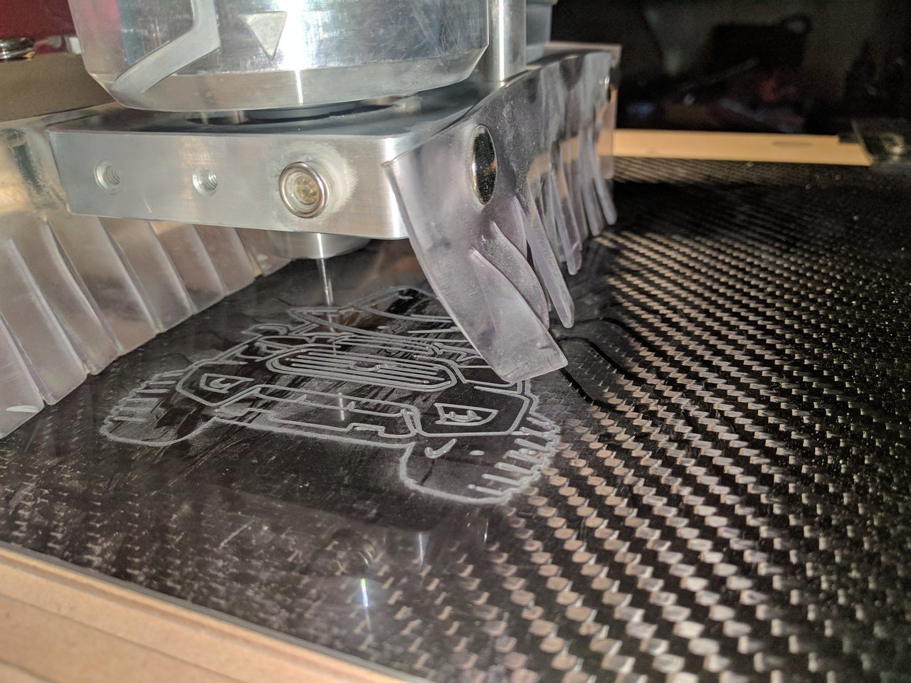

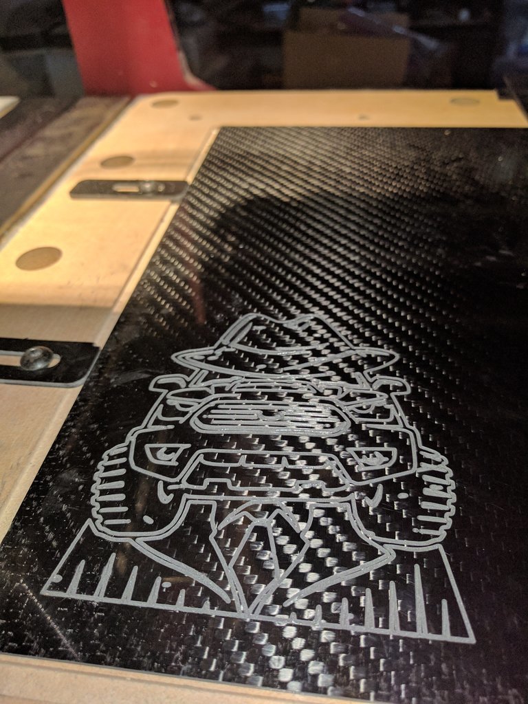

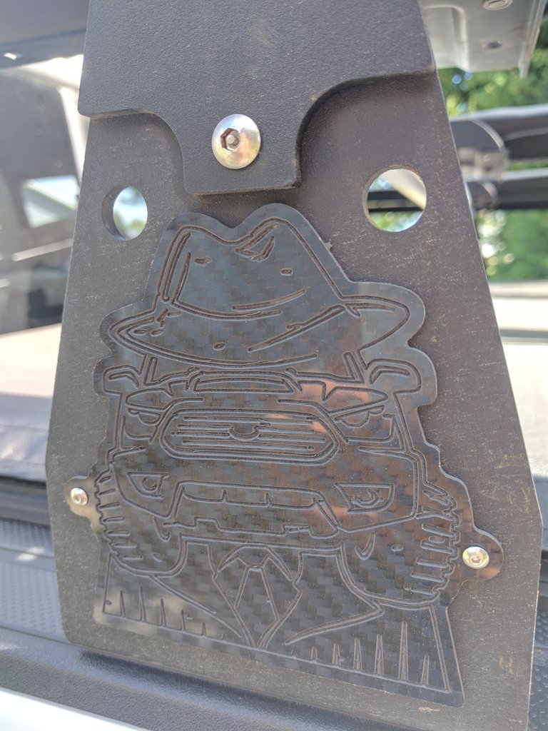

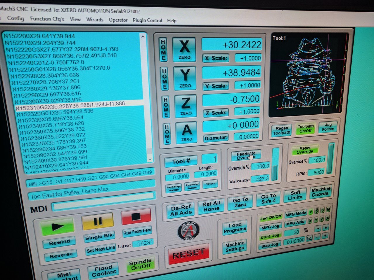

    Hi There,
    Here is a quick design i made to add some branding plates to my bed bars since they deserve to be named...
    Will be adding some white paint in the engraving area..!
    IMG_20170709_161346.jpg IMG_20170709_160821.jpg IMG_20170709_161444.jpg IMG_20170709_162153.jpg

    Very cool. Can't chance you can email the line work file to us?

    He already did. He sent it to me. I haven't had a chance to look at it

    I did some changes since my email .. I'll send them tomorrow.
