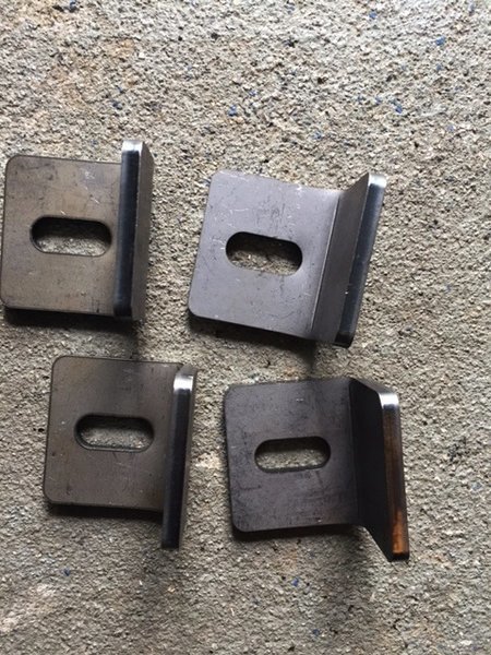

    Finally got the word from the laser house we use that the formed pieces for your sliders are complete. I am going there first thing in the morning to pick them up and ship them right out. Thank you both for your patience in this unexpected issue.

    Got 'em. They look good. They look beefy.
    Don't have a clue how to install?
    No instructions.
    Thanks.

    Instead of bolting through the beam clamp, you put these in their place and bolt through them. Push them down so the flat part is against the chassis of the truck.

    That is what I thought. Haven't had time to paint them and try, though.
