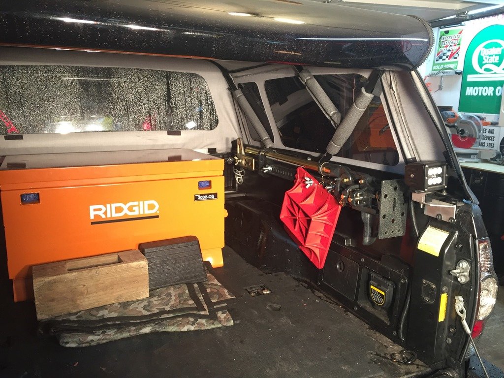

    Well, I mounted my High-Lift tonight:
    56A3B18B-921E-4F1F-B764-8CC66A3DBAD1_zps_3bc34229386bff831834001ea0aa3c2228972e3c.jpg
    Now, if I only had a lift point... Anyone have any ideas for a good lift point? :D

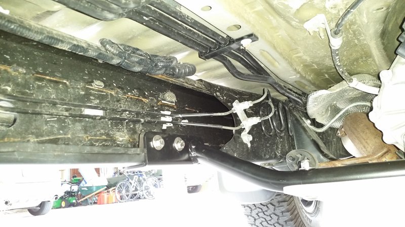

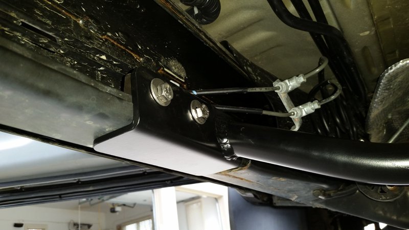

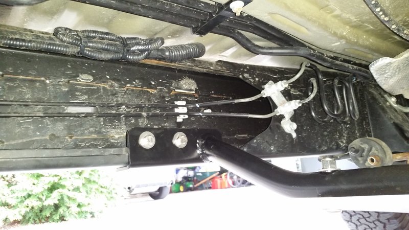

    So I finally got around to installing my BudBuilt sliders today, and as expected the transfer case (rear-most) skid's cross member attaches to the frame in the same place that your sliders are boxed. Any ideas on how they might share the same spot? The cross member only needs to be strong in the up direction.

    Well shit, that is exactly where our C clamp is positioned. Doesn't mean we can't come up with something. Can you send me a pick of the other side of the bolts, how it actually is clamped down?

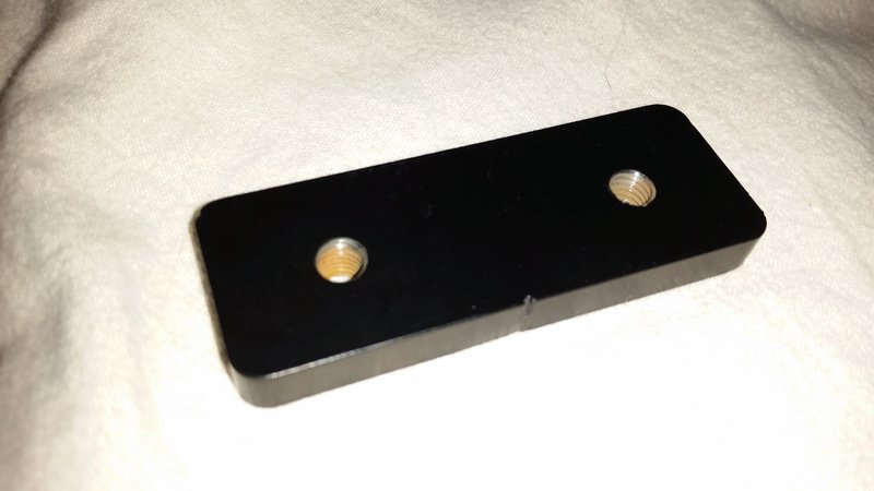

    The two bolts thread into a rectangular piece of 3/8" steel resulting in a pinch on the frame. I upgraded to stainless hardware, so I got two sets - the stainless ones on the truck and two like the black one pictured here. It's not a very strong hold, and really just keeps the cross member from moving around. The only significant loading that it could take would from underneath or side-to-side and the 90-degree brackets transfer this to the frame, not the bolts-and-clamp arrangement.
    The front of the transfer case plate (the one in question here) is bolted to the rear of the middle plate, and its center is bolted to the factory transmission cross member just in front of the exhaust crossover pipe, The skid plate cross member takes care of the rear edge, but I could remove the skid plate cross member altogether and the plate would still be secured. Of course it would no longer be able to take a big hit and would bend up at the exhaust crossover if it did. However, this means that the skid cross member could be removed, your sliders could be installed, and then the skid cross member could be modified with the skids and sliders both bolted in.
    I'm not a fabricator, but I bet that the 90-degree brackets could be cut off the ends of the BudBuilt cross member and replaced with something that would line up with the two bolts in the bottom of your c-clamp and provide some surface area to take an upward load. You'd know better than me on that, but this is what I'm thinking.
