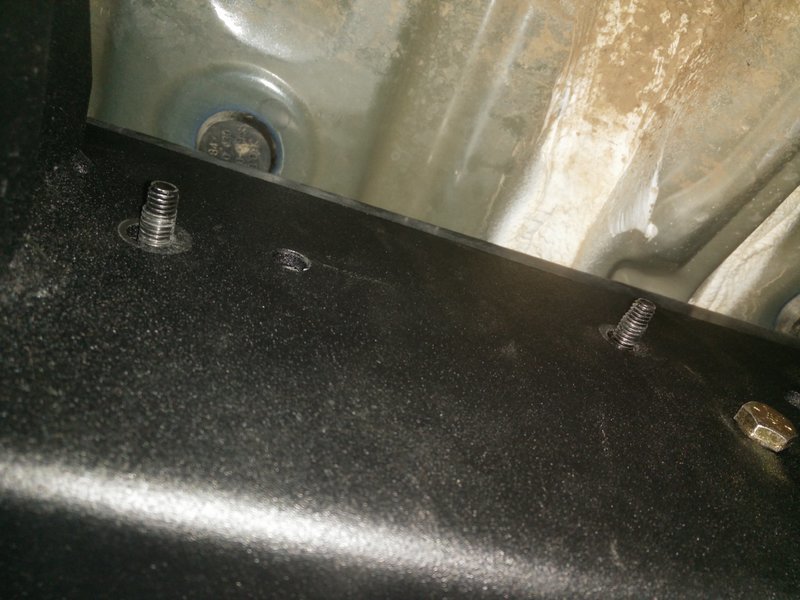

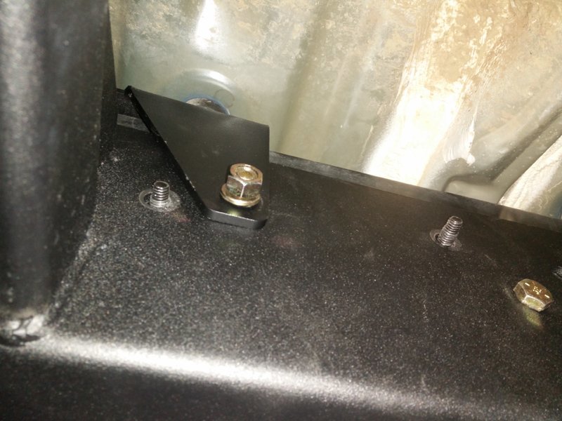

    Ok, took off the wire box and put on the L bracket with the bolt on the inside:
    Here's how far out the wire box bolts stick out with the bolt on the inside. I tried threading on the nuts and I feel like this will work ok, there's enough coming through on the foremost bolt that I could get a good few turns out of it. (Note I didn't tighten down the L bracket bolt all the way, this isn't what it should look like when properly tightened):
    For reference, here's how far out they stick with the L-bracket removed:

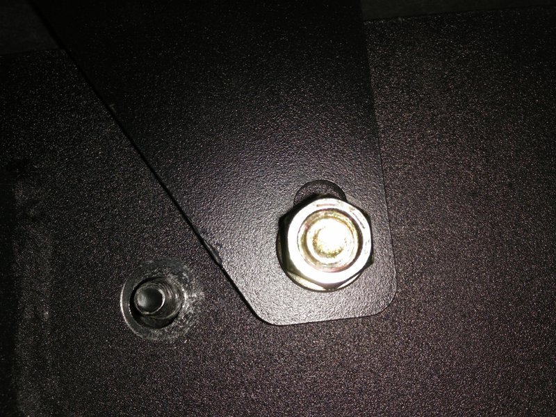

    So I think this will work. My only concern is this split washer sitting on the large L-bracket opening. Will this hold well, or should we add a flat washer between the split washer and the bracket?

    It'll hold just fine. You'd actually be doing more harm than good when adding a flat washer. The split lock will bite the steel and stay in place. When using a flat washer, it doesn't really have anything to bite and the flat washer could spin.

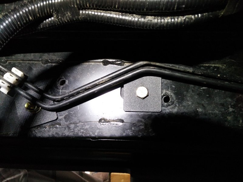

    I'm pretty sure it doesn't matter which way that bolt goes. It's the square washer that's the issue. I think there is clearance for the bolt itself. Maybe I'm wrong but I just installed a set this weekend and didn't see how flipping the bolt would help.
    Also @Mobtown Offroad you still need the square washer since that is one of the large holes in the frame.

    I must be misunderstanding him then. I thought he was meaning the end of the bolt was hitting the back of the box so flipping the bolt solved the issue.
    @cheuer
    Is the bracket from the box sitting on the square washer when reinstalling? If so, that is not a huge deal either. You should still be able to get the stud back through the hole and the nut over the stud and tight.
