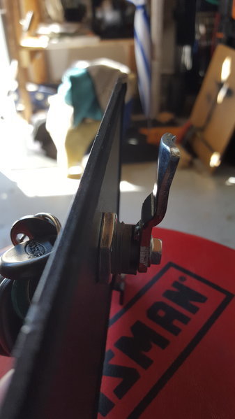

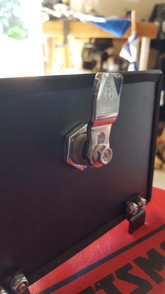

    Think I got it fixed. Had to rotate the locks to lock the same way the factory doors locked. I had the locks installed the opposite way. I got the little door on now to re-do the large door and give it a go. I think that's all it was though thank god lol.

    Oh, yeah haha. The slots in the box are angled to allow compression as you turn the locks so yes, it does matter how the locks are installed in the doors. Good deal.
