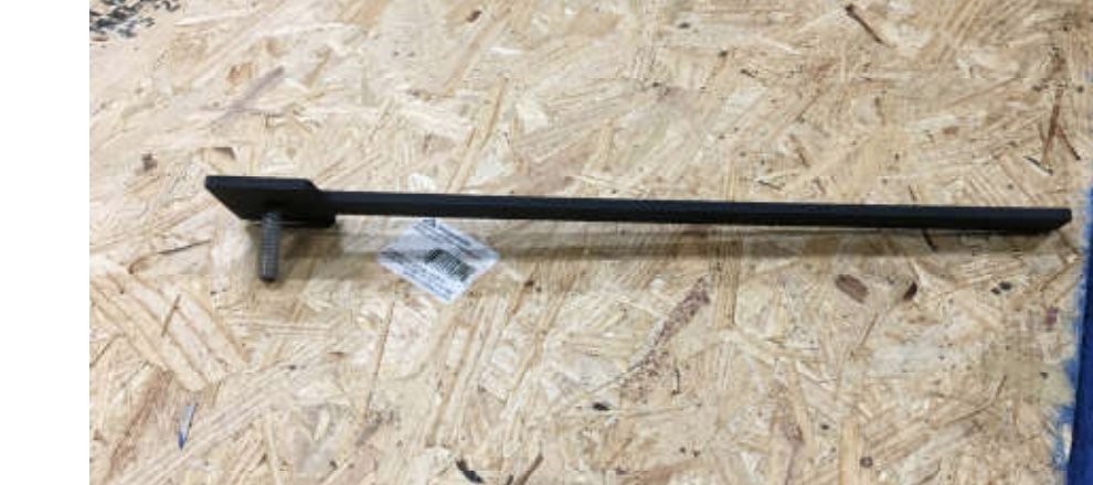

    I recieved my Sliders from Mobtown a little over a week ago. They are definitely heavy duty. I started the install yesterday with the help of a friend. Admittedly, I am not a mechanic, nor a fabrication install expert, but I like to work on my vehicles so I can attempt to fix if needed.
    I can not figure out where this long washer with the bolt welded to it goes on the install (attached Pic). The instructions are okay, but more illustrations/pics would be helpful. I couldn't find anything online, or youtube for reference. Anyone do the install themselves and able to share some Pictures, please? Also, I only saw one spot it was calling for a square washer, am I missing something? There were a number of them in the parts bag.

    It goes inside the frame to help reach the front mount bolt hole in the face front flange.

    Do you have a pic or illustration? Tried to line it up on multiple locations. It faces forward or rear? and installs nearest or at what location?

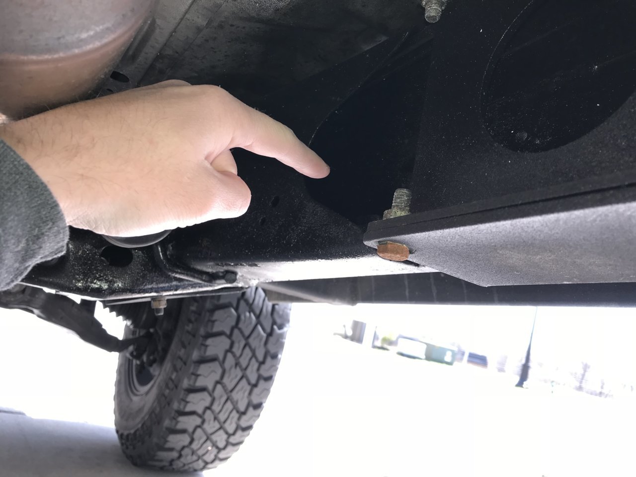

    Don’t know if these help or not. It’s hard to get decent pictures of it.

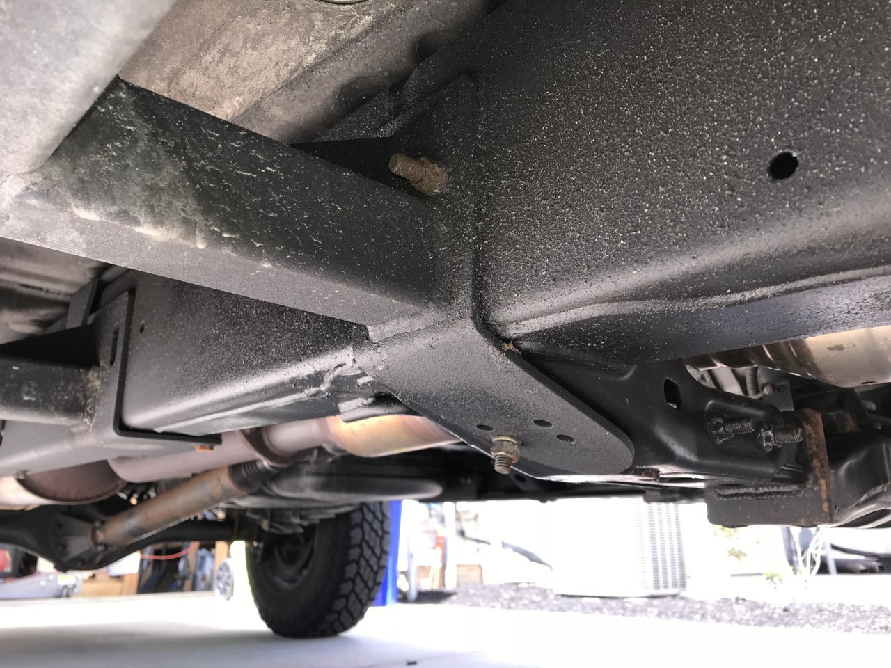

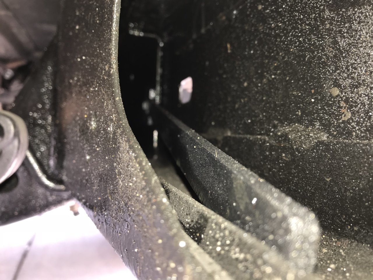

    Outside (it’s the top bolt in this picture.)
    02Duck and snickers like this.
  9. Apr 21, 2018 at 10:03 AM
    jowybyo
    jowybyo Well-Known Member
    Nov 19, 2013
    #116863
    6,092
    Joe
    Baltimore, MD
    '14 MGM DCSB Postrunner 4wd Conversion, Debadged

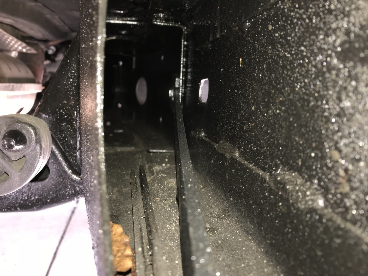

    It goes inside the frame here reaching forward to get the bolt in the hole.
    Mr-Paul, GuerreSOK, 02Duck and 6 others like this.

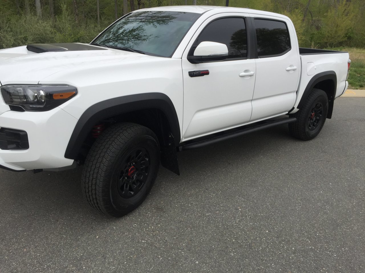

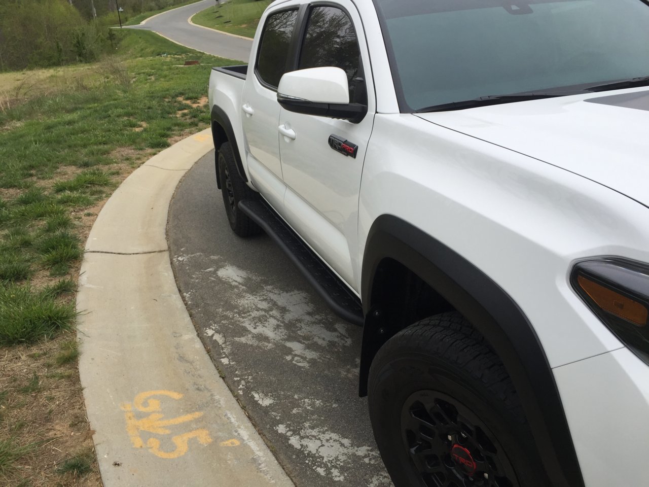

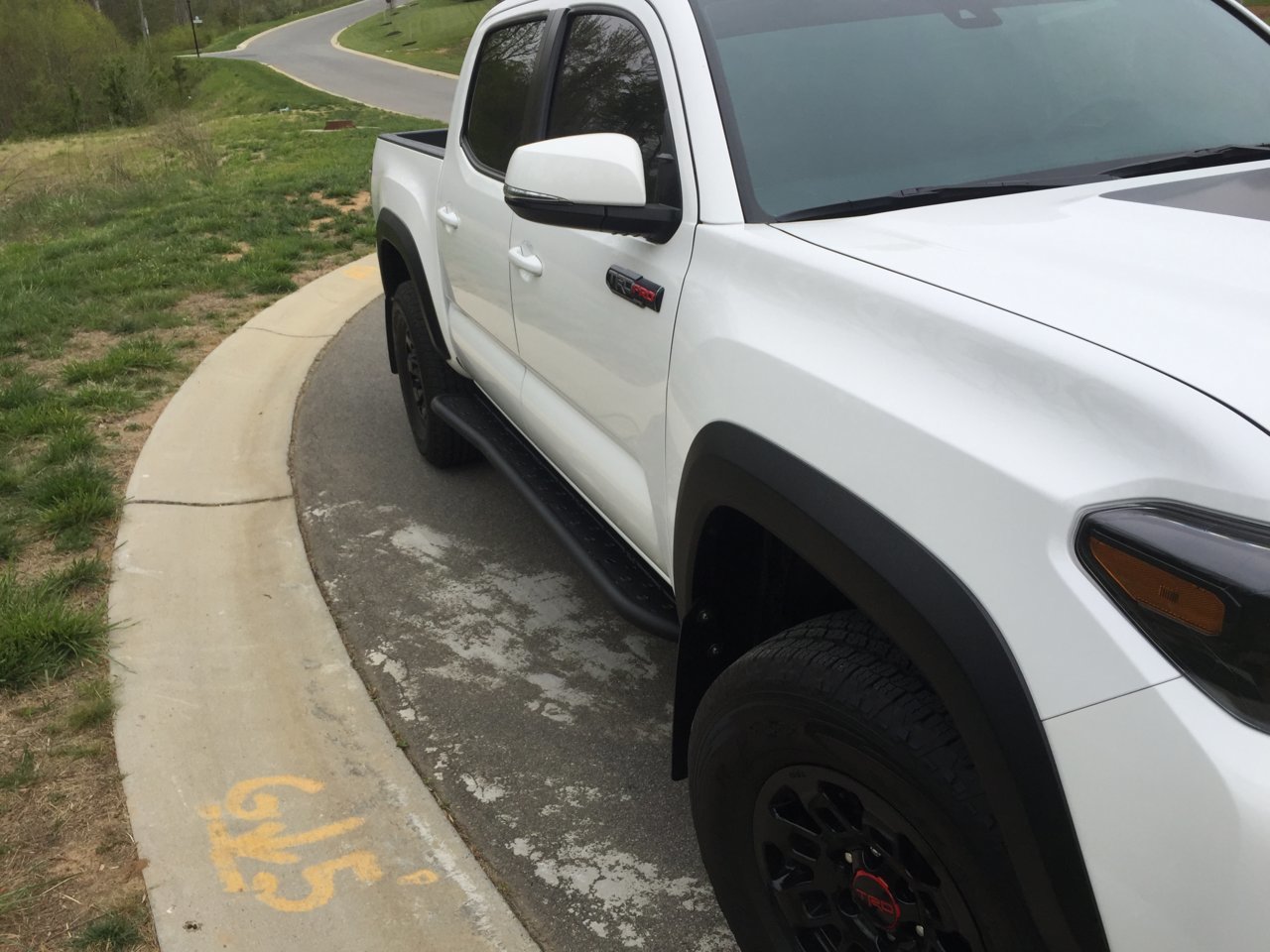

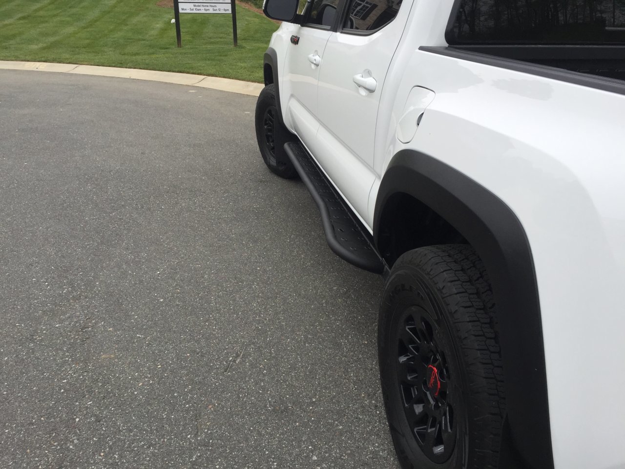

    Mobtown Slider Install Complete... I will probably go back and make a few adjustments, but overall I think they look good. Thank you Mobtown for the assist on a Saturday.
