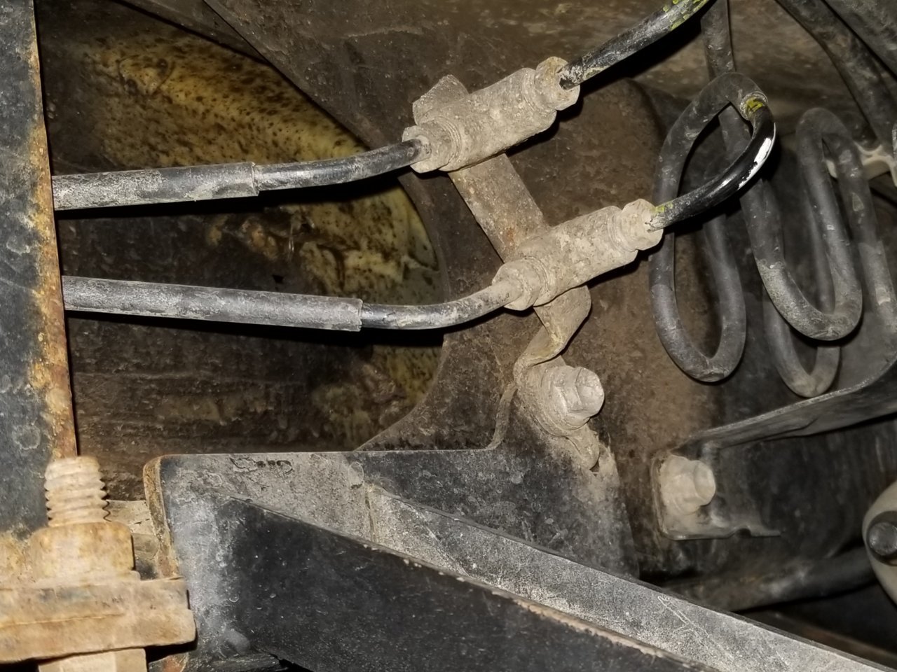

    remgu2000[QUOTED] likes this.

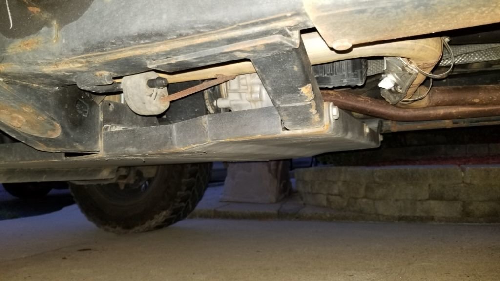

  2. Jul 15, 2018 at 9:32 PM
    #222
    roguegs
    roguegs Well-Known Member
    Feb 23, 2018
    #245423
    4,718
    Angelo
    V8 T4R
    Went from 3rd Gen Taco to 3GT4R to 2nd Gen Taco and finally a V8 4GT4R.
    I can say the steel is definitely sturdy as hell. I ended up smacking a rock on accident and the skid took it like a champ. 47121299-6592-4B8E-80D9-B35CBCE61D28.jpg

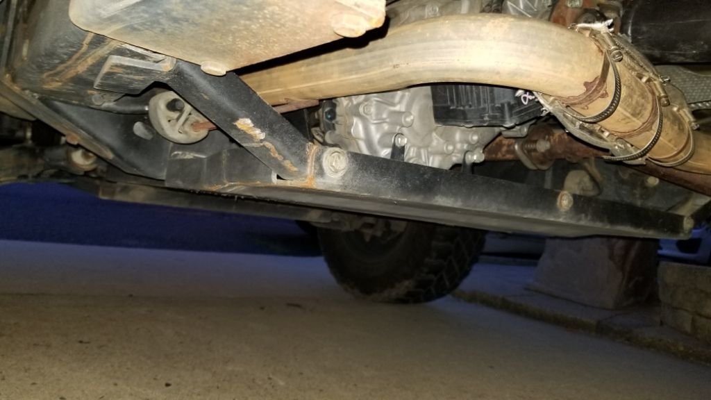

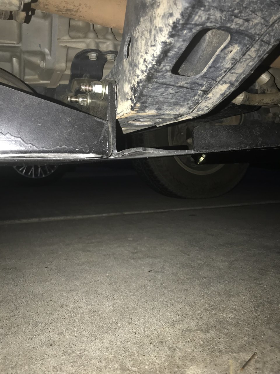

  7. Oct 28, 2018 at 7:00 PM
    #227
    Paint it Black
    Paint it Black Damn That Money....
    May 23, 2013
    #104780
    157
    Ted
    Tustin
    2018 TRD Off-Road DCLB 4x4
    Tinted Windows Clazzio seat covers up grade stock speakers Sound Deaden all doors led cab lights Glove box Organizer Front License plate Mod Kings Cab Chop SPC Upper Control Arms OLD MAN EMU DAKAR LEAF Heavy Sliders SCS Wheels Sungtop Rebel Top Bed Stiffeners Ditch Lights old truck K&N Drop in Bilstein 5100 front and rear Toytec/Eibach front coil lift springs TC UCA Icon 3 leaf aal Cab Chop
    410699B1-70AC-40DD-92EE-224145F6DD09.jpg A8563281-0910-42CE-AD48-3379F1952041.jpg 502E90D1-B002-499D-B3C1-A6908674DBED.jpg
    Well this sucks, 8 weeks to get and then this!!
    Bastek likes this.
  8. Oct 28, 2018 at 7:22 PM
    #228
    OnHartung'sRoad
    OnHartung'sRoad -So glad I didn't take the other...
    Jul 24, 2017
    #224878
    9,622
    Somewhere in the Mojave Desert...
    2017 Tacoma OR 4x4 (formerly a 1998 SR5 PU, 2002 OR 4x4, 1995 4x4 4Runner, 1985 4x4 Toy PU) ... and RIP’s (rust in pieces) to a Bronco II 4x4 & S10 Blazer 4x4
    Based on how out of square my cab and body were bolted on my frame when I tried to put a camper on my only 2-week old truck, I’d say it’s not the skid plate mount that is out of alignment.
  9. Oct 28, 2018 at 7:25 PM
    #229
    Bastek
    Bastek Average Member
    Jun 6, 2017
    #220876
    4,304
    Seb
    SI NY
    '17 OR dcsb
    KDMaxP10, plastidip
    Aluminum. You need to put a jack in a middle of the skid, and jack it up until it touches, and then bolt it up.
    Speaking from experience. It's supposed to be like that
  10. Oct 28, 2018 at 7:28 PM
    #230
    OnHartung'sRoad
    Jul 24, 2017
    #224878
    9,622
    ^ +1. My steel plate also- sorry, forgot about that. @Paint it Black - dont tighten anything until its jacked up tight.
    Paint it Black likes this.
  11. Oct 28, 2018 at 7:29 PM
    #231
    Paint it Black
    May 23, 2013
    #104780
    157
    Ted
    Tustin
    hmmm well I guess i will have to try that tomorrow. The reinforcement seem to be touching. Its super tight.
  12. Oct 28, 2018 at 7:33 PM
    #232
    OnHartung'sRoad
    Jul 24, 2017
    #224878
    9,622
    It slides a bit forward and the front raises it higher, there’s a bit of play in the holes to let it do that.
  13. Oct 28, 2018 at 7:34 PM
    #233
    Paint it Black
    May 23, 2013
    #104780
    157
    Ted
    Tustin
    ok thanks ill check
  14. Oct 28, 2018 at 7:47 PM
    #234
    Mobtown Offroad
    Mobtown Offroad Boss
    Jul 23, 2014
    #134511
    10,797
    Joe
    Harrington, DE
    2002 SR5 4Runner
    We tried to make the aluminum ones as tight as possible. We don’t really want them flexing too much since they not going to hold up to the same abuse as steel, even with reinforcements.
  15. Oct 28, 2018 at 7:52 PM
    #235
    Paint it Black
    May 23, 2013
    #104780
    157
    Ted
    Tustin
    tight is fine, just seem there hitting and wont go any higher even with a jack. But I will try tomorrow night after work.
  16. Oct 29, 2018 at 6:26 PM
    #236
    Paint it Black
    May 23, 2013
    #104780
    157
    Ted
    Tustin
    @Mobtown Offroad
    Ok you were right about the jack. I had to jack the shit out it. Lol.. But god damn it looks good. It fit flush. :)
    Ok, ok, mobtown great job on the skid.

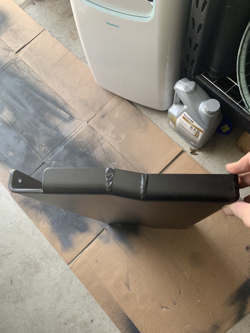

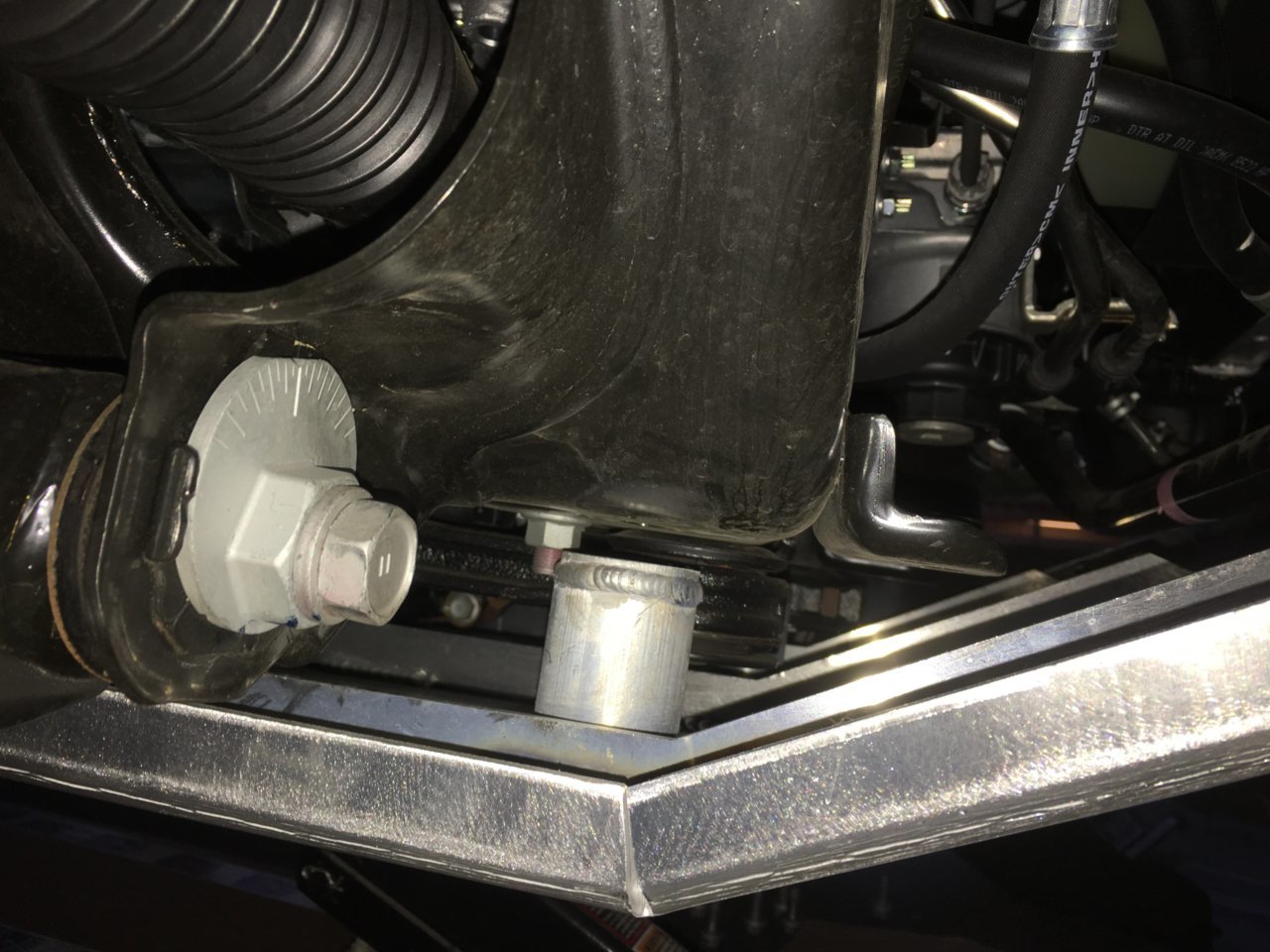

  18. Jul 21, 2019 at 11:16 AM
    #238
    HolyReptar
    HolyReptar Well-Known Member
    Jan 23, 2012
    #71259
    1,901
    Bry
    Thousand Oaks
    17 TRD Offroad 4x4
    Some Bolt ones here and there
    Alright I’m confused@Mobtown Offroad
    I ordered a reroute transfer case skid. The image in the instructions shows a flat skid with a reroute. This is my skid. Looks like it’s a non reroute skid?
    Any input?

  19. Jul 21, 2019 at 5:34 PM
    #239
    Bastek
    Jun 6, 2017
    #220876
    4,304
    Seb
    SI NY
    '17 OR dcsb
    KDMaxP10, plastidip
    This is a proper reroute skid, it matches the height of cross member, and then goes up a bit to kinda hide a bit more between the frame rails (on its own cross bar), or something like that
    Edit. Sorry I didn't mean to speak for @Mobtown Offroad. They can answer it themselves if they want.
    HolyReptar[QUOTED] and kingk0ng like this.
  20. Jul 21, 2019 at 5:47 PM
    #240
    Bastek
    Jun 6, 2017
    #220876
    4,304
    Seb
    SI NY
    '17 OR dcsb
    KDMaxP10, plastidip
    Bolt them up on top of it
