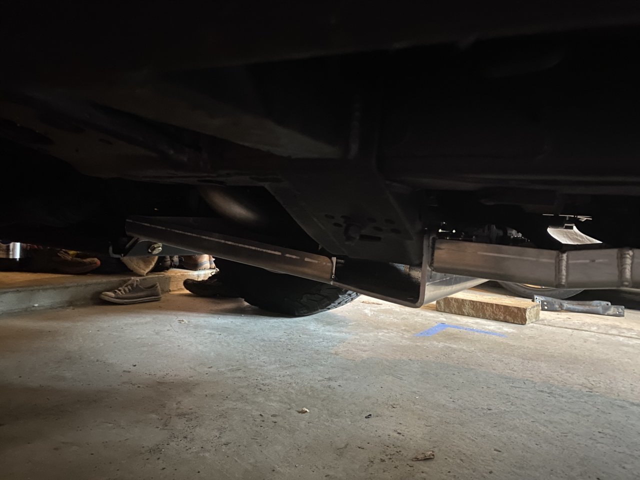

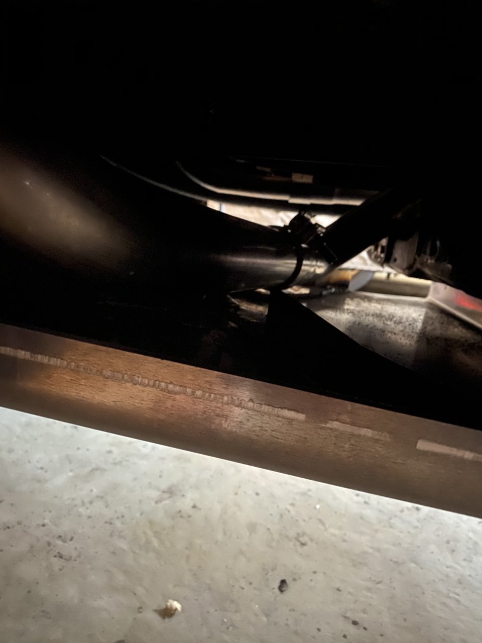

  16. Mar 25, 2020 at 1:01 PM
    #256
    smiles2
    smiles2 Well-Known Member
    Oct 9, 2017
    #232453
    189
    2017 Blue Tacoma TRD Offroad
    Anybody have issues installing the trans skid plate with a urd y pipe?
  17. Mar 25, 2020 at 1:07 PM
    #257
    fatfurious2
    Jun 28, 2014
    #132884
    49,912
    David
    Ashburn, VA
    2010 TRD OR Access Cab
    the URD Y pipe goes around the trans.. do you have pictures?
  18. Mar 25, 2020 at 1:13 PM
    #258
    smiles2
    Oct 9, 2017
    #232453
    189
    It goes in front of the trans. I had the braces put on the skid and I had to cut sections out of them because It wouldn’t go up and it’s still a half in to inch lower that’s the crossmember.CBB819A1-74D1-4E12-BA6D-E5C6BE178CF5.jpg 0586A998-521D-4604-A596-DD368636D4F3.jpg
  19. Mar 25, 2020 at 1:35 PM
    #259
    EatSleepTacos
    Mar 24, 2015
    #151688
    59,846
    Randy
    West Valley, AZ
    2017 4Runner
    The trans skid sits perfectly flush with the cross member. If that urd pipe hangs below it at all it’ll interfere. It looks like you need to cut more of the bracing out.
  20. Mar 25, 2020 at 1:38 PM
    #260
    smiles2
    Oct 9, 2017
    #232453
    189
    That’s what I was thinking.
