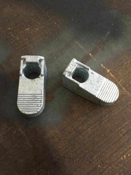

    Maybe, but why should I, the customer, have to figure shit out. A simple piece of paper with parts list, where to use them and a couple of fucking pictures should be included with the hardware.

    These are the beam clamps to pinch the frame mentioned by @jowybyo
    I believe he meant 'pinch' here instead of pitch. I can assume with some certainty, because my Mobtown sliders used similar, if not the same, clamps on the rear part of the frame
    Edit: Step #15 should help you out with the function of the clamp.
    http://mobtownoffroad.com/wp-conten...oma-Rock-Slider-Installation-Instructions.pdf

    Thanks @neegra, this helps. Much appreciated.

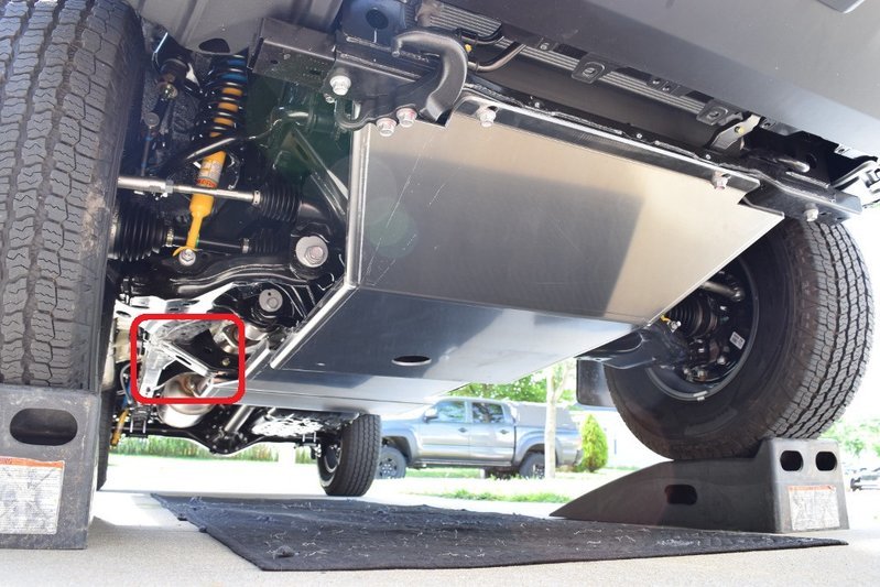

    What does this mean? They offer 1/4" Aluminum skids. They should function reasonably offroad, not as good as the steel but are half the weight.

    Given the type of debris and shape (hardness and pointy) and with force, aluminum can puncture and tear with relative ease. Not great for abuse. Especially repetitive! ( I now find myself writing things like I am explaining them to my 3 year old!)

    I think we all know this, but it would take a pretty good amount of force to puncture 1/4" aluminum. Considering most people don't rock crawl and are mostly traversing fire access roads, overlanding, and the occasional state park. Aluminum is fine.

    Yeah, the Mobtown alum plate has some beefiness too it. It looks like it'll bend or dent/gouge up before it'll tear or puncture. It's a solid 25 pounds and 1/4" alum plate.
