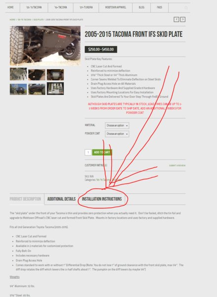

    I would suggest a link on the product page (the page where the product is shown), I still haven't found the instructions on the site, except by following a link I found on this forum.
    And, as one who builds and sells product to the public, I know that instructions are a pain in the ___! There is no crack in the sidewalk narrow enough for some to step over, and when it is something we deal with on a daily basis all too easy to forget about when creating instructions!
    www.rltco.com
    Ray

    Been there for about a year.

    First: Skid plate mounted like a dream - Mobtown is doing a fantastic job, everything lined up perfectly! Very nice job guys!
    On the instructions - evidently my browser/monitor doesn't extend to the bottom of the page, and if others haven't noticed the instructions at the bottom of the page perhaps I'm not the only one to look beyond the "main attraction". Perhaps just move the instruction tab to the top, or alongside the information??? However, I have to say I was very impressed with the build quality, and how well everything lined up and bolted on.

    Also, we discussed yesterday and we all agreed internally that the tab should go on the main page moved up top for more visibility.
