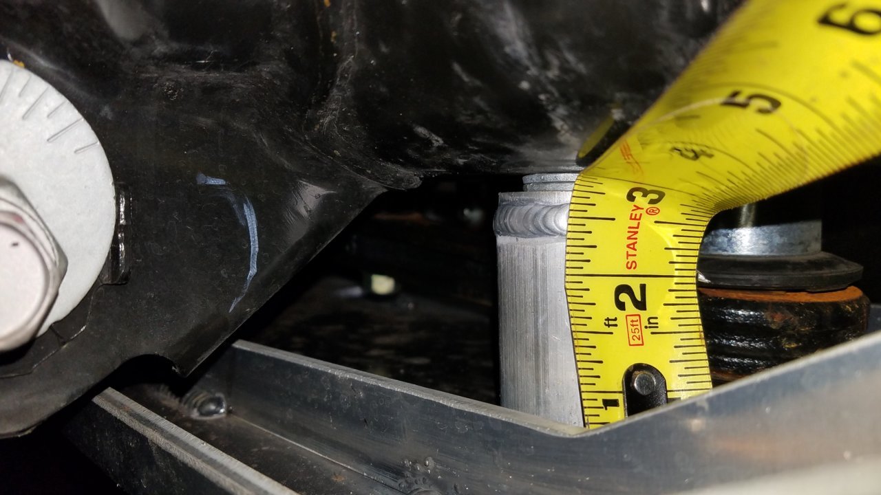

    I was installing my front skid plate this afternoon driver side middle bolt won’t catch the threads. Do you guys have any idea how I can fix this?

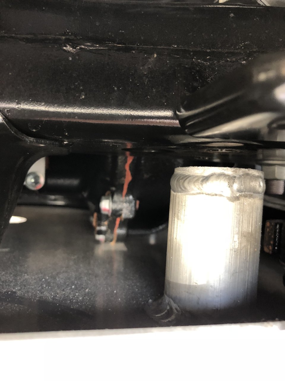

    Just got done trying that here’s the problem I’m running into

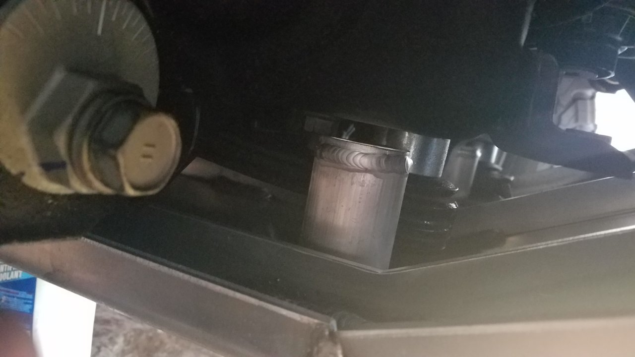

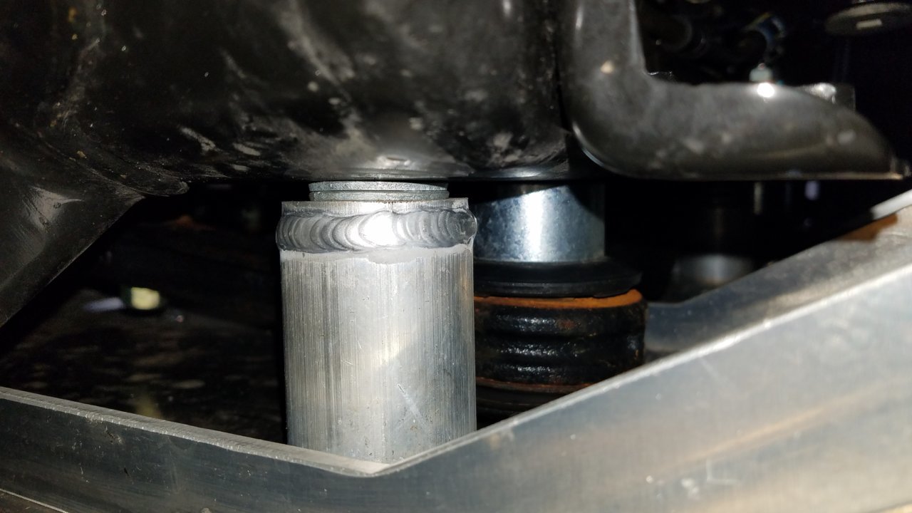

    Looks like its hitting the diff? Mine did the same thing but thought it was a fluke thing. I used large galv washers so I wouldn't have to send it back but mine wasn't that much and I had plenty of threads catching. I contacted them but they never had that problem. Now twice? Here's mine.

    How big of a diff drop do you have?
  14. Apr 8, 2018 at 3:21 PM
    #174
    lpfe42
    lpfe42 Well-Known Member
    Jul 2, 2015
    #158633
    404
    Kenny
    Santa Barbara County
    20 DCSB CEMENT
    5100/887 Icon uca
    1’’

    That is odd. We've shipped hundreds with no changes but you're the third person to have it hit...
    Is the plate installed? If so, can you remove and give me the height from the plate to the top side of the post that is to short? That is the only thing that could have happenedz those tubes were cut to short.

    I will get you measurements on mine but I used washers to make it fit and it was both sides for me.

    2 3/4
    Ill give you guys a call in the morning about this

    Mine is the same but not pulling mine.

    That photo is your passenger side correct? My passenger side works perfectly driver side is about 3/8 of an inch too short to even grab a thread
