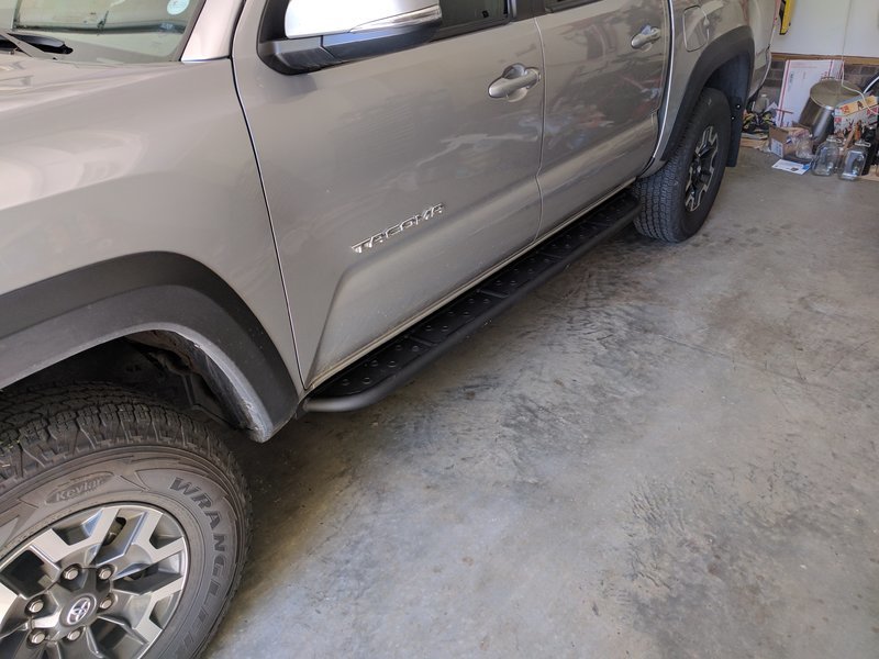

    Set the slider on a milk crate and tilt and slide it under the truck.
    Then jam a 2x4 between the slider and the milk crate and the slider is now pushed right up against the frame,
    milk crate slides around easy on the wood paneling shown in the picture for lining up bolts with no effort.
    On the front of the sliders (where the frame is boxed) don't forget to get the plastic clip out of the top of the frame.
    I found the instructions made more sense when I had the slider sitting on the ground under the truck.
    Driver side took me about 1-1/2 hrs (figuring out where the clip went into the top of the frame and then getting it out, then figuring out the front box assembly and getting the bolts through the top bracket, slowed me down).
    Passenger side took only 30 minutes.
    Joe must have his jigs set just right as they fit like a glove.
