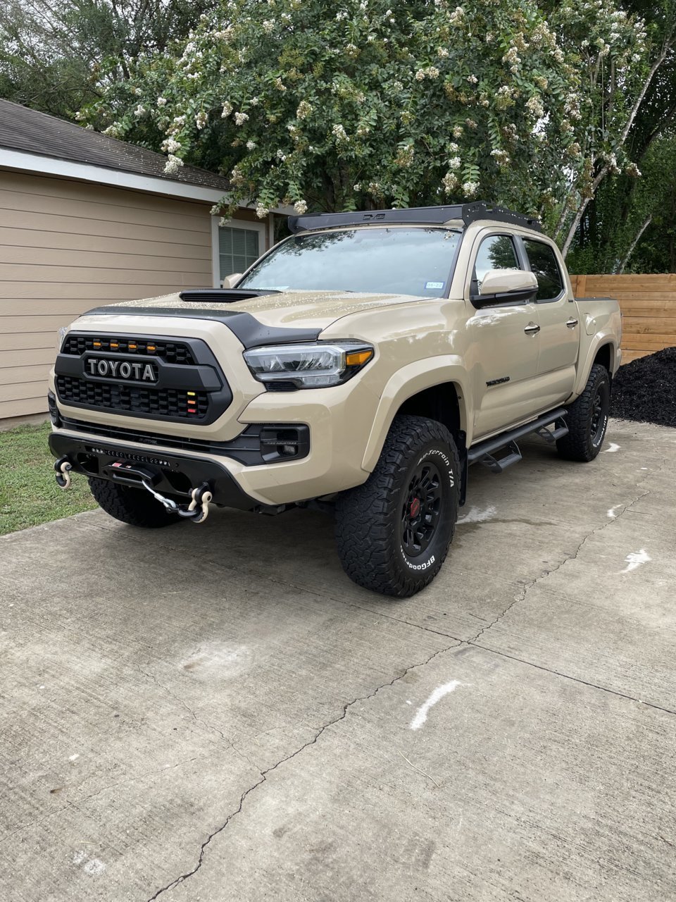

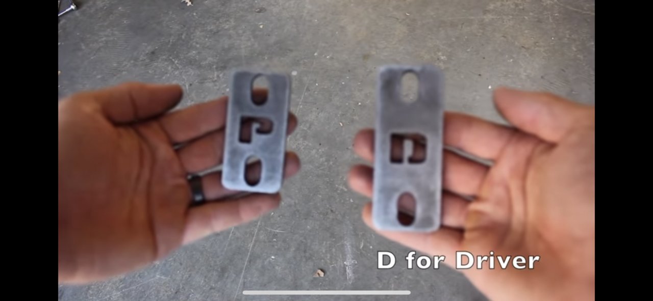

    Edit for others who are thinking about this set up. You will need two power steering cooler relocation brackets to fit the winch.
    My order did not come with these brackets so definitely get a pair from CBI before you install.
    Also I did not remove the grill or bumper I imagined the lower valance as a guide and used an angle grinder to make the cut.
