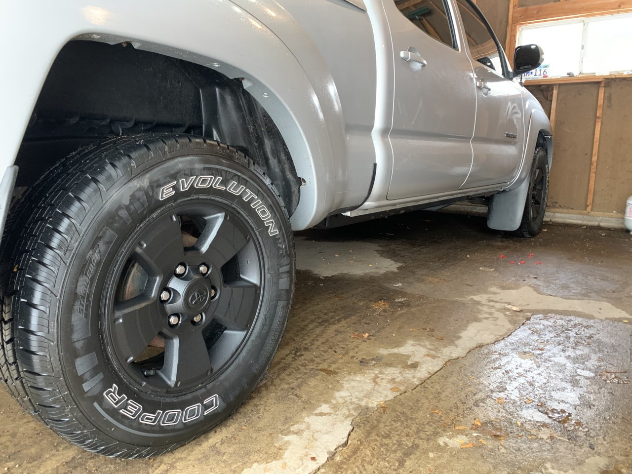

    This will tide me over for now, I’d really like to get the TRD rims though.6D1D0FE0-83A9-4ED1-BD4E-398062FDE025.jpg

    What product did you use? I have the same rims and want to do the same thing. Any special prep involved?

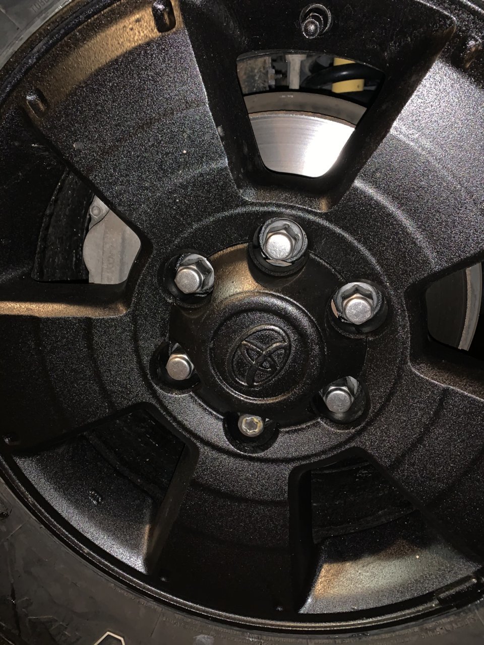

    looks good, got any close up shots? curious how the texture looks in detail

    Open to any, would need to see the pictures though.

    Herculiner Aerosol. 2 coats on top of rust o lean gray self etching primer, also 2 coats. Cleaned and sanded the wheels before hand.

    How many cans of each product for 4 wheels?

    2 primer and 2 1/2 liner. I did the inside and outside of the wheel, and caps
