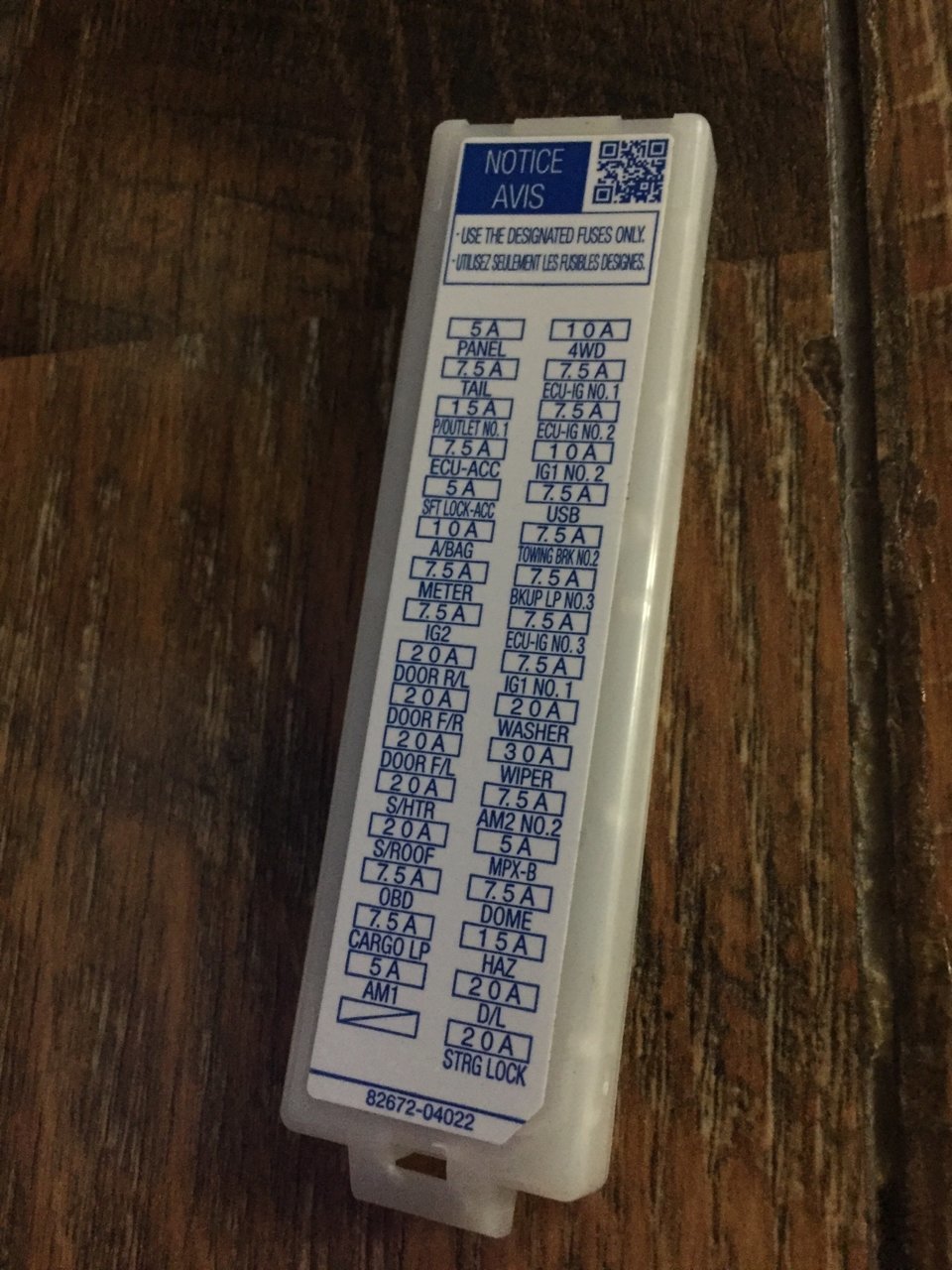

    Might be a long shot - looks like this thread is dead.
    Im looking to add a 12V socket inside my center console (2019 TRD Pro Tacoma)- to power a Midland radio- so I need the full monte.
    My only point of confusion is do I pick any given 7.5 fuse to place the add-a-fuse too? Im tracking pretty much everything else - just want to make sure.

    Cargo and Dome are acceptable.

    Thank you!!

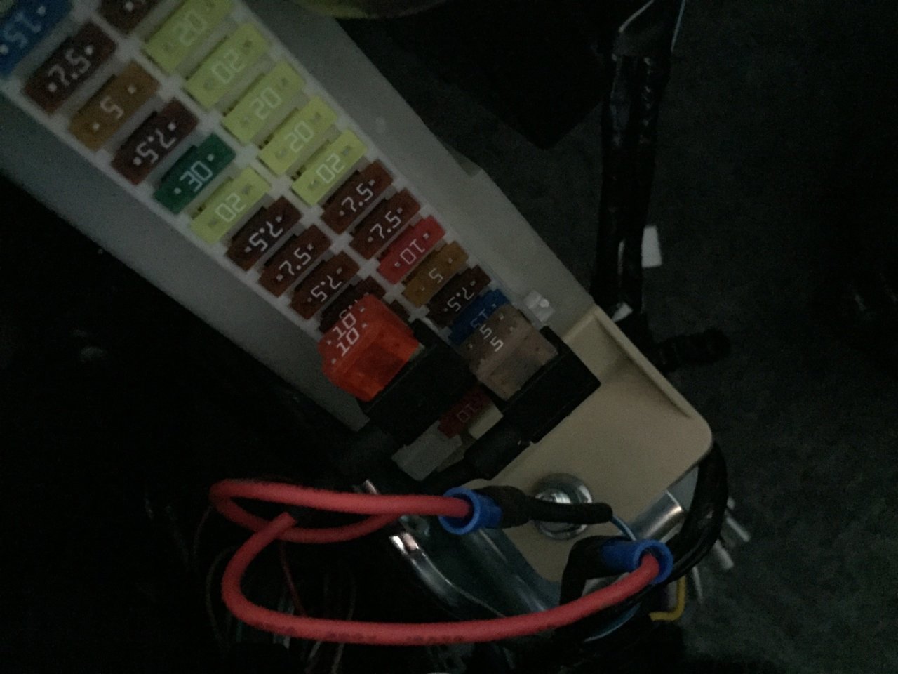

    Do you have any problems overloading the circuit with multiple devices plugged in?

    No issues so far. I tapped into the dome 7.5 fuse, with a add-a-fuse then loaded it with a 7.5 and a 10 amp fuse, and all is well.
    I wouldn't suspect much if any issues from this, unless you are double stacking add-a-fuse's.
