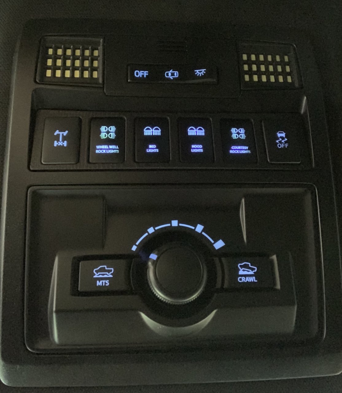

    Well I swapped my Dark Blue CH4x4 Green LED Circuit Boardsu for some NEW Blue AOB Green LED Circuit Boards Today!
    I have to say I’m a HUGE fan! I have two more that I plan on attempting to switch out the actual LEDs from one to the other. I’m not going to be able to switch the circuit boards in those bc one switch is momentary and the other is on-off. However, I was glad to get these done though and see how they turned out. I highly recommend doing this. It’s a nice touch

    Looks perfect. Any details on resistors and bulbs? Are these pre-made boards or did you make these?

    I just purchased the AOB Switches and swapped out the insides of them and the insides of the CH4X4 switches. I kept it simple.

    I’ve had my CH4x4 switches for like 2 or 3 years so I just figured I’d try to see if I could switch out the color. I didn’t care for any of the AOB switches for what I needed in those spots and it worked. They had the Rock Lights, which I did get and almost used. I also purchased the Bed Lights one but it’s kinda weird having an actual Bed but I did get it just in case I want to use it later. We will see later on
