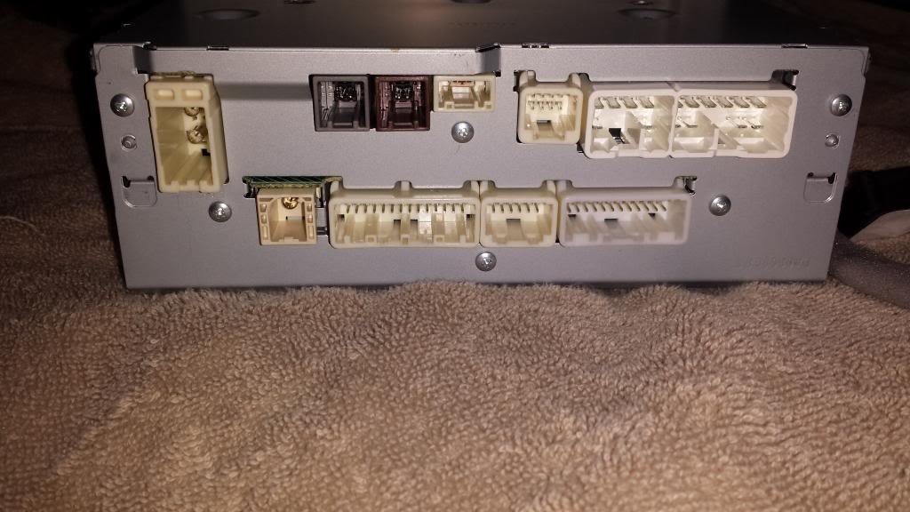

    The harness from eBay?
    Because I bought it and it wasn't plug and play with the 2014 unit. It was for the old 2013 unit I had before tho

    So looking at this new 2014 radio Jerez I believe the back up cam is the bottom most right connection. Would you happen to know if that true. If it is That connection on the 2014 has 4 wires, Black with silver dots, Red with silver dots, White with silver dots, and Plan Black one. If that is the back up cam connection to get it to display on the screen would you happen to know what each wire is?

    yea but that doesnt mean i have time to mess with it tho :pout: lol
    i believe youre right about the location...but like i said i havent had the chance to look for it or into it :eek:

    I been trying to find somewhere to get information on that but I can't seem to find anything. Although I don't get much time to look. If i had to guess though I would assume they are like many other camera kits. A turn on, Ground, and Display. I'm just trying to find which is which. Only if I was able to be able to mess around with the new 2014.
