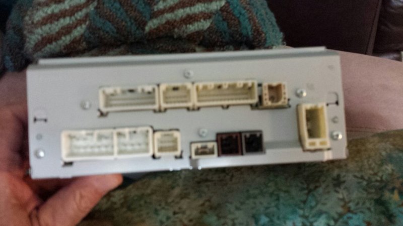

    Is this the correct set of controls? It concerns me that it says it's for a Tundra. I've also seen these in my research, but these are not the ones I have seen in the Tacomas that come off the assembly line equipped with all this stuff, plus the "Tundra" ones look better.

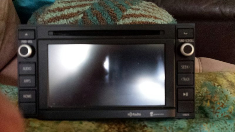

    Im sorry, I had the wrong picture at first and then I updated, so I thought. I will 100% guarantee that it is from a 2015 Tacoma. I bought the truck brand new and immediately removed the stereo and sent it to my father, who decided he didnt want to install. I will get pics from him and upload asap.

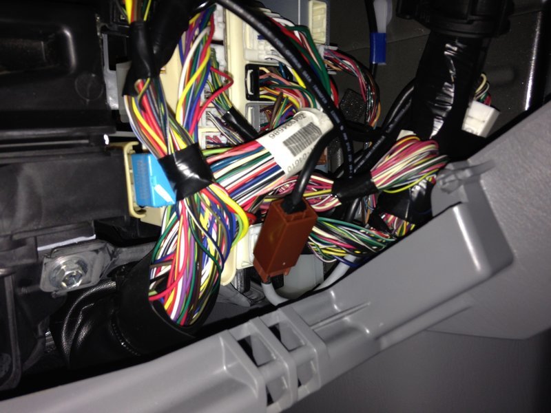

    You need three new cords to make it work. One plugs into back of radio, the other plugs into a cord that's behind your glovebox (it is plugged into a brown receptacle, you unplug the cord from that receptacle and plug it into your new cord). The third cord is a male to female usb cord to connect them together. I got a 3ft long one and it was actually a little too long, not sure if they make them shorter.
    Here's the two cords you'll need. The one with the grey end plugs into your radio, and the one with the brown end plugs into the cord behind the glove box. Then their ends are connected together with the USB cord. This gives you full USB functionality.

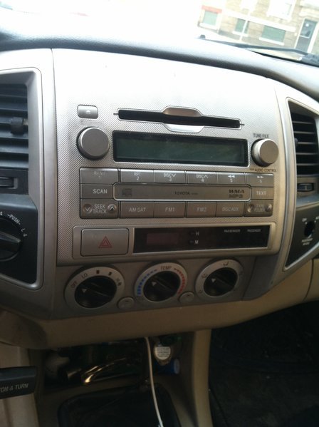

    image.jpg image.jpg Anybody now how I can go about this with my 2010 I have a 2014 radio and the plugs with wires but my wires are different

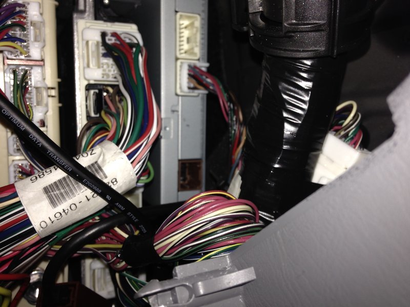

    Pics below. The first shows the empty brown receptacle that will have a cord plugged into it. You unplug that cord and plug the brown end of the EBay cord into it (plug the EBay cord into the truck cord, not the receptacle, it remains empty once you unplug the truck cord from it).
    The next pic shows the truck cord attached to the EBay cord.
