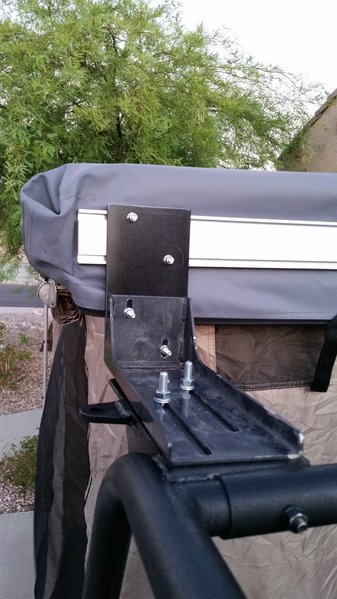

    I welded this little tab on the back of my awning mount that I found at Allstate Steel and it works great as an antenna mount. I just need to clear the paint from it when I put the antenna mount on it. I'm going to run the antenna cable down the rear tube of my rack with zip ties, then into a hole I'm drilling into the inside of the bed so I can run the cable forward to the cab through a grommet. If you're doing this type of install, you'll need the 18' cable. Always get in lengths divisible by 9'. Something about the math that makes it work better so tuning is easy.

    If you bend the antenna on the spring too far to tie it down flat, it will have some memory and stay slightly bent. I just unscrew my antenna when I'm not out on trips.

    The springs stay fine when they flop around and you run the antenna under a tree. It's just if you tie it down really far and bend the spring at a 90 degree for long. But, you can just bend it the other way and it will be straight again. Get a softer spring if you want more play, but then it will wag all over the place.

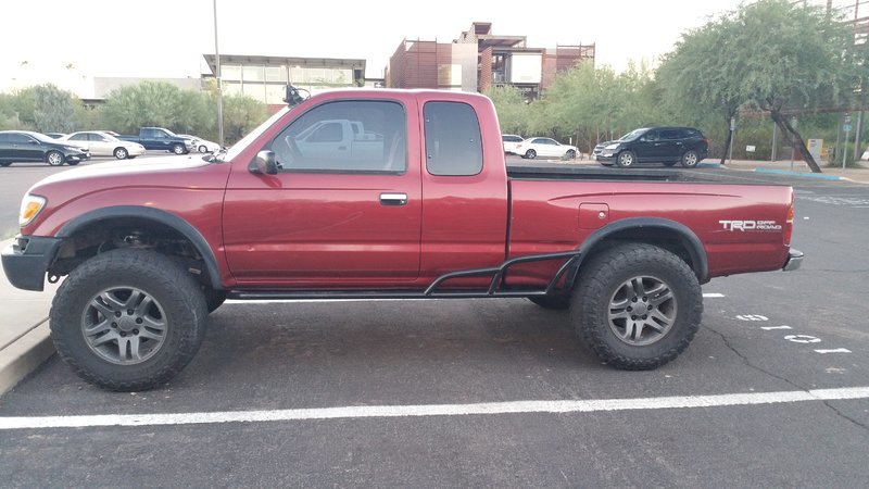

    Damn, I never noticed that it sat like that. Wow!

    Haha. I've always noticed it pretty bad. I know at work there's some pretty good slopes. My gf never noticed it was so bad until it was up in the air the other day at Avids.
