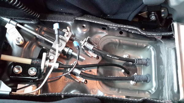

    There was two things I wanted to do in mod 2:

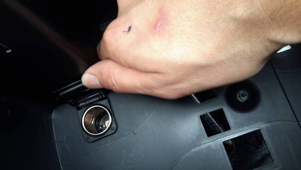

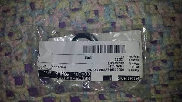

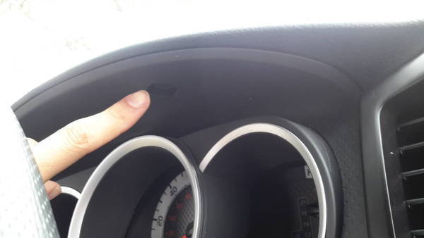

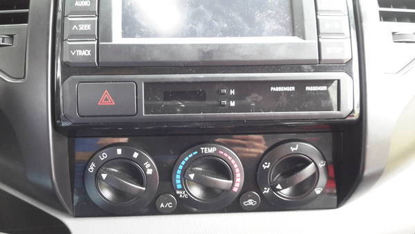

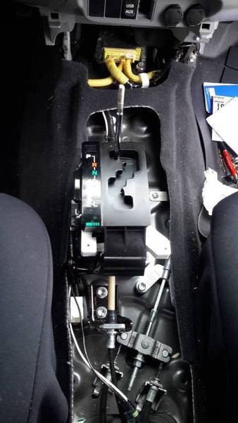

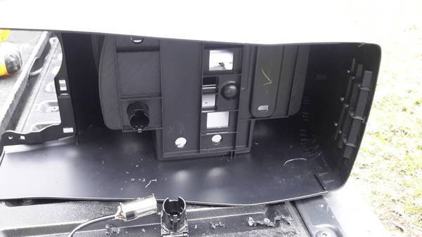

    1. The lid broke off my power point below the AC controls. I have this OCD to where I have to have everything clean and original in my truck.
    Picture 1:

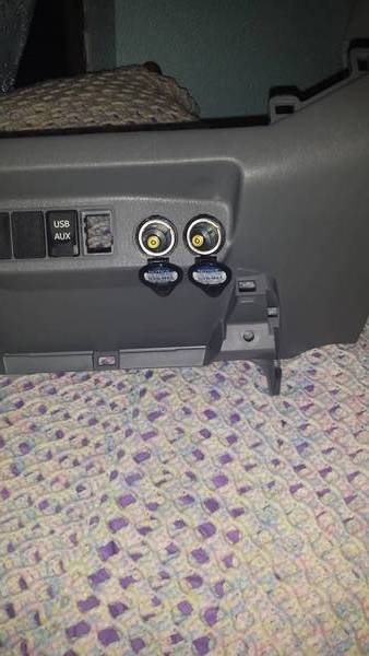

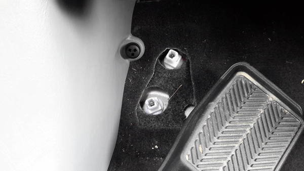

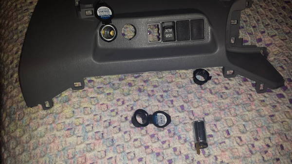

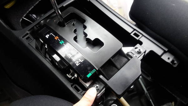

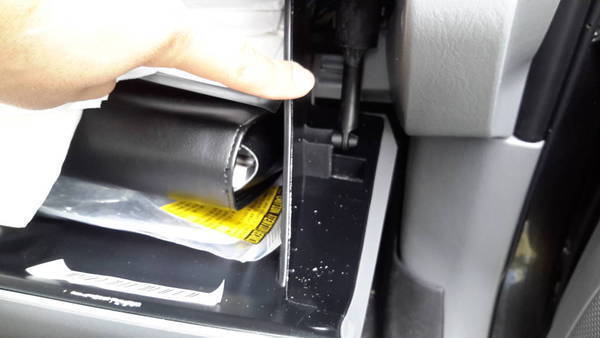

    Therefore I went to my local Toyota dealership and purchased a new power point sleeve.

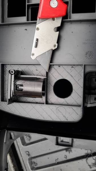

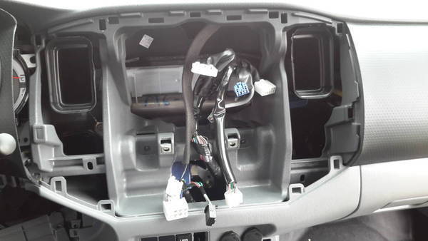

    Picture 2:

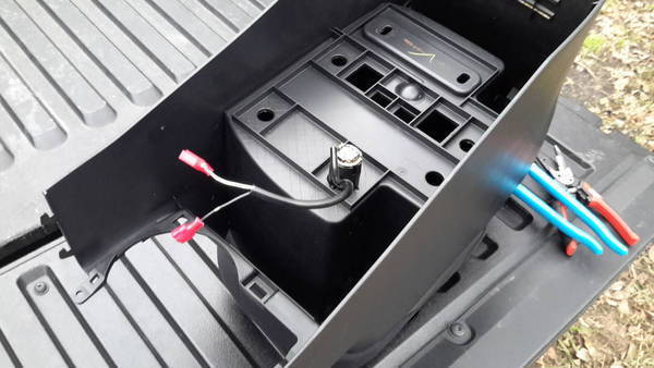

    2. I wanted to install a power point in my center console and have it look nice and clean.
    My 2003 Toyota Camry has a self closing power point in the center console.

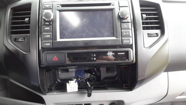

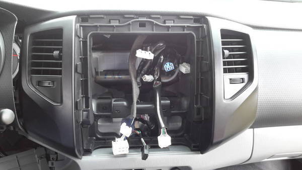

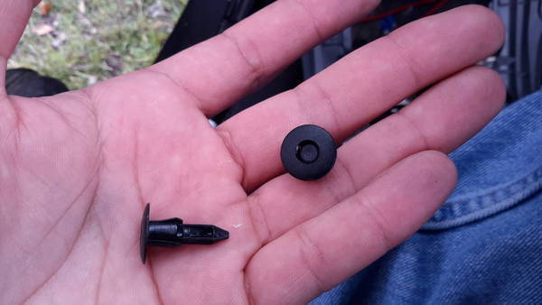

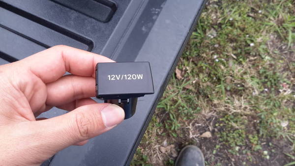

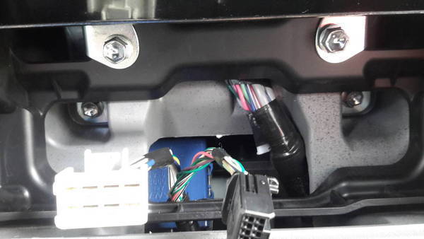

    So what I did is I purchased the power point assembly from a local junk yard and decided to install it in my 2013 Tacoma.
    While removing the power point assembly from the Camry in the junk yard, I broke the sleeve, so I went ahead and ordered one from my local Toyota dealership:

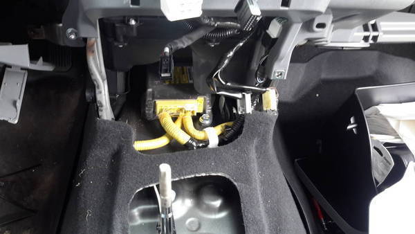

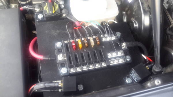

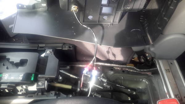

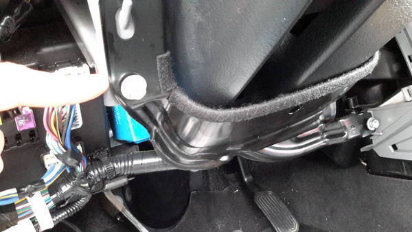

    This was the part number:

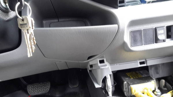

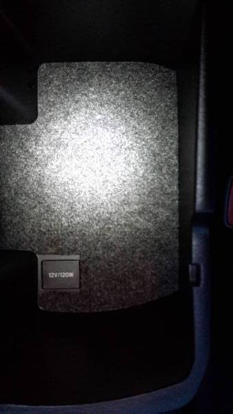

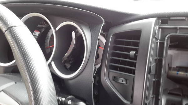

    Picture 3 and 4:
    Ok, now the destruction begins!

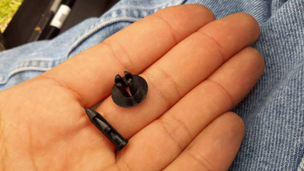

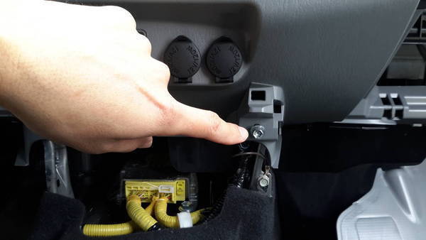

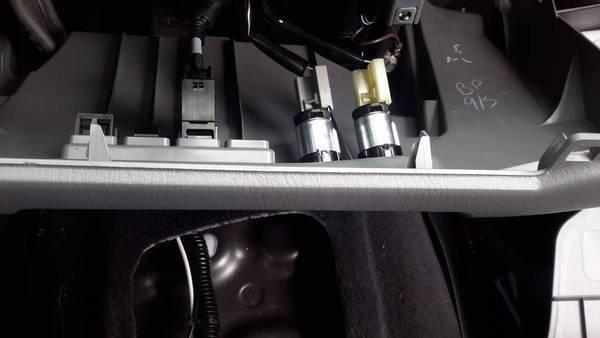

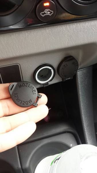

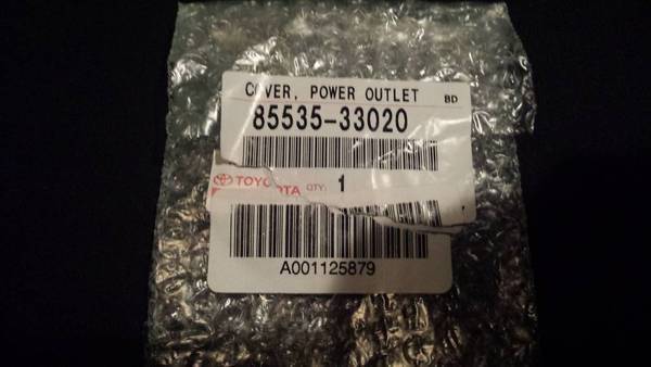

    I went ahead and opened up my center console and emptied all the junk out. I pulled out the little mat at the bottom, and using a 10MM socket and ratchet I undid the two bolts that were at the bottom.
    Once I did this, I pulled out the cup holder that is closer to the AC controls. It's in there pretty tight, but I pulled on it hard enough for it to come out. Its set in there with four clips.

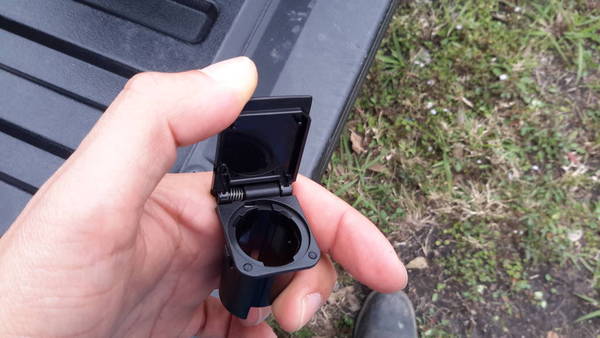

    Picture 5.
    At this point, I was able to stick my hand down there and pop out the plastic cover that has the other cup holder directly in front of the center console. (Remember to unscrew the shift knob)

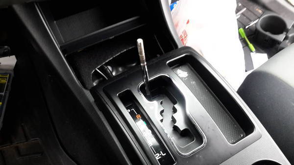

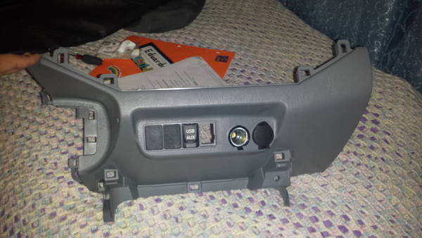

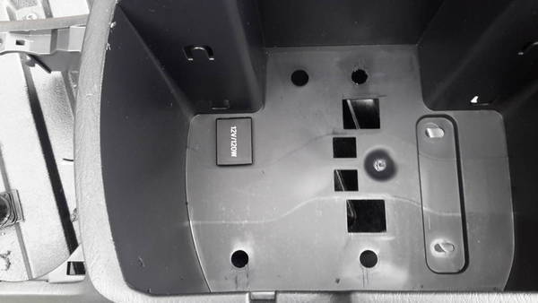

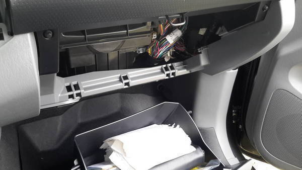

    After this, I pulled out the center console housing by removing two little black screws (seen as empty screw holes in picture 6). Then I removed the screws that hold the shifter housing to the shifter assembly (pointing with my finger).

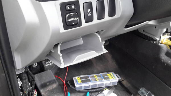

    Picture 6.
    This section now pulls out and the center area will look like this.
    Picture 7.

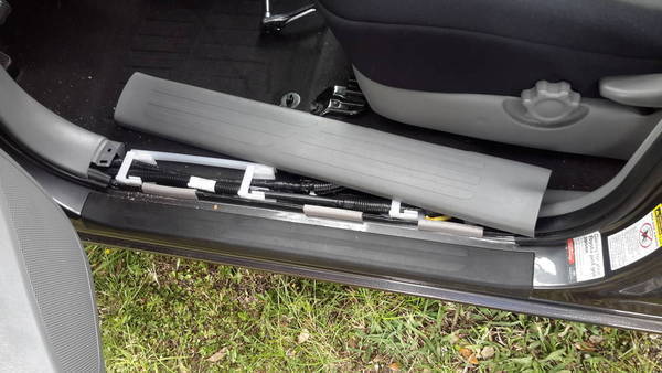

    Now in order for me to remove the center console that holds the power points below the AC controls, I have to remove the radio head unit face plate.
    That comes out by taking the following steps.
    I popped out the driver's door bottom plastic foot plate. This is not held down by screws, so I used a small screw driver to start it and once it popped off, I used my fingers.

    After the glove compartment is set aside, I am able to FINALLY pull the head unit faceplate out! This is being held down by clips only.
    Picture 25
    Picture 26
