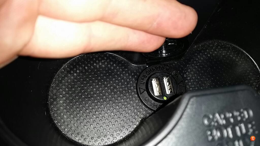

    Blue Sea water resistant USB outlet. I have had one exposed to the elements in the bed for the past 6 months, works flawless and has seen far more than any condensation you can throw at it.

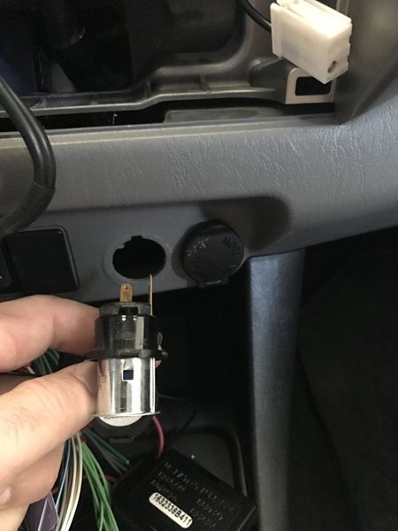

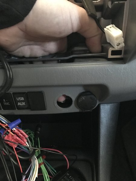

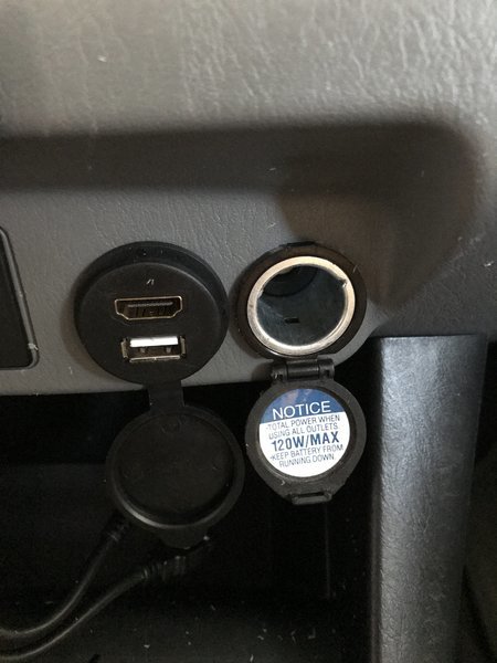

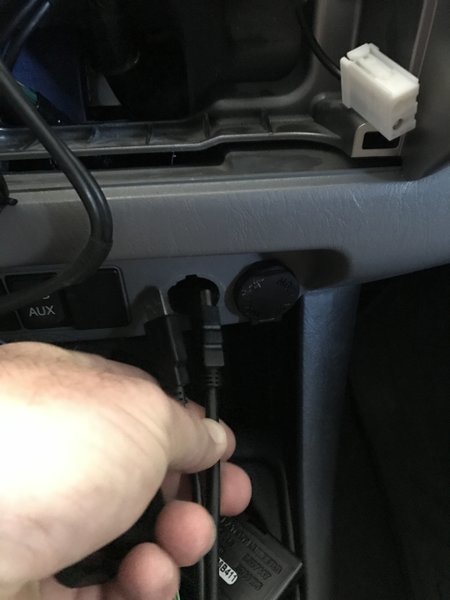

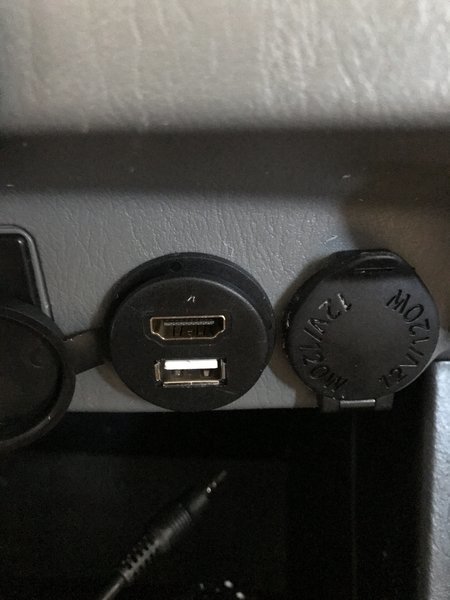

    I just installed a new Pioneer Deck and I wanted to add a new HDMI / USB port to the lower part of my dash. After seeing this thread however, I was a little intimidated! But luckily, with having my stereo removed, I was able to remove 1 12 volt receptacle and replace it with this...
    https://www.amazon.com/gp/product/B00VAJ76SE/ref=oh_aui_detailpage_o07_s00?ie=UTF8&psc=1

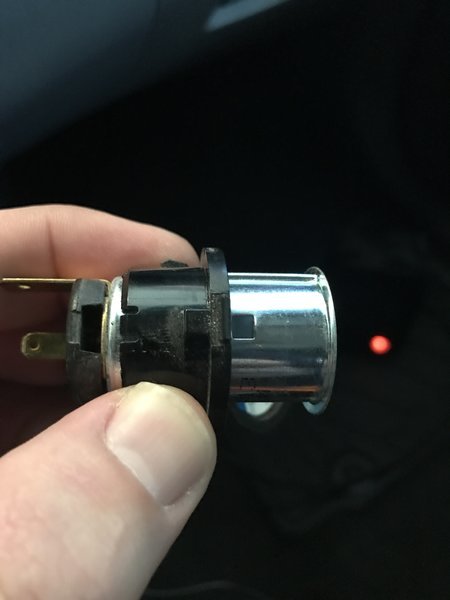

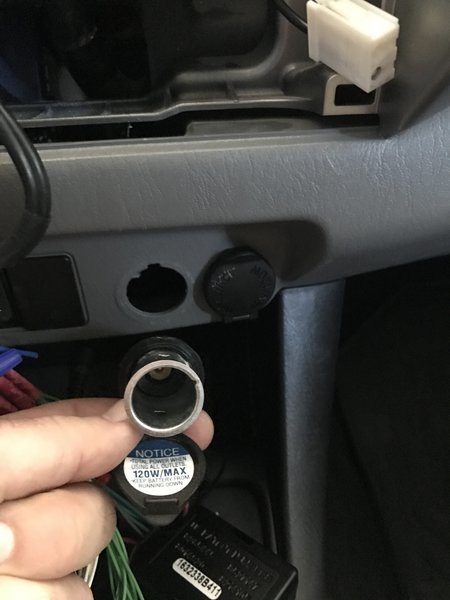

    The 12v receptacle has 2 pins on it that need to be pushed out. I used a small screw driver, but almost anything would work.
    This is one of the small openings you need to push a clip out of. There is an identical opening on the opposite side. Once you push on the pins, the (silver) metal insert will slide right out of the dash. I was able to fit my hand behind the 12v adaptor and help push it out.

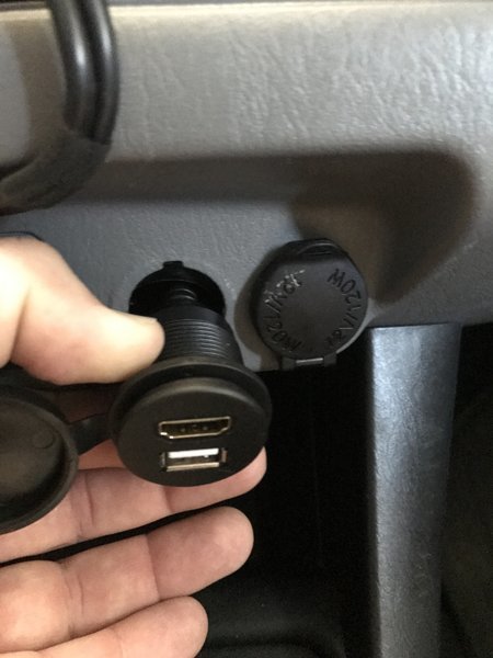

    I did not remove the stock wiring adaptor, instead I just left it alone and installed my new HDMI adaptor. My thought was if I wanted to ever switch back to stock, I wanted to be able to do that. Unfortunately the new adaptor is 1/8" larger in diameter and I needed to use a Dremel to enlarge the opening. I went slow and was very careful to only enlarge it a tiny bit so that I would still be able to switch back to my stock 12v adaptor.
    Once I enlarged the opening, I threaded the cables from the front of the dash to the back. It consists of 1 USB and 1 HDMI cable.
    To secure the new adaptor in place, there are 2 nuts that thread on the back. One is larger than the other and it is TOO large to fit in the small space. I used the smaller nut first, then the larger nut which seems to work great.
    Here is the finished product.
    Hopefully this is helpful! This method of repair would totally work if you wanted to replace the cap on your 12v receptacle also.
