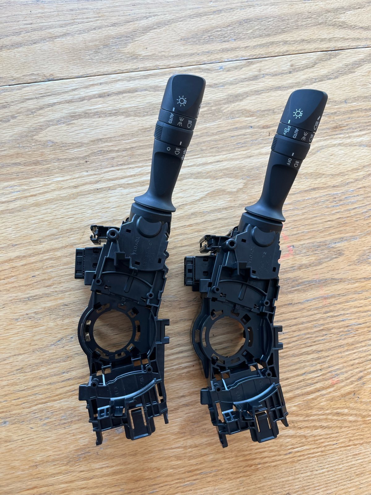

    First, thank you to @Okkine 2.0 for starting this thread. I also live in Canada and while I agree with the Canadian law to require automatic headlights generally, I was hoping they would have an OFF override. No such luck. I too on occassion want to have the headlights off, for a number of the reasons mentioned above. I thought I would embark on an adventure to add the DRL-OFF feature in my truck and purchased the US light switch (part number 84140-0R010). Unfortunately, I did not read this thread until after I installed the US light switch... and the DRL lights are on in both AUTO as well as DRL-OFF.
    As mentioned above, there ECU must use the light sensor to turn on the lights regardless of the status of the light switch (AUTO versus DRL-OFF) on Canadian model Tacoma's. I drove a rental Tacoma in the US this week and the DRL-OFF switch worked exactly as it should have. I traced my pinout of my Canadian light switch (thanks to @caribe makaira for posting the wiring diagram. I verified this pin out to make sure the Canadian light switch worked in the same manner.
    Has anyone checked to see if this can be tweaked in the ECU to make the Canadian ECU function in the same manner as the US one, with the Techstream software. Thanks!

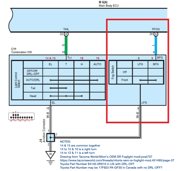

    @rboonstra , removing the connector to the light stalk switch, turn vehicle on and verify "Canadian Lights" turn and stay on. Just a test.
  15. Mar 11, 2024 at 3:34 PM
    #55
    rboonstra
    rboonstra New Member
    Mar 8, 2024
    #445500
    3
    Rudy
    2023 Red Tacoma TRD Sport
    Factory Lift Taco Gararage Dashtop MultiMount Amatuer Radios
    Hello @caribe makaira ... I was pretty sure I have a Canadian model, but confirmed it this afternoon. I took the covers off the steering column and unplugged the harness for the headlights / fog lights / turn signal. As expected, with the harness unplugged:
    • The DRL stayed off with the parking brake on. I have a manual transmission. If I remove the parking brake, the DRL comes on. If I re-apply the parking brakes, the DRL stays on.
    • If I start the truck with no parking brake applied, the DRL comes on right away.
    • This is the exact same behaviour (outside on a sunny day) with the US headlight switch in either AUTO or DRL OFF.
    I am hoping for a software fix... but in reading the forum, that is unlikely. The next step would be to take two small relays (or a dual pole relay) that have the coil(s) energized with 12VDC and the negative going to the AUTO wire of the harness, pin 19. In this manner, the relay closes only in AUTO. Use one set of normally closed (NC) contacts to break the circuit on the DRL relay. Use the second set of normally open (NO) contacts to activate the ambient light sensor. It may be possible to do this with a single relay.. but I need to find the wiring schematic for the ambient light sensor.
    I did remove the DRL relay in the relay box behind the battery under the hood (thank you @caribe makaira for posting in the "Trying to figure out Grille Lights" thread, post 8; it is the light blue DENSO relay as shown in the photo in post 26)... and the DRL turned off unless the parking lights were on or the headlights were on.

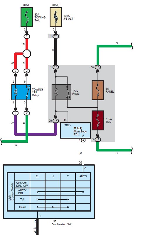

    As you have found out, the DRL is a separate circuit "controlled" by the parking brake. Fiddling with the light sensor is not part of the DRL. It was my understanding that Canada version also has the uncontrollable parking circuit with the DRL's. Would you confirm this?
  17. Mar 12, 2024 at 9:43 AM
    #57
    rboonstra
    Mar 8, 2024
    #445500
    3
    Rudy
    I was watching the parking / tail lights as well. The parking lights are on without control associated with the ambient light sensor (essentially the AUTO function of the light stock operates lighting in AUTO whether the switch is in AUTO or not present - same as DRL OFF). I will look at the ambient light sensor this week and see what happens when it is disconnected, as @Okkine 2.0 discusses above. Therefore, that is why I believe on needs two relays (one for the DRL relay to disengage and one for the ambient light sensor).

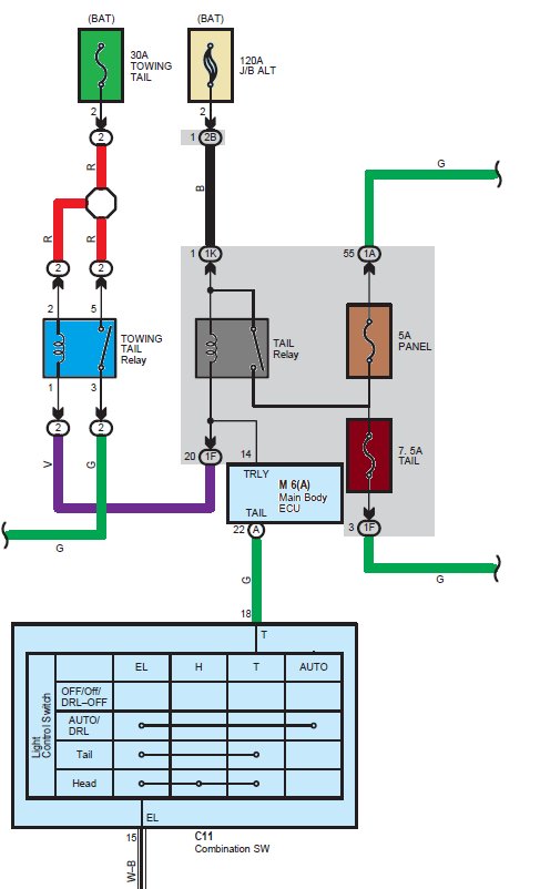

    Since your Canadian model has the parking circuit always on via Combination PCB, could you test the fogs ON with just the vehicle ON without selecting any position on the light stalk?
  19. Mar 12, 2024 at 10:45 PM
    #59
    caribe makaira
    caribe makaira Well-Known Member
    Feb 13, 2011
    #51121
    11,777
    Caribbean, Puerto Rico
    05 PreRunner TRD Offroad AutoTrans
    Hood Struts, My version Fogs always ON, Map & Overhead Light Mod,
