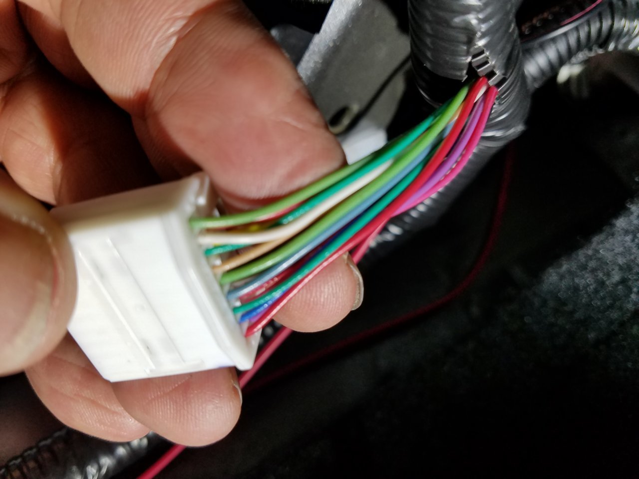

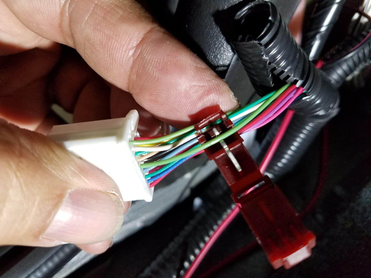

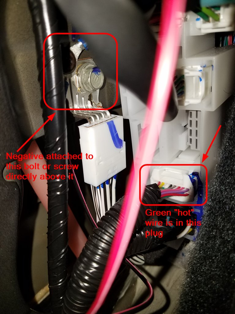

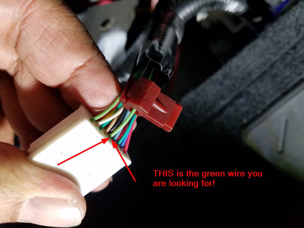

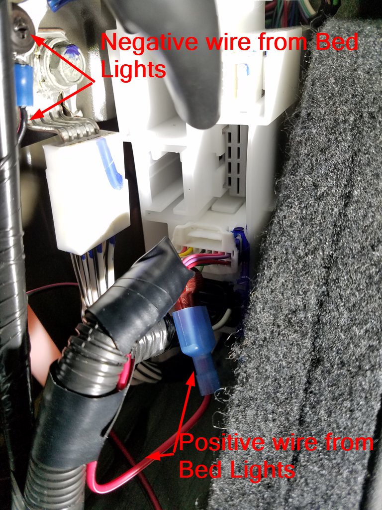

    Look at this thing, there are a lot of wires in it. You really would be working too hard to make a jumper. It's literally just the one green wire (+) that you need to tap into. Trust me, I'm not a fan of wire taps either, but in this case I added one since I felt the wire was too thin to strip and solder like I normally do. Here's the plug:

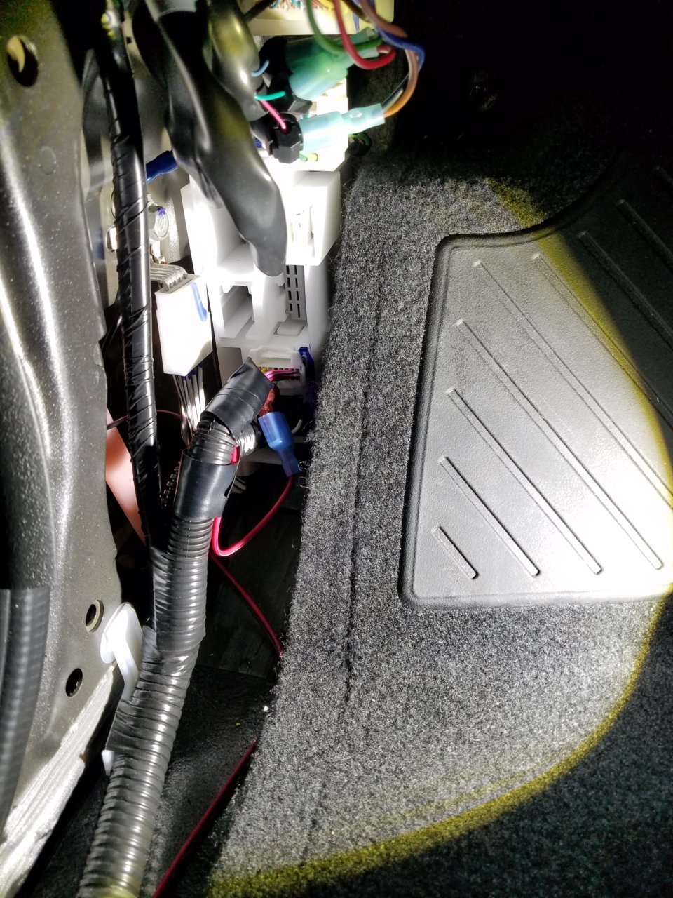

    Here's what the final product looks like - we are looking at the driver's side kick panel (it's off). Brake pedal would be in the upper right hand part of the pic, driver's door is to the left. You can see the red wire along the floor of the cab, that's the (+) hot wire from the bed light kit going up to the blue female spade connector clipped into the tap.
    Note the upper center of the pic shows OEM wire taps! If it's good enough for Toyota, it's good enough for me. :)

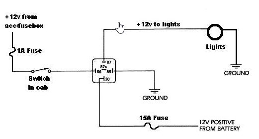

    I'd recommend Googling the proper usage of a relay. In theory, it should look like this:
    However, if you are not comfortable with wiring up your own relays I'd highly recommend having someone familiar with 12v car wiring assist you. Too bad you are in AZ, you are a drive for me or I'd help you out! :)
