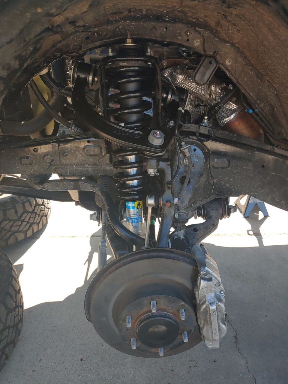

    If you do it the other way, removing the sway bar & tie rod, its way easier than removing the LCA and messing with the alignment to install the lift. imo.
    I have also done it the way in the video that's how I know, lol.

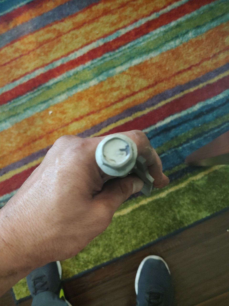

    Put a bottle jack under the LCA so it doesn't swing out quick. You're not replacing UCAs? UCA bolt is the hardest part.

    i have a secret for the UCA bolt. You cut about 1/3 of the flange off the head of the bolt. It'll slide right now. either hacksaw or file it down.

    I agree. I went that route as well and didn't remove my LCA.

    I used this video as my guide when I installed my coilovers and UCAs. I just bent the fender well back to get that uca bolt out, then bent it back after install. Video makes it look easy. Took me longer, but the video was spot on and a good guide for me.
