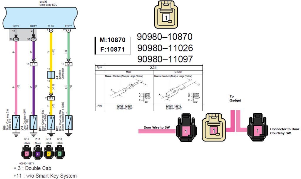

    If you have a key version, it is even easier, just separate the steering column cover and unplug a two wire connector that is at the bottom of the key cylinder. The chime isn't from the door, but from the key reminder system that chimes if you left the key in the ignition.

    Not sure what you're trying to say, but pink is for the rear door. You need the yellow wire for the driver's side door.

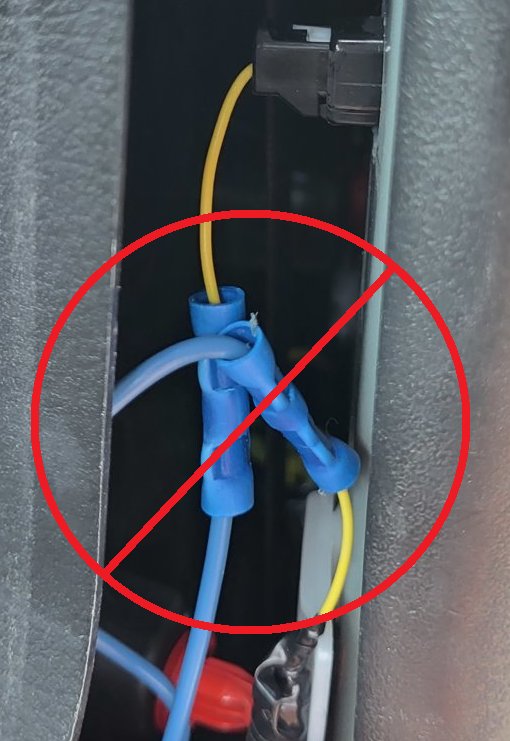

    I think Caribe is trying to say that butt connectors like that are trouble prone and will fail eventually.
    He also shows the part number for the connectors to do the same thing plug and play which looks and acts stock.

    26

    Oh! I was actually trying to find various connectors for this truck a few months ago, but didn't have much luck. I really don't like cutting factory wires...
    If I recall, I found some part numbers in the wiring diagrams, but couldn't find anyone who sells the ones I wanted. May I ask where you buy them?

    I believe those are Toyota Part Numbers that you can order at any dealer.
    Yeah, Caribe knows these trucks extremely well.
