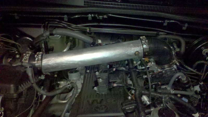

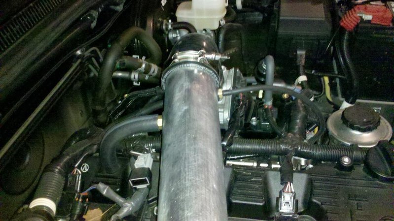

    Here's my setup very similar to crawl's old setup. I just left the air switching valve pressure sensor resting on the valve cover since it just monitors the valve with a vacuum hose. My pipe is a little longer due to tooter's spacer and you can see how I connected the two small hoses to the pipe. I plan to get some better rubber grommets, but otherwise I just have to take the truck for a test drive and hope the intake stays together under torque. If everything works nicely, I'll probably paint the aluminum pipe magnetic or anthracite grey for that extra coolness.

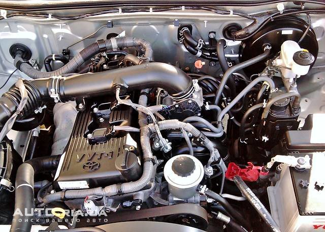

    The blob that the intake tube runs through that you guys eliminate, what is the purpose of it. Is it some type of expansion chamber similar to whats on a 2 stroke bike, or just for emissions?

    ^^all modern motors have these stupid little chambers and covers to suppress noise. I like noise on a motor :) The blob has no emissions or performance benefits, even though some people believe it helps smooth out the air flow...like a "tuned" intake. I dont buy into that theory because imo nothing matters until the air hits the TB and IM. Tube size and velocity are important though. I'm still working on that.

    this looks really nice! i need to get those bitchen t-bolt clamps.
    3" tube? and what degree elbow at the TB? 90*?
    also, it looks like you used barb fittings into grommets... I just shoved (very tight fit) the front vacuum hose into the grommet. but I keep checking on it every other day to make sure it doesn't fall out. maybe i should put some bubble gum on it ;)

    After driving the truck to and from work today (~2hrs), I can safely say I lost all low end torque. Maybe it's the 3in piping, but 2nd gear definitely lugs between 1100rpm and 2000rpm where as before I could accelerate easily starting at 1100rpm. I don't know how the 2.75in piping does, but please do not use 3in. I re-installed the stock accordion and valve cover baffle for now as I'm gonna look into the foreign counterpart to that valve cover intake piece.

    ^^ya.. I started with my 3" modded box, then went back to stock, and just recently decided to try the 2.75" tube. I'm still not happy.
    The reason I wanted to remove the stock piece in the first place was to have complete access to my spark plugs. Man... I wanna just throw some boost in this thing and call it a day.
