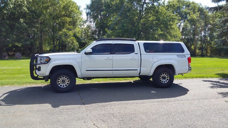

  13. Oct 21, 2016 at 12:39 AM
    SR5 BRI
    SR5 BRI Brian Good Sport
    Dec 29, 2015
    #173454
    1,435
    Brian
    Albany n.y.
    2023 Sport Quadcab
    Alot
    cr0[OP] likes this.
