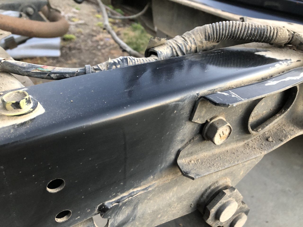

    Take a look on the West Coast. California, Nevada, Arizona, etc. Lot less rust issues here.
    I had 1998 SR5 v6 I bought with 445,000 miles on it, after I wiped the dust off the frame rail under the bed it was so shiny I could see my reflection in it. California truck.
