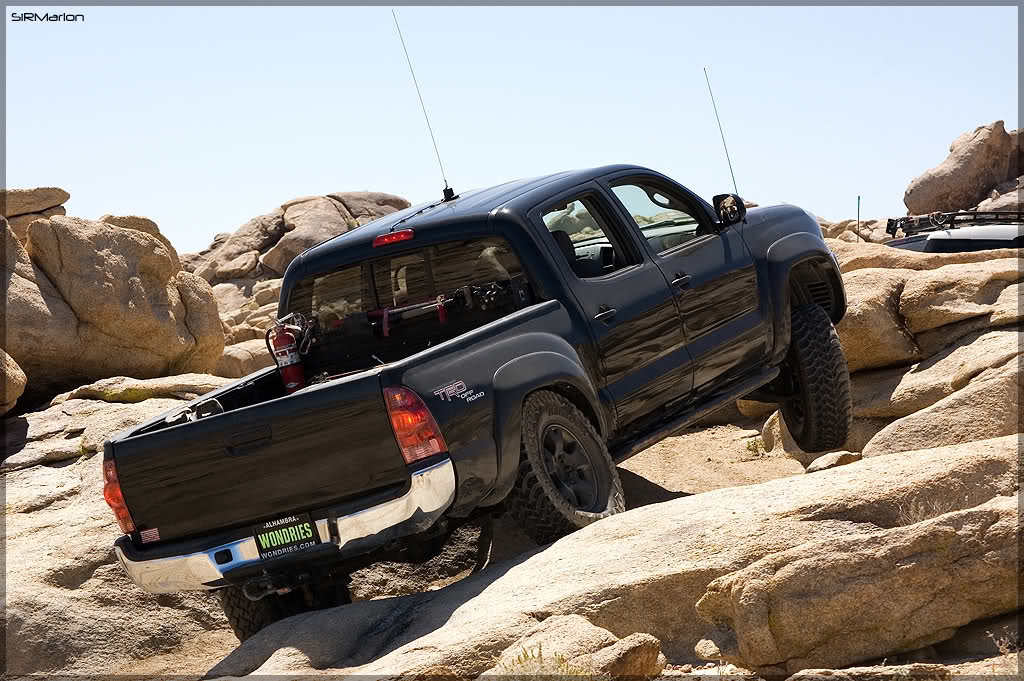

    my 5100's on stock springs served me well up to my current setup with the All Pro LT kit..i had them set to the max lift in the front, performance and feel was greatly improved over the stock setup. plus, they are a great value!! Sonny from DownSouthMotorSports.com can prolly hook you up on a great deal..and his customer service is highly praised as outstanding
    on 5100's in the front and TSB leafs in the rear in this pic...
