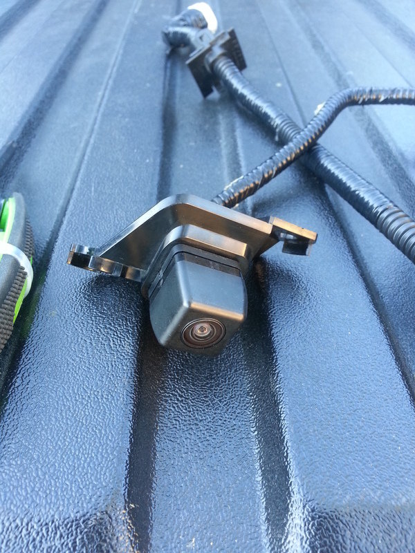

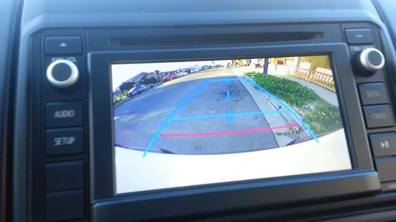

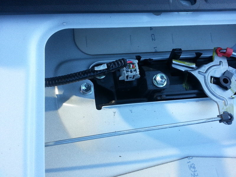

    Found an ad on craigslist for a taco tailgate with backup camera. Offered the guy $50 bucks just for the cam and BAM! I got OEM backup camera now! It was super easy to install because I was pre-wired for it!
    Took 20 minutes since i didnt have a T30 bit for my drill and now i have an extra harness because the guy gave me that too.
    Nice unexpected upgrade to get me even closer to the SR5 package which is $3200 more at the dealer.
    camera
    after taking off the 15 t30 screws and thats the blank insert the cables are plugged into
    Finished product

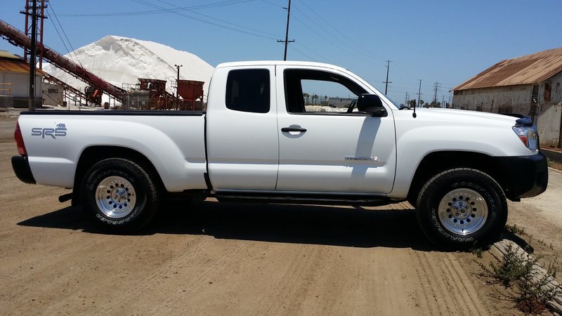

    I got new rims today, alloys from a 99-00 accord v6 for $100 on CL. Good condition with no curb rash:D but no center caps:mad:
    15x6.5 +55 offset and 64.1mm bore. I didnt weight the new ones but they felt at least half the weight of the steelies.
    The steel rims are like cement boots especially combined with 235/75/15 tires.
    BIG DIFFERENCE!
    I immediately felt a change in acceleration and pick up speed particularly on hills.
    Feels like a completely different truck now.
    I highly recommend changing to alloys for everyone, regardless of your tire size.

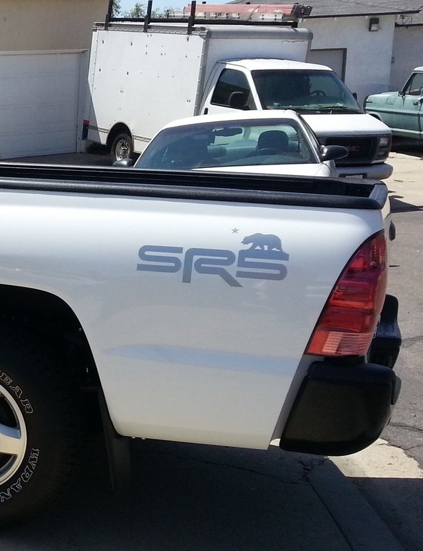

    New decal from RuggedT

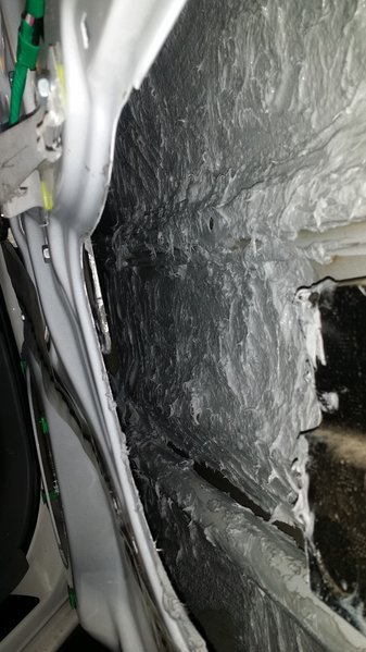

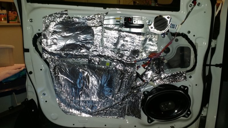

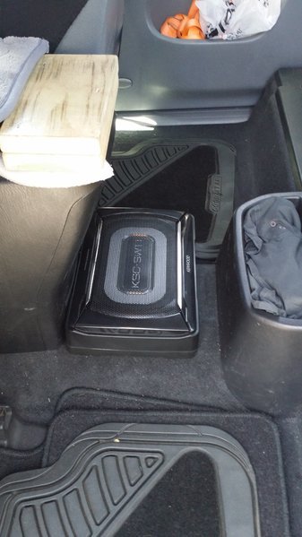

    Installed some audio stuff.
    Sound dampening.
    Water based duct insulation on the inside for panel. I just spread it on with my hands.
    Frost King peel and stick duct insulation on the outer panel. The JBL GTO938s installed already.
    My baby sub. Kenwood KSC-SW11
    Much better sound now:)
