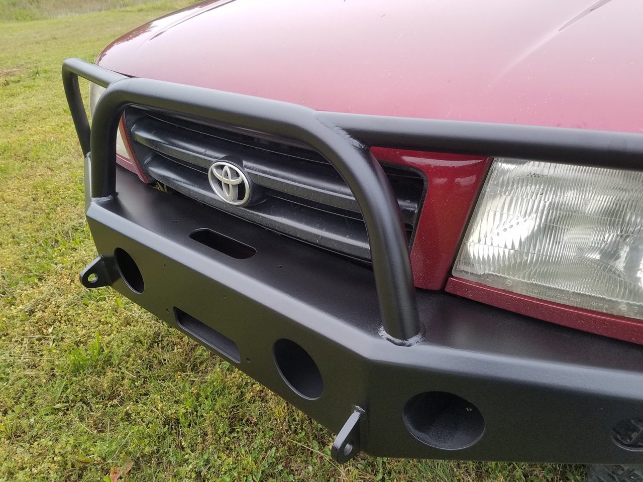

  5. May 22, 2020 at 5:52 AM
    #25
    rybern
    rybern [OP] Well-Known Member
    Apr 3, 2017
    #215281
    2,499
    N Alabama
    2025 TRD OR & 2000 SR5
    I'm pretty happy with final paint. Ended up with two coats of truck bed, then lightly sand to knock off the grit, then two coats of semi-gloss. Textured look but fairly smoothe to the touch and hopefully be easy to clean. ;)

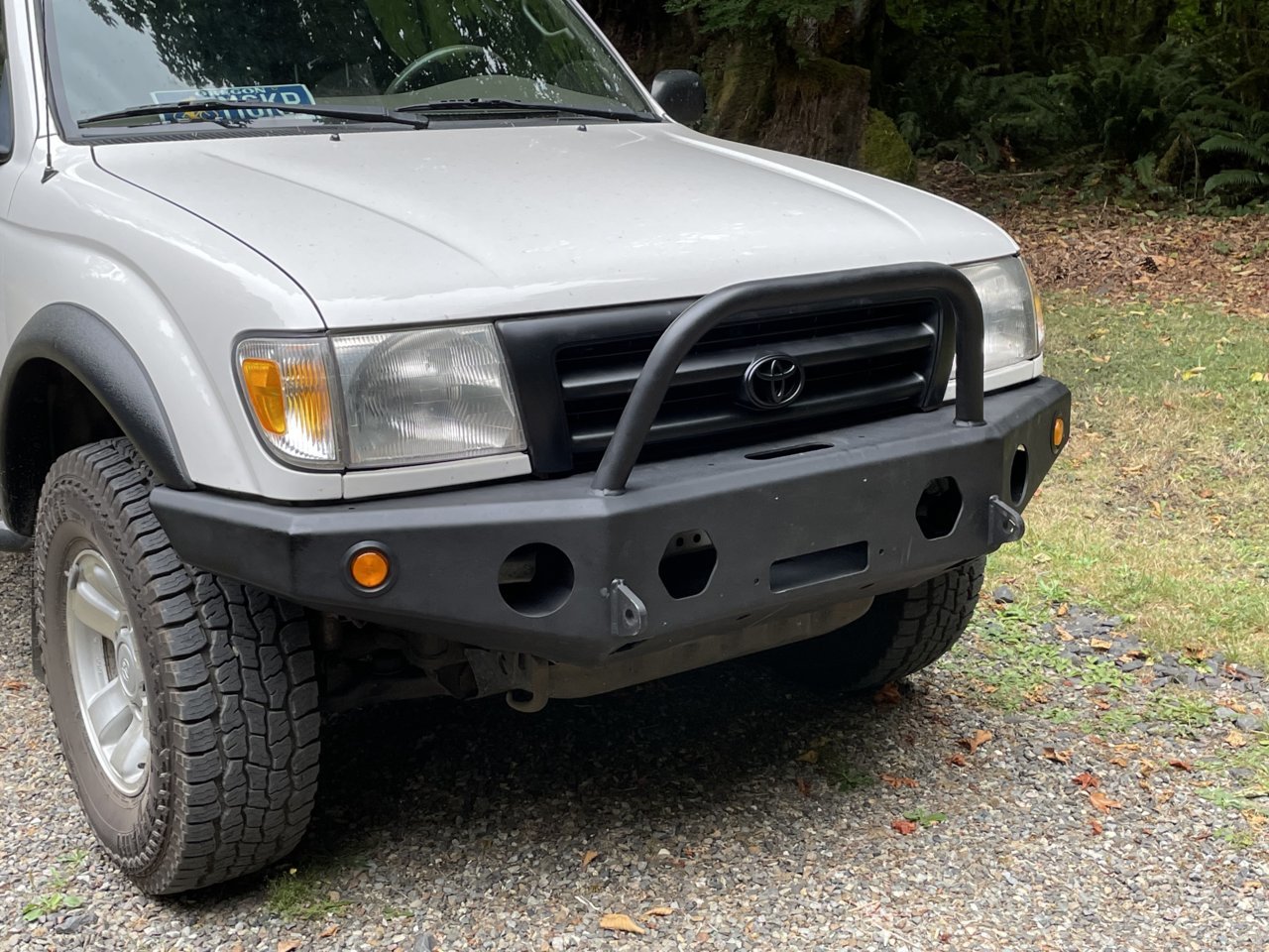

  6. Aug 24, 2021 at 6:59 AM
    #26
    JuniorVarsity
    JuniorVarsity I'm not a pickup truck guy. I have two.
    Jul 27, 2020
    #335797
    76
    PacNW
    1999 Tacoma SR5 4x4, 2021 TRD Sport Access Cab
    @rybern @Taco critter
    I just painted/installed my 4xinnovations front plate bumper; my experience similar (bumper well made/bulletproof, but no supporting instructions and bolt up required some massaging and creativity).
    Two questions for you guys:
    --what driving lights are you running?
    --what winch are you running? This is stumping me, as all of the 9,000-10,000lb winch's have a big control box that won't fit above the spool. Interested to know where/how you mounted yours before I create a new entry in the redneck diary. I know Adam (4xinnovations) has a list of "compatible" winches, but I think all of them have the same issue with the control box.
    rybern[OP] and Taco critter like this.
