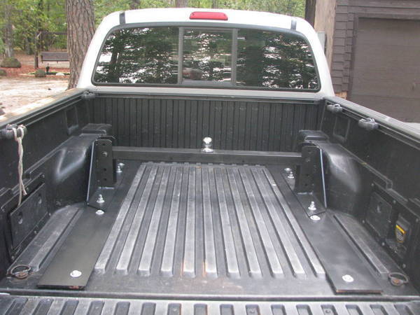

    Most of the materials were scraps from around the shop. The uprights are from 1/4" plate and bolt to the 3/8" x 6" x 60" flatstock which has holes drilled to match up with the stock bed bolts. The cross member is 3" x 3/8" channel with a 2" ball. Washers were used to shim the gap between the flatstock and the composite bed. Brake assist comes from a Prodigy controller.

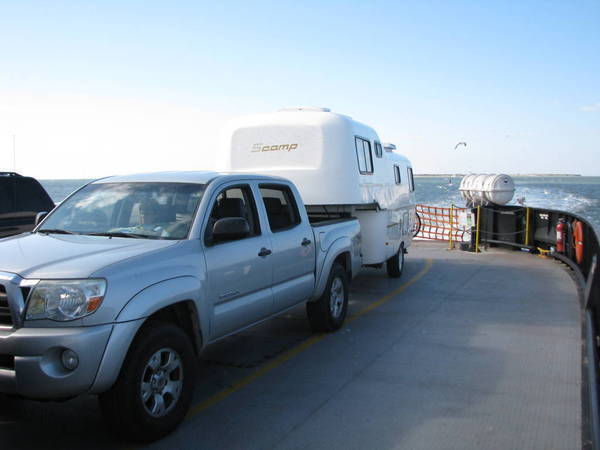

    Hatteras to Ocracoke ferry on the NC Outer Banks
    Weight is well within spec - the Scamp grosses 3200 or so with about 400 lbs on the gooseneck. The Honda EU3000 genset (160 lbs) fits nicely in front of the hitch cross member which is a couple of inches behind the axle to provide sufficient cab to camper clearance in a 90 degree turn but that has not been a problem.

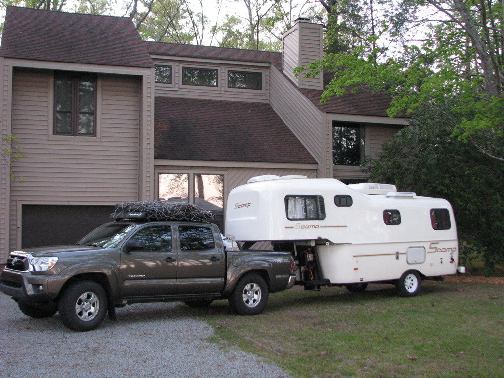

    The 05 which served faithfully for 200K+ was recently replaced with a 2012 Pyrite Mica TRD and it took about 30 minutes to swap the hitch and brake controller.

    You shouldn't need to butcher anything when fabbing the hitch. I built mine to use the six stock bed bolts - no additional holes or mounting points required. I can take it out in less than fifteen minutes and you'd never know it had been there.

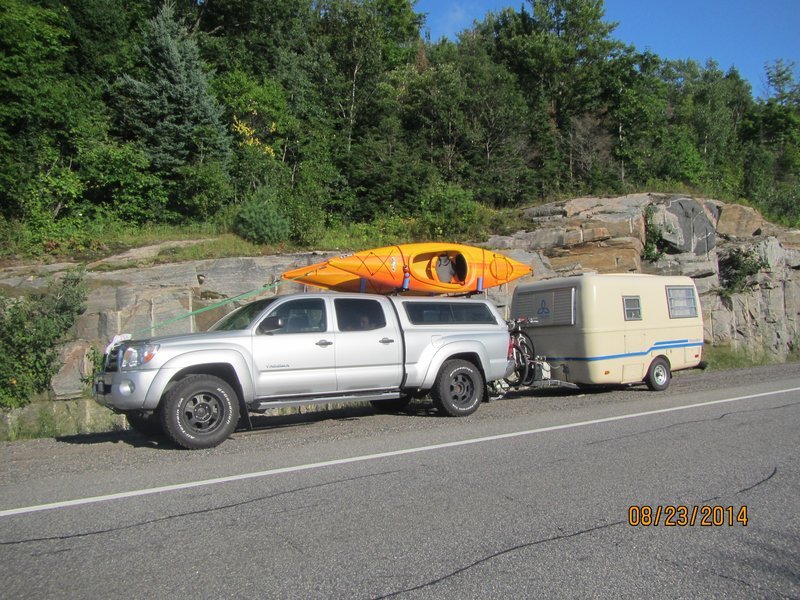

    Let me know what pictures you'd like to see and I'll try to get them posted. The one below was taken last week before a trip to Nantahala National Forest with my college room mate and his wife. As you can see, the Tacoma was way overloaded as I was carrying all the gear for both couples but we made it without incident.

    image.jpg [​IMG][/URL][/IMG] Thanks for the reply. I didn't realize you used the factory bed bolts. Nice. Other posters talked of drilling holes in the bed to attach right to the frame, but now I see how you did yours, this is the path I would take. When I said butcher, I meant cutting holes as once there cut, there's no going back.

    Take a look at how the bed mounting brackets are attached to the frame if you have any concerns about the sturdiness of this solution. I didn't want any additional holes either; the bed gets scuffed enough with just normal hauling.

    Did you have to drill holes in the composite bed for the upside-down bolt heads?

    No holes drilled in the bed. I used carriage bolts to mount the hitch towers and lined them up so the heads would be between the ribs in the composite bed. Let me know if this doesn't make sense or you have further questions..
