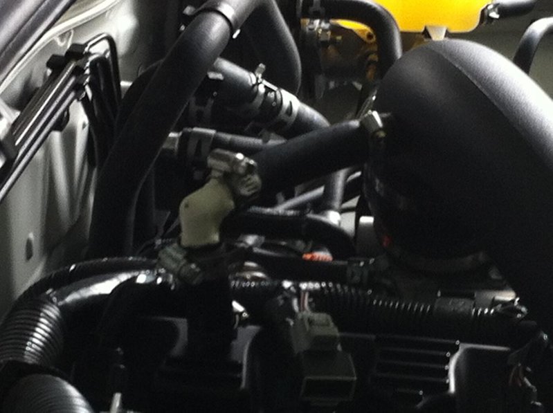

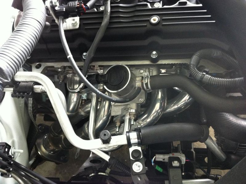

    Here are the pictures finally, of what I was talking about, about the AFE Cold air intake and the Doug Thorley Exhaust headers. We just used the stock stud setup on it. Did loose one nut, replaced with autozone nut.. Didn't see the extra parts for the headers, until it was all done. Oh well.
    In the 3rd picture, I ran to the hardware store for it to work! I think thats the PCV to the air duct?

    ^^Its just a breather for VC/crankcase, not the PCV.
    Cant you just run a single piece of hose?...it doesn't need to be a 90* bend there. I think it would look much better.
    Your engine bay with intake and header looks super nice man!
