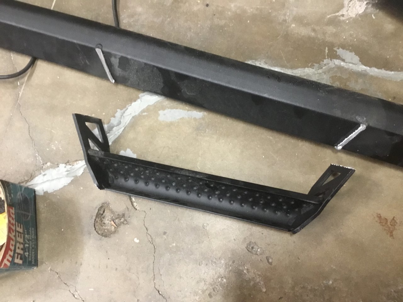

    I didn’t see a thread for this topic so I created one. I modified my Predator running boards by removing the steps so I thought I would share my journey. I only do Overland style off-roading and never use the serrated steps.

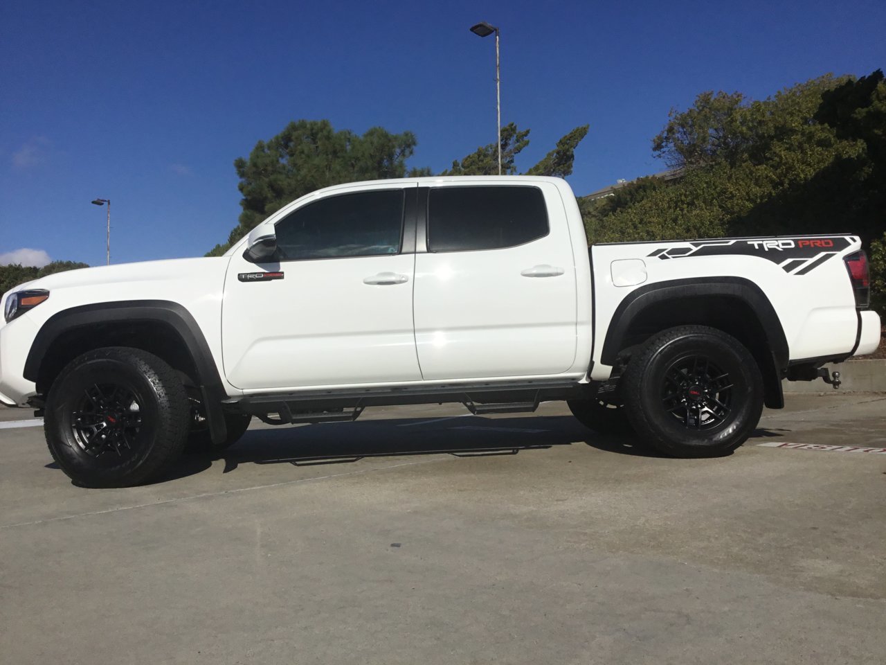

    Here is a before pic

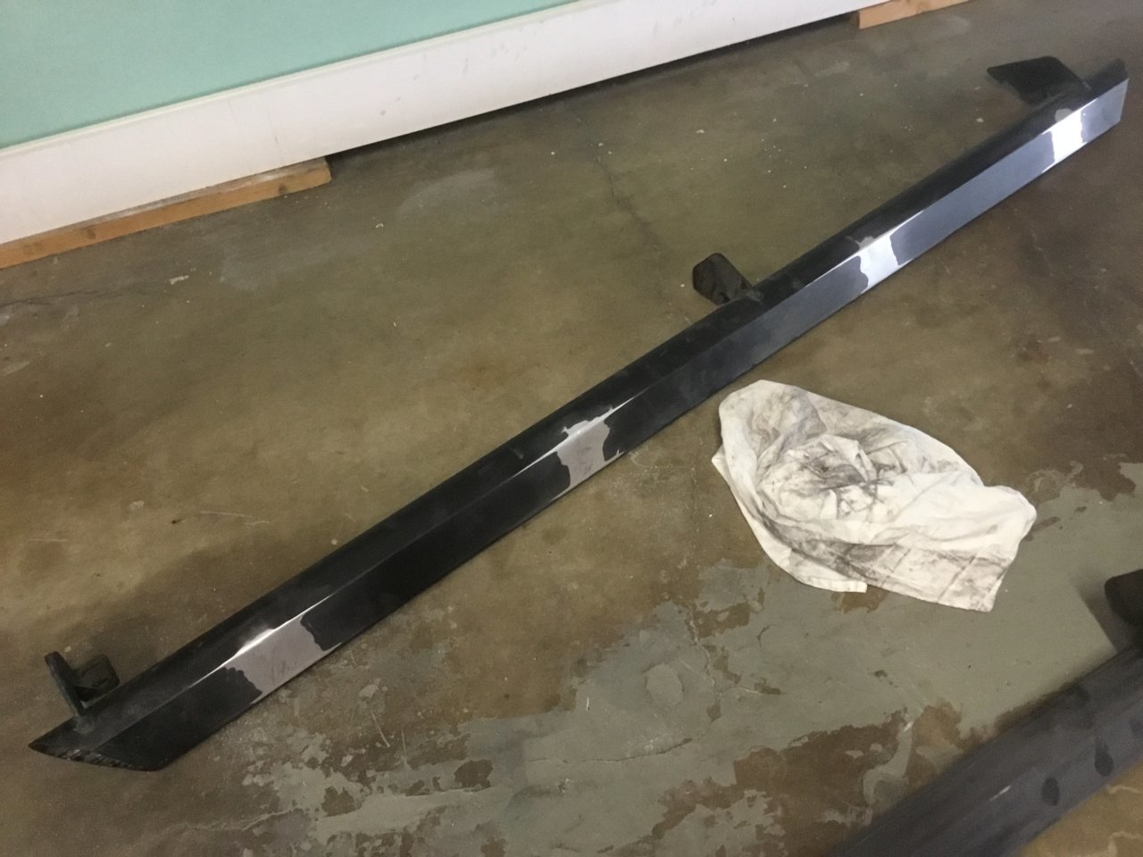

    Took a cutting disc to the steps

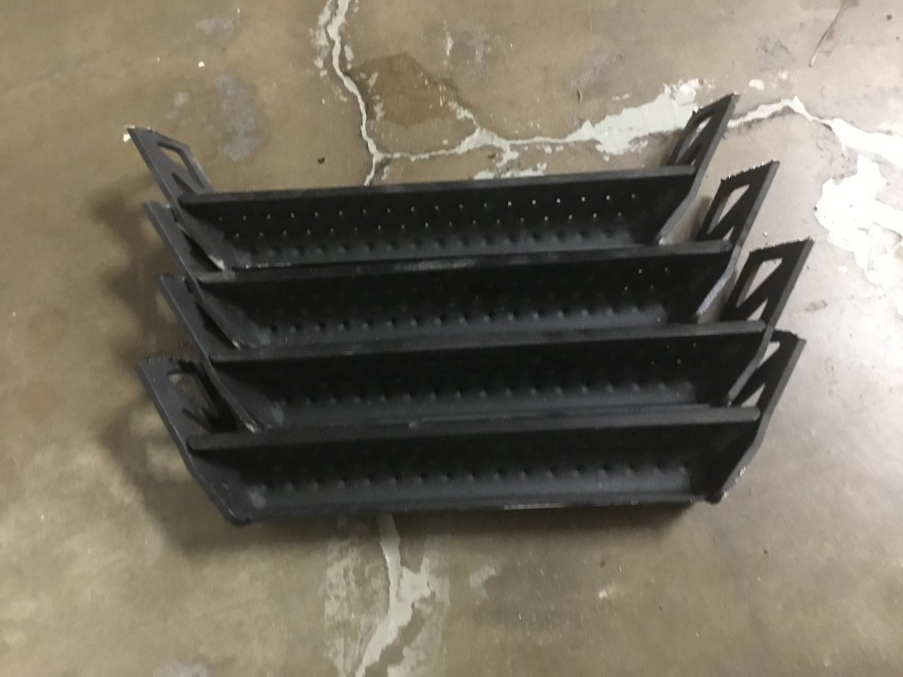

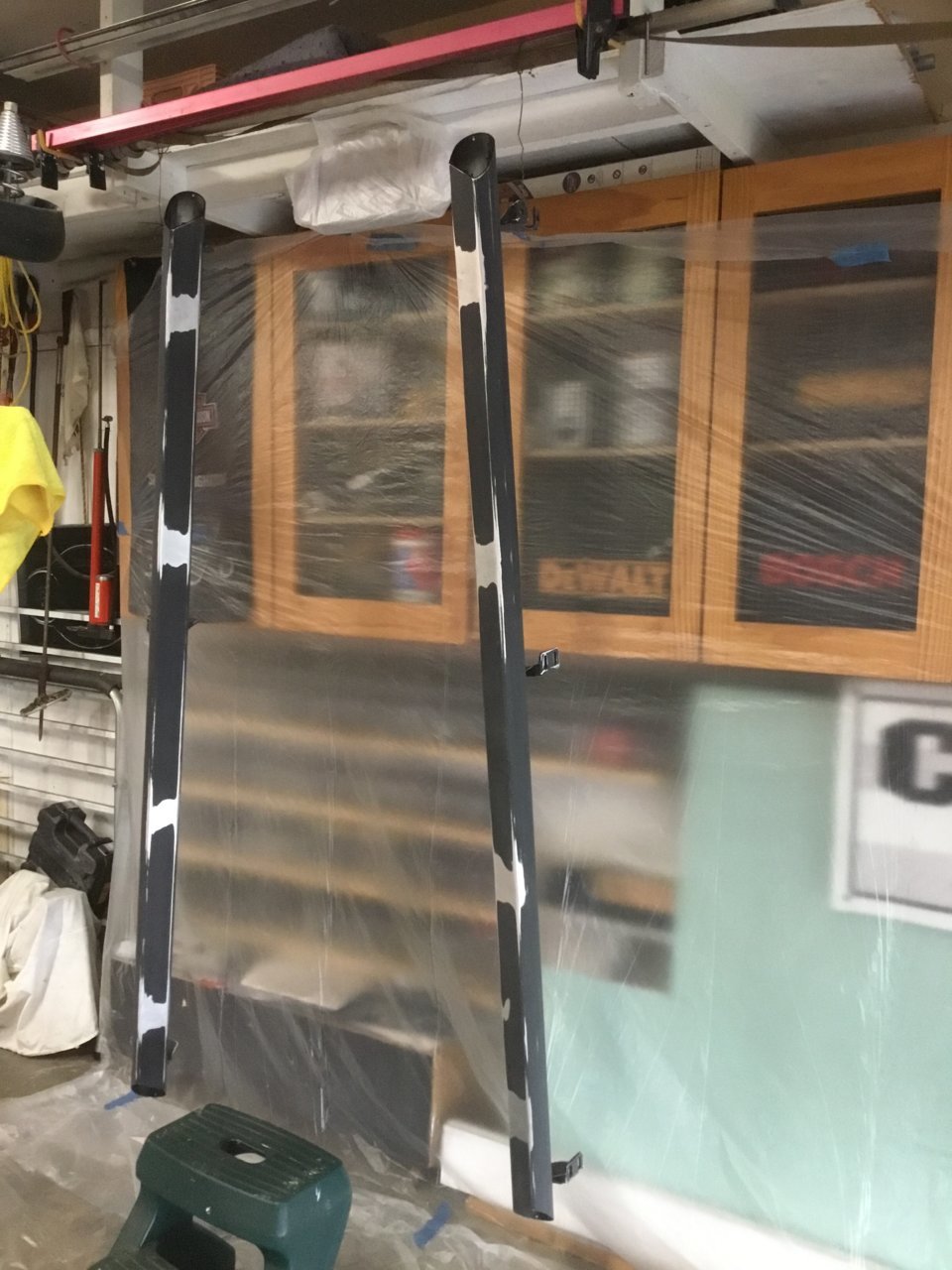

    Then hit the welds with a flap disc and finally a random orbital sander

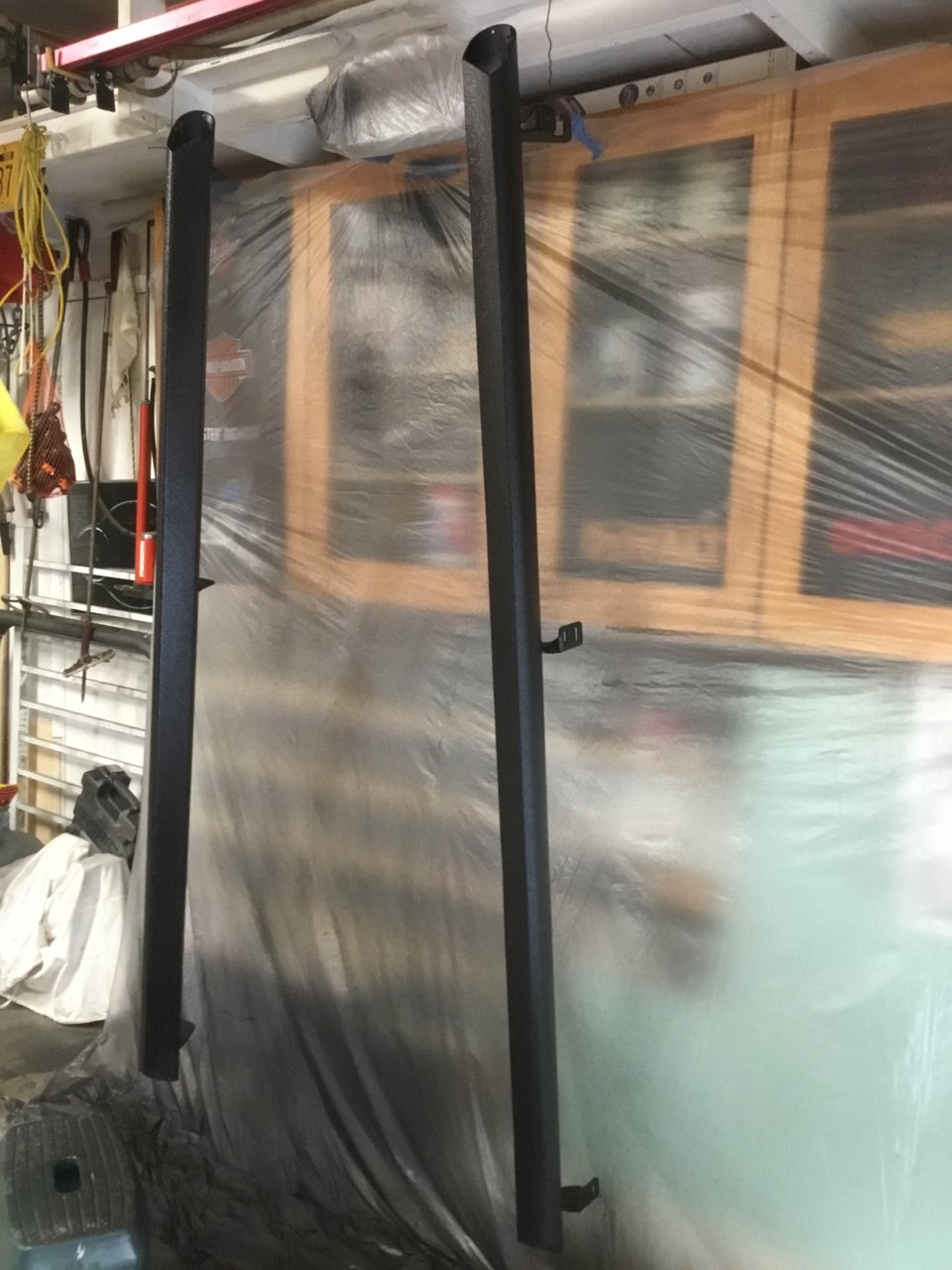

    Then it’s time to hang them for painting and a final cleaning

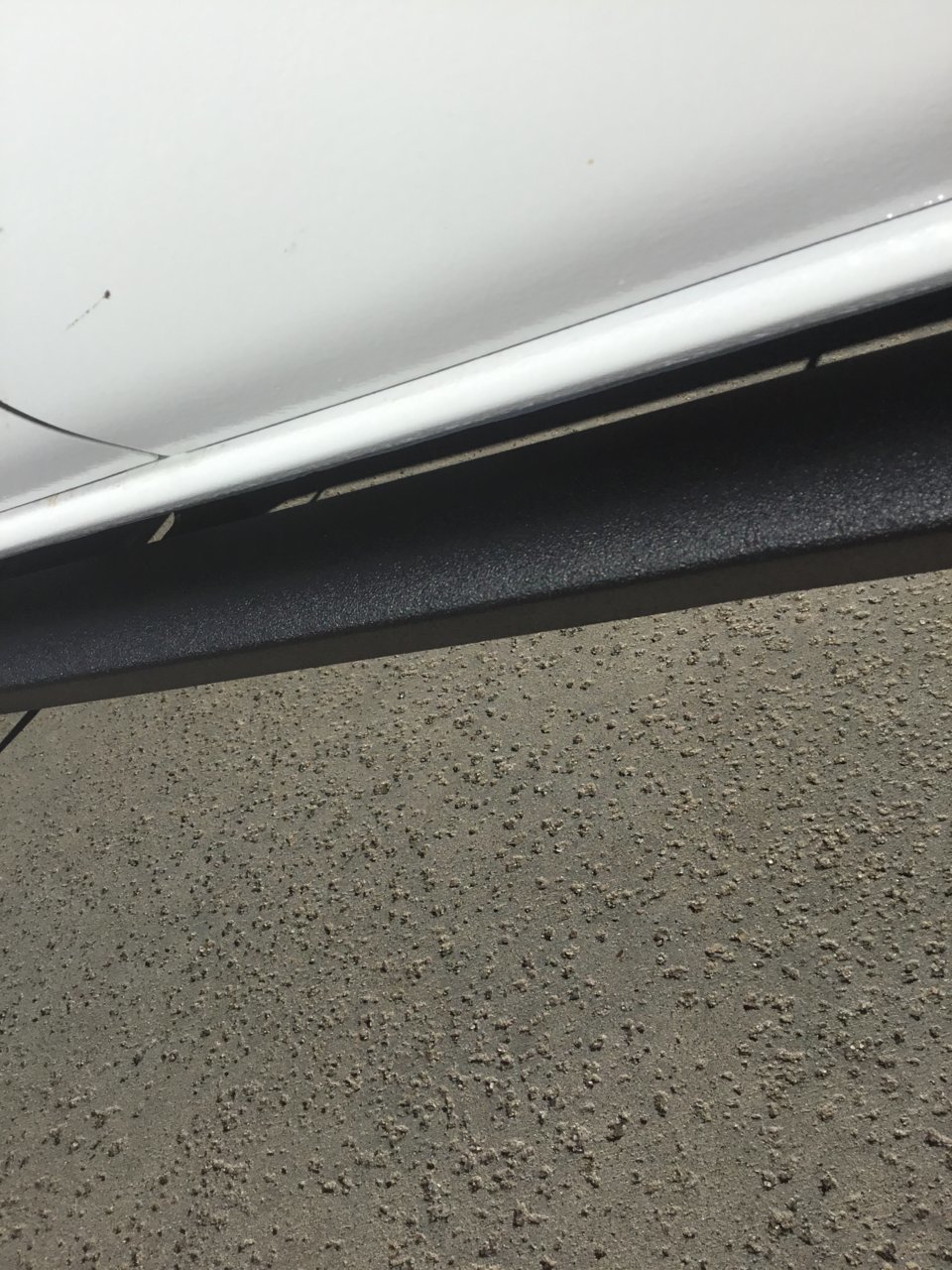

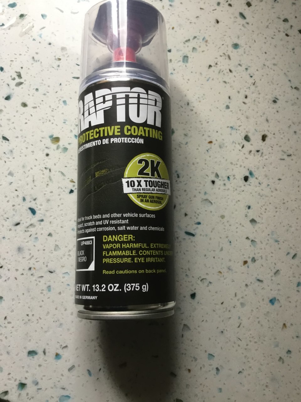

    It’s always the same percentage when painting anything: 95% prep and 5% actually spray painting. I decided to try out Raptor 2K bed liner spray
    It took 4 cans to apply 3 coats

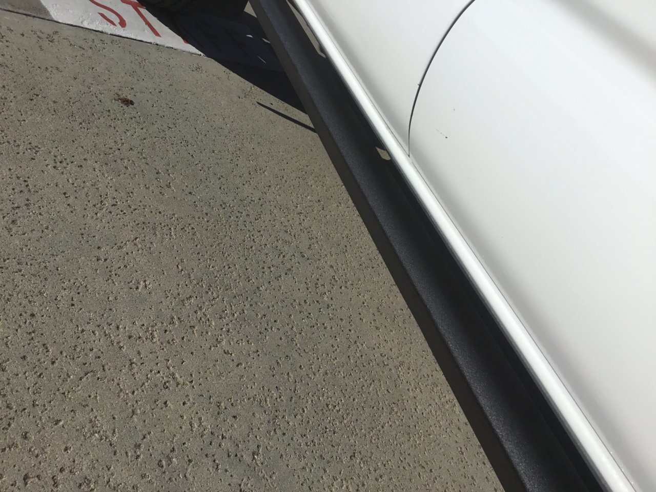

    I let everything dry overnight and reinstalled the Predator steps the next day. The Raptor urethane bed liner spray is very hard and I love the finished texture. It truly is a spray gun finish from an aerosol can. Follow the directions and spray at least 24” away from the surface

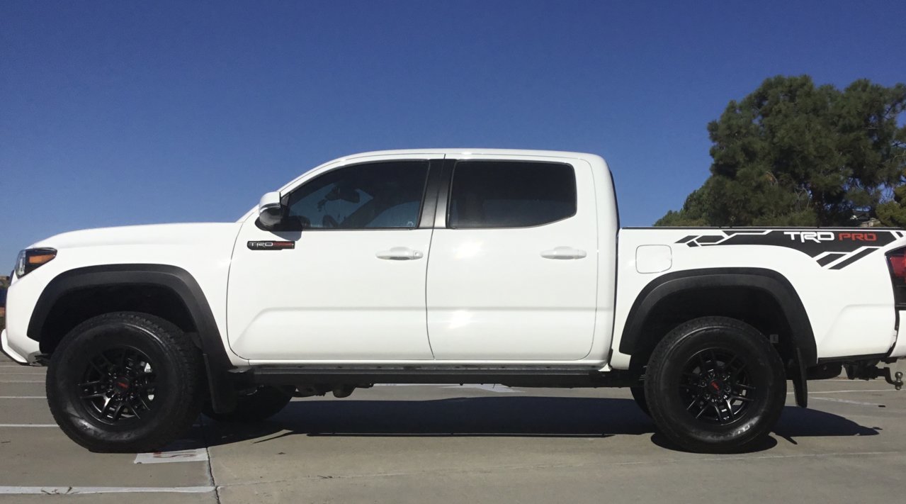

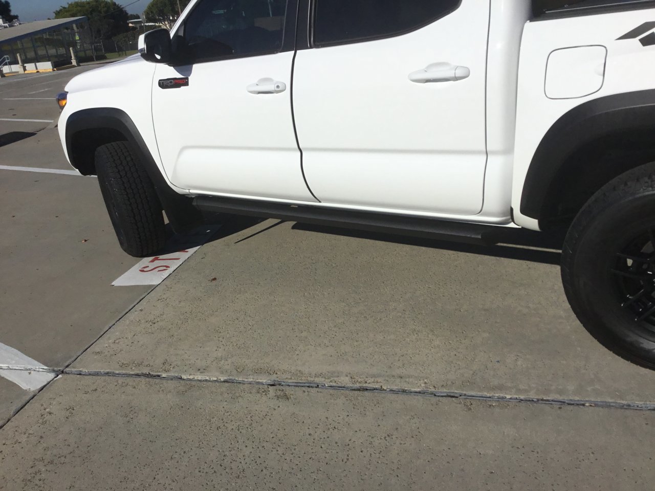

    Another angle

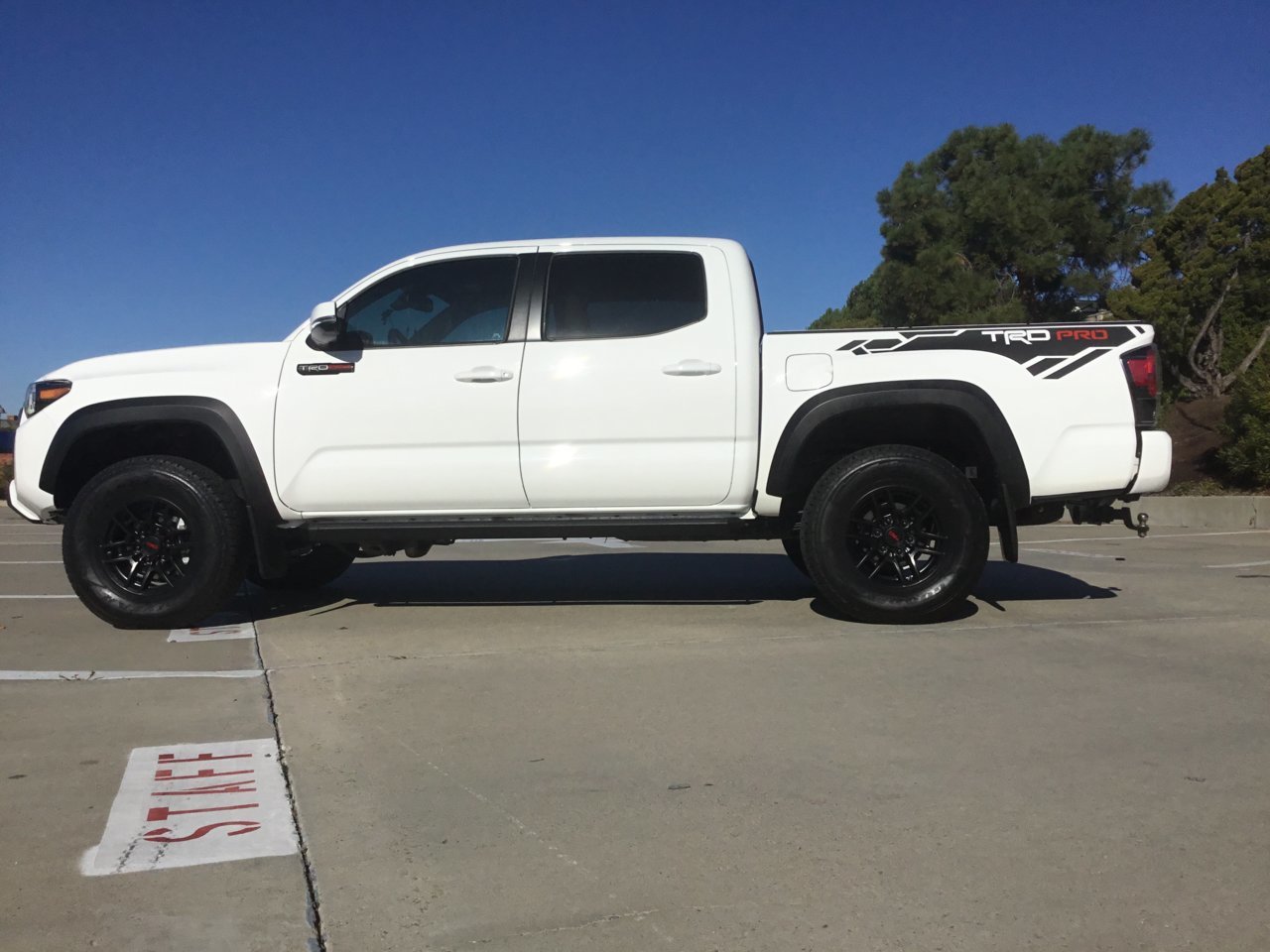

    Project complete!

    So you kind of turned em into sliders? Do they protect the rocker panels?
  6. Dec 27, 2019 at 3:03 PM
    TRDProOne
    TRDProOne [OP] Well-Known Member
    May 2, 2019
    #292100
    1,875
    CA
    2019 TRD Pro in Super White
    They simply bolt to the body, not the frame. They do add some degree of stone protection for the rocker panels. They are 100% aluminum and definitely won’t work as rock sliders.

    The Raptor 2K urethane spray cans are not cheap at just under $20 a can but I feel the spray gun results and great durability are well worth it.
    The cans include a red button in the cap that you use to puncture the bottom side of the can to release the hardener catalyst. The directions call for shaking the can for 2 minutes initially and then another 2 minutes after you puncture the bottom portion of the can. I would have purchased the other Raptor product if I still owned a compressor and spray gun.
