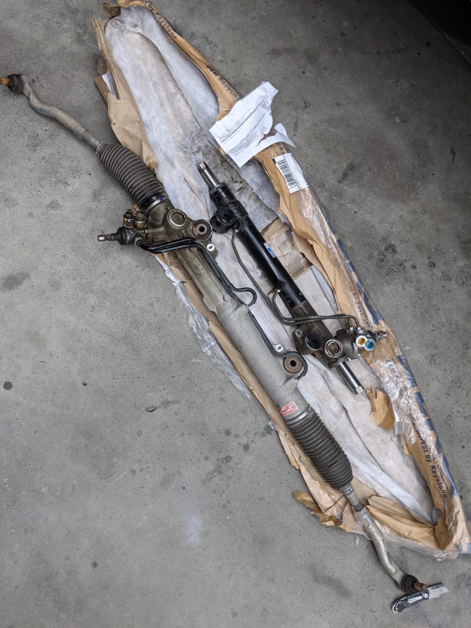

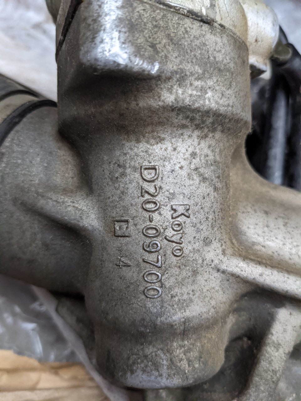

    Can anyone help verify 100% if this is the right rack? I ordered 2 racks online from junk yards and received one today. fuck is it large. Pictures don't do them justice how large they are compared to the Tacoma rack. It looks identical to the photos posted in this thread and on solo. Just trying to be 100% certain the junk yard didn't screw up and I didn't screw up on the order. Rack ordered is supposed to be compatible with a 2013 tundra.
    I'm guessing this is some sort of serial number or QA cert?
    And the Koyo number
    Texoma and Basikbiker[OP] like this.

    Thats the correct one!
