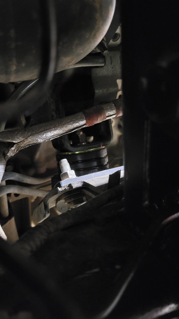

    Was messaging Travis on the insta tonight about possibly picking up a rack since he has a couple right now, and mines a ticking bomb
    So for us 3rd gen guys (2nd gen to if you need the clearance), I put these simple 2nd gen poly mounts in my 3rd gen tonight. Yes, I know solid makes some, but these are another option and they are also super easy to adjust/space up the motor for rack clearance. Bolted right in and hardly added any extra vibes. I gained .25" height from my clapped out stockers

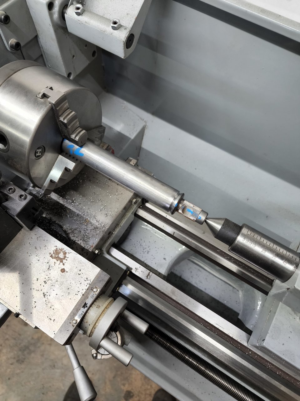

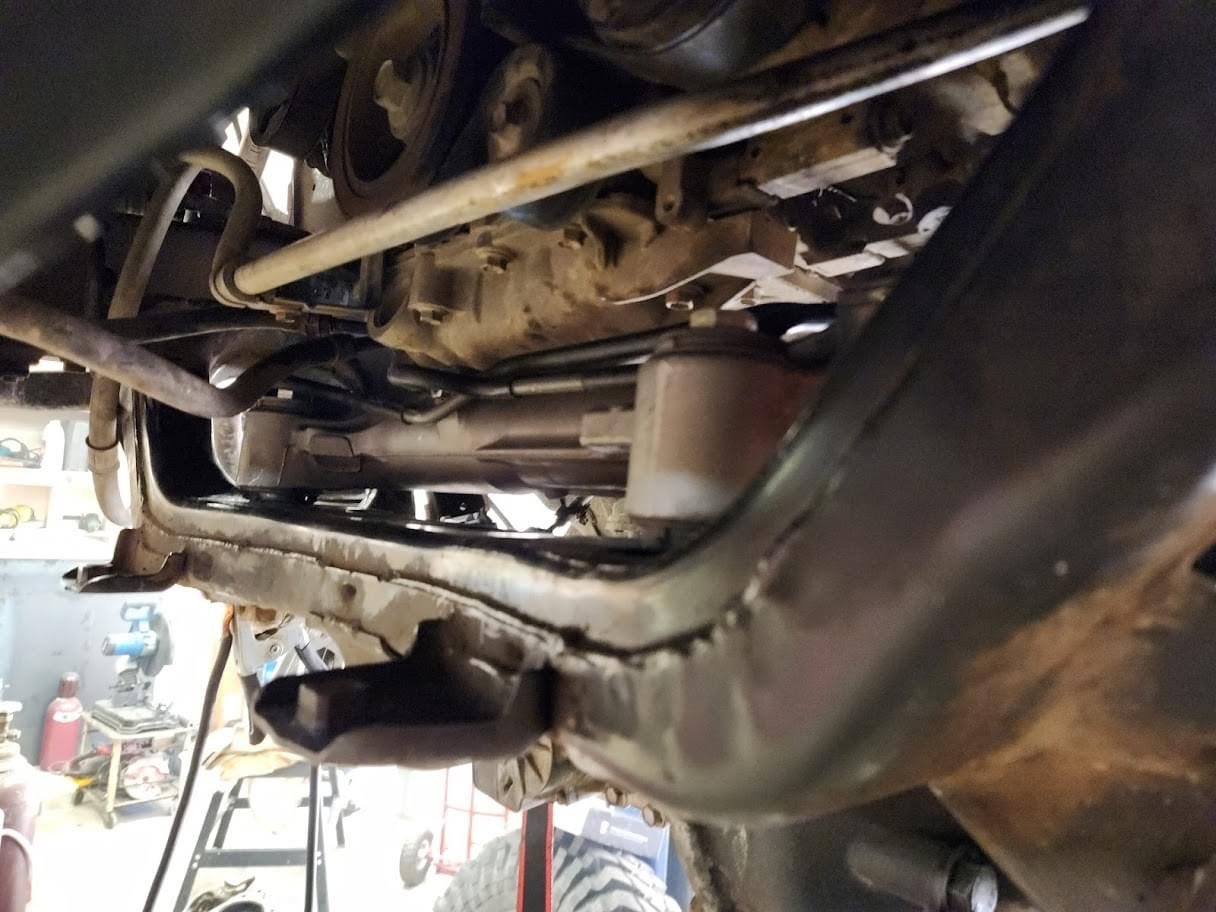

    I've done two now, both on 3rd gens, one even had 934 CVs, and I've never had engine or axle clearance even be close to a problem. The only clearance issue is the steering shaft.
    For that I just cut off the accordion part, leaving the shaft, and then I have tube that slips over that perfectly to sleeve it. I machine the spline bit so it slips into the tube so it's perfectly aligned, then weld it on, then slip the tube over the shaft and weld it on.
    I do find that you have to pull the front diff on the 3rd gen to get the racks in and out though.
    I do have a live center now too, in case you were judging me

    When I did mine on turd gen lifting engine slightly up was much easier vs removing diff, as another option.

    That's an option too, but I find that the amount of room you have to work with the diff out makes it worthwhile anyway. One of them we were rehearing and locking at the same time as well so 2 birds

    Any noticeable vibes on start up? How's driving? Feel much better now that the engine isn't rocking side to side?
  20. Oct 7, 2022 at 8:00 AM
    #320
    EatSleepTacos
    Mar 24, 2015
    #151688
    59,835
    Randy
    West Valley, AZ
    2017 4Runner
    I also had clapped out stock mounts from 2005 and put solidoffroad mounts in. There's a touch more vibes at idle and while accelerating from a stop light but now I don't even notice it. It's really not that bad.
