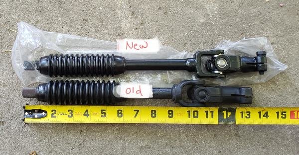

    Well the reason I was asking was I saw this photo floating around and guy said it was from a 2wd but I’m thinking it was a 5lug since the prerunner I’m pretty sure is the same length as the 4wd shaft. Would make sense on a 5lug since the suspension would be a lower ride height. My real question would be would the splines match up? Looks awfully simmilar and @Basikbiker said he cut his down 1/12-2 inches shorter which should be close to this length. Interesting thought for a possibly truly bolt up option.
    old is the 2wd version (5lug)? And top is for 4wd/prerunner.

    Yes the pic was on a review so i cant ask any questions but guy with 2wd said that it was too long so that why im thinking it was a 5 lug. He didn't say anything about it not lining up.

    I mean typically you do have to shorten the shaft an inch....I'd venture to bet the splines are the same too

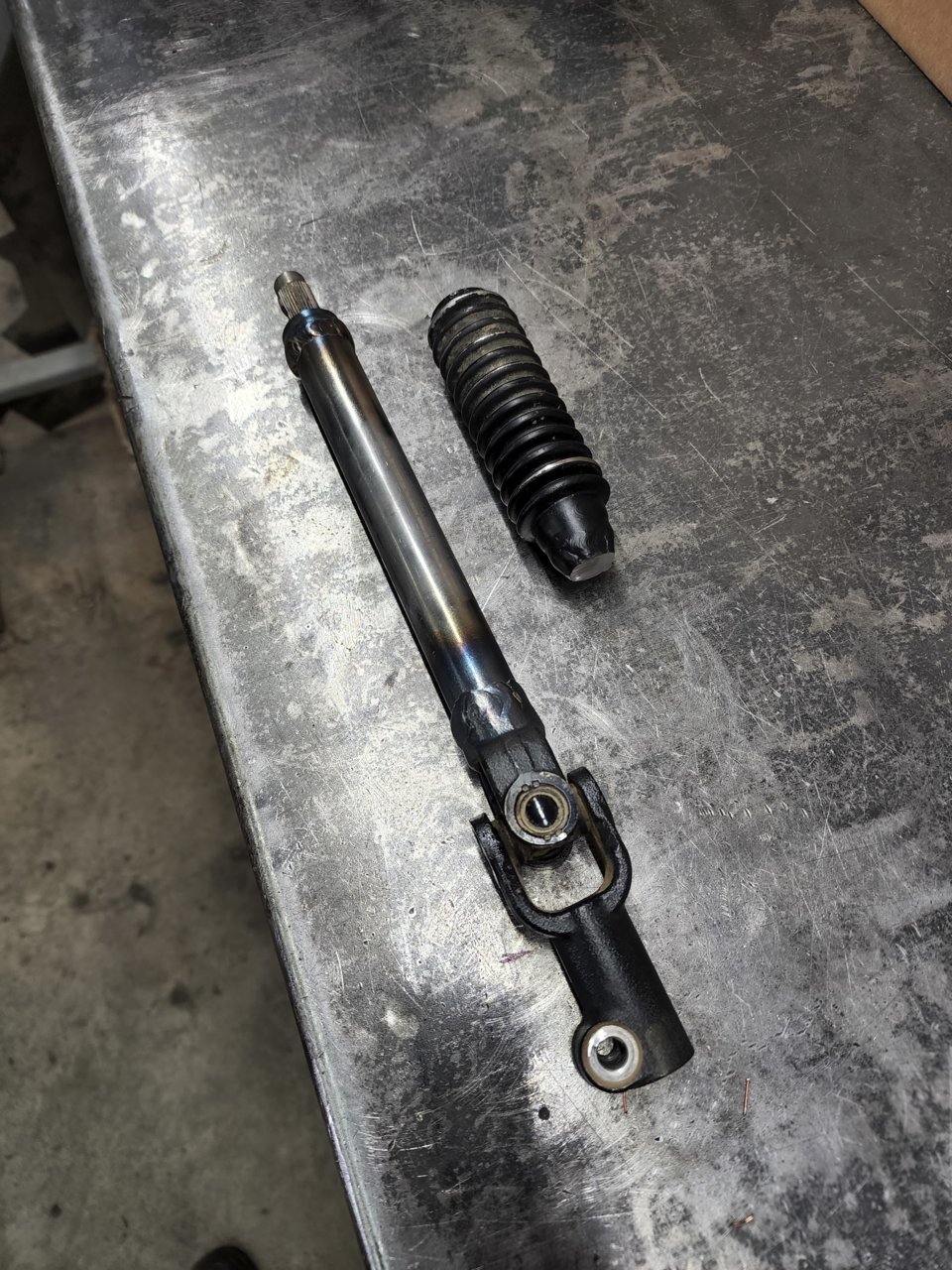

    The biggest problem is clearance to the frame where the collapsible part is

    Every step you eliminate makes it easier though. I wouldn’t mind cutting down my shaft and welding but I just like to see if that would work. Clearancing the shaft ain’t a big deal for me.

    Yeah I'd be stoked if it worked, that's just the one thing I can think of that might be an obstacle

    Found a pic of a completed one we did. If there's an easier way, that would be dope, but the clearance is very tight

    Well, just ordered the smaller intermediate shaft for my install. In case no one has tried it yet, I'm hoping to get a decent video of the install while trying my best to communicate all the work that goes into these things. Very much appreciate the hard work, ideas, and write ups here in this thread and the other one in the 2nd Gen section. It's always nice to see a bunch of people coming together to solve problems.
    I did a decent search for shaft lengths in several different Toyota/Lexus platforms. Sadly, not many sites share the actual lengths.
    This is the intermediate shaft I ordered, it's pictured above. Lets hope it works, I don't have the skills to shorten one on my own.
    https://www.amazon.com/gp/product/B07BMJP6W5?ie=UTF8
