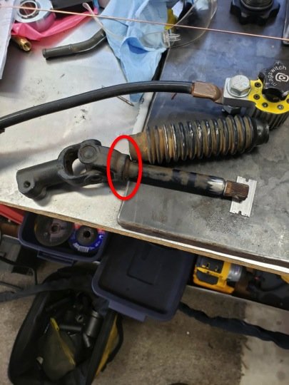

    Nice setup. Wondering if a better location to shorten the shaft would be at the knuckle instead of cutting the spline and rewelding. It would be stronger to cut at the other end, clean up and push the shaft back into the knuckle and then weld as the factory did. Or is there an issue with that technique?cutspline.jpg

    If you read the post that's what I ended up doing...just didn't take a picture of it

    Went back and reread your post. Makes sense now, just wanted to clarify and ensure cutting near the spline and rewelding wasn't the prefered method.

    It does work tho lol

    Looks like you already found it :thumbsup:

    I was able to fit mine without cutting the shaft, although it's tight as a bitch to get the steering shaft in
